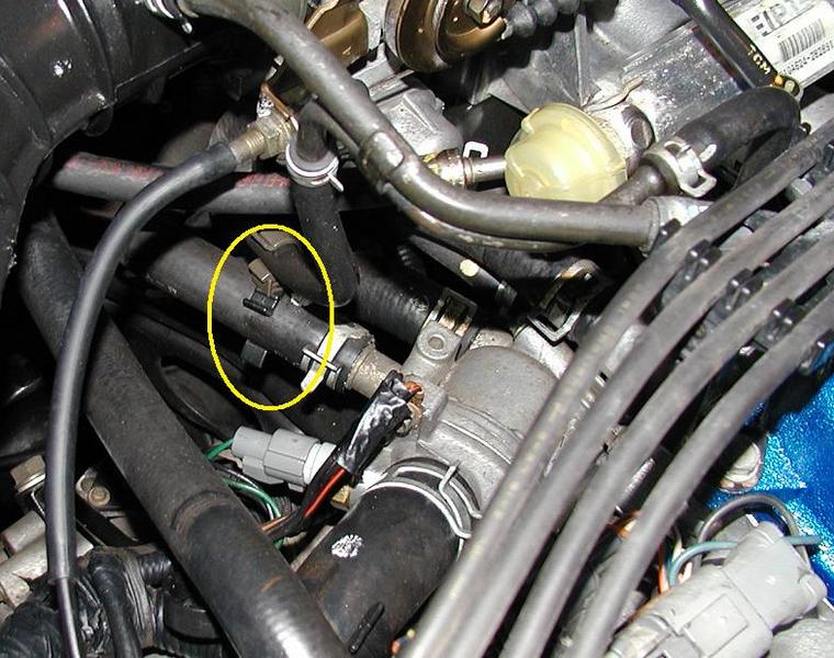

You need to make sure what it is first. The pics below are from a 94 DX D15B7.
The hose in the first pic which comes from the intake goes right back to the water outlet below it. Both circled in yellow.
The hose in the second pic goes to the heater core. It looks like yours based on the clip.
So to me, it looks like the hose in your second pic is to the heater core and connects to the intake manifold. Not sure if they rerouted the hoses in 05 or if yours is a 1.6.
