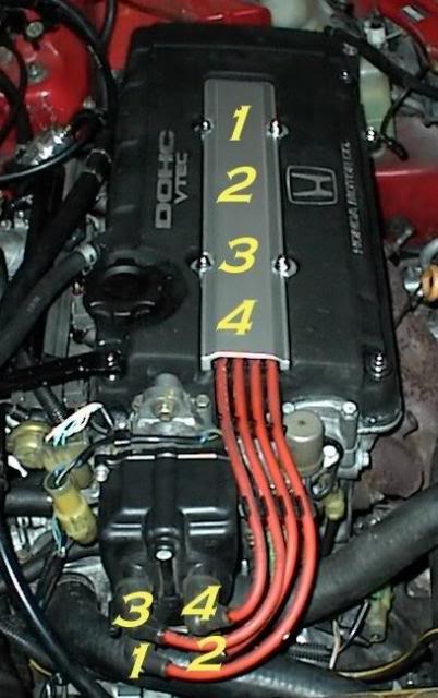

I still say firing order. 1-3-4-2, No.1 is at 7:30 position. Just my .02

You nailed it.... after searching the net again i found a good pic that was a little better than what i had found I had 2 and 4 reversed... thanks

hehe ya pretty stupid on my part i know better. Instead of working clockwise on the dist i was working left to right. so no mater how many times i read the firing order it seamed right to me. But i guess this is why we have fourms like this. eventually someone will say the same thing enough times to make you look at it again and get it through the thick head that they screwed up..haha

If you needed the firing order you should have asked me man lol. I have posted this picture on here a couple of times.
