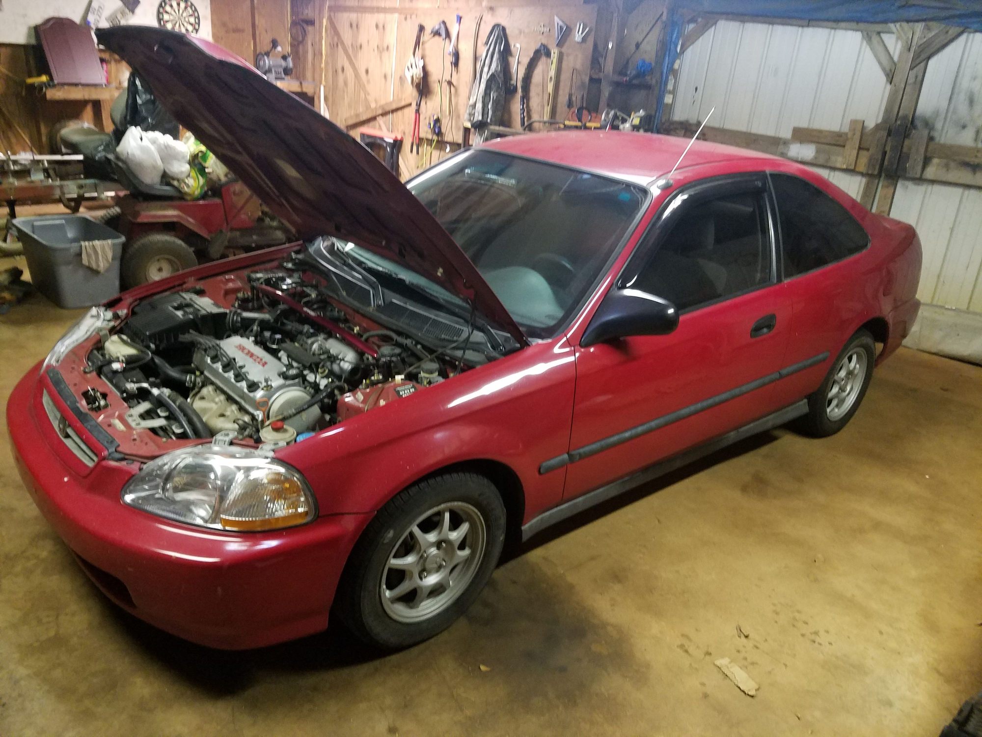

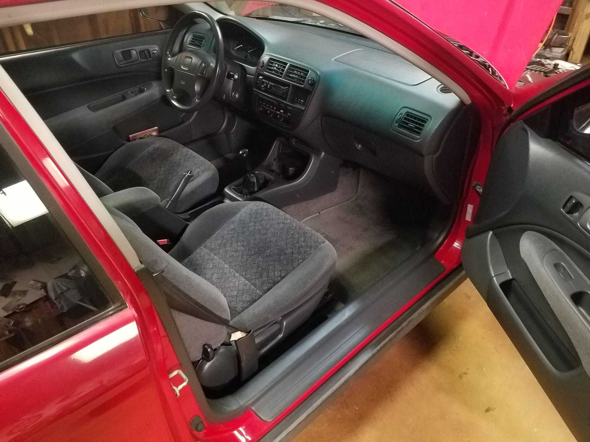

Always wanted one for a daily, this popped up in ATL for $2500, How do you think I did? It's an HX model with a 5 speed and despite the mileage on the odometer everything works, it shifts great and other than the fuel gauge dropping more than I expected it too on the way home from ATL (120mile trip) everything seems good to go, pulled it into my shop to look over more closely tomorrow but I took a flashlight with me and didn't spot any leaks anywhere or anything.
Did I get ripped off or is this a decent deal?
BTW what size is the fuel tank on these things?
P.S. Only thing I have found "wrong" with it is the gauge lights, the right side is out, and well I suspect if their's more than 1 dome light 1 is out because it's pretty dim. No idea what the white wire on the drivers side of the engine bay goes to but it has a female spade connector on it, and goes back through a grommet in the firewall, I'm thinking maybe it had something to do with an aftermarket alarm or the Sony head unit??? I'll have to trace it tomorrow and see what it goes too.

Does it have 325,000 miles on the odometer? Original engine?
If that's the case I would say prospect of decent deal depends if the engine holds up for a couple years.
Otherwise..nice looking car. Remove everything from the trunk including the spare tire and inspect for rust/holes..these cars are susceptible to leak around through the rain channels and sometimes under rear glass. Can climb in the trunk and use a flashlight to inspect while a friend lightly hoses the rear glass down with water.

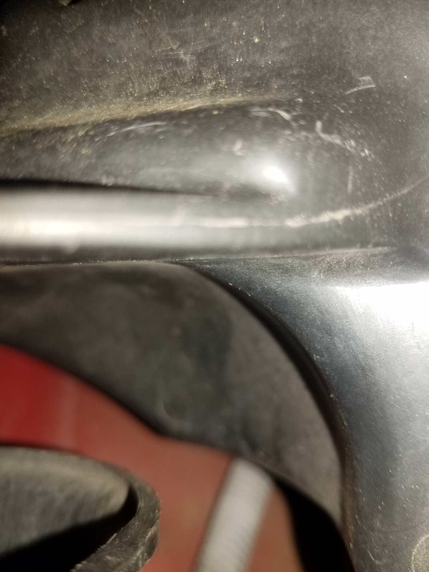

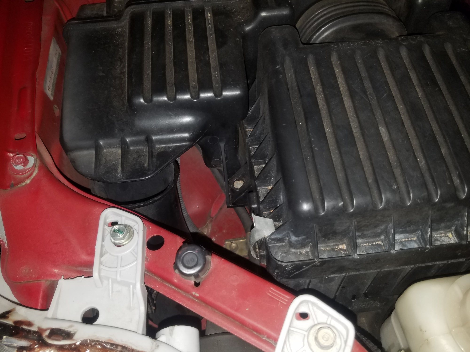

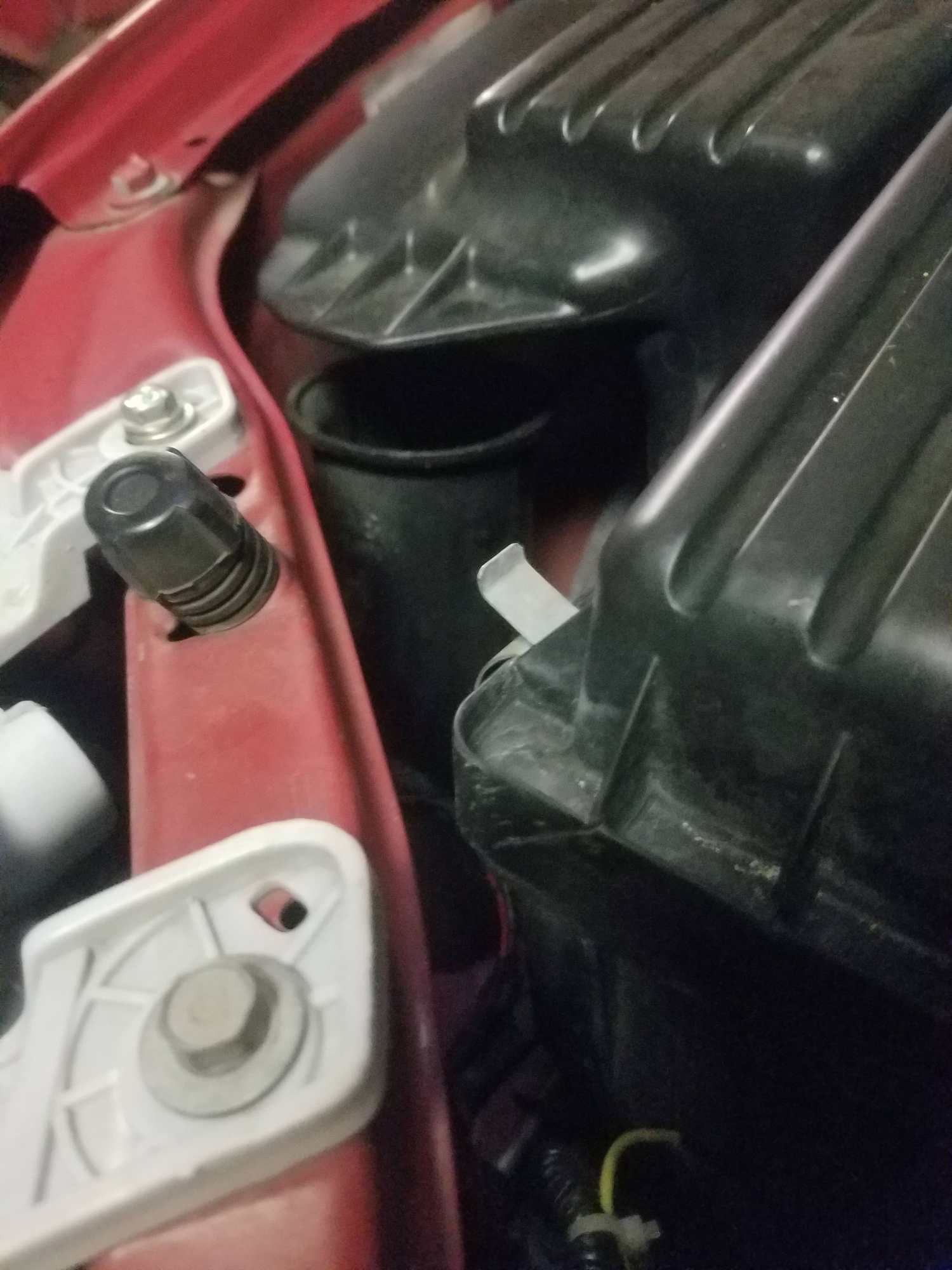

Thanks Megalodong I'll keep an eye on the coolant. What's with the odd snorkel like tube going to but not connected to the air box? I'll post a picture in a moment, doesn't look like it can even attach?
See goes to nothing... WTH? (that's the underside of the piece above the pipe/snorkel

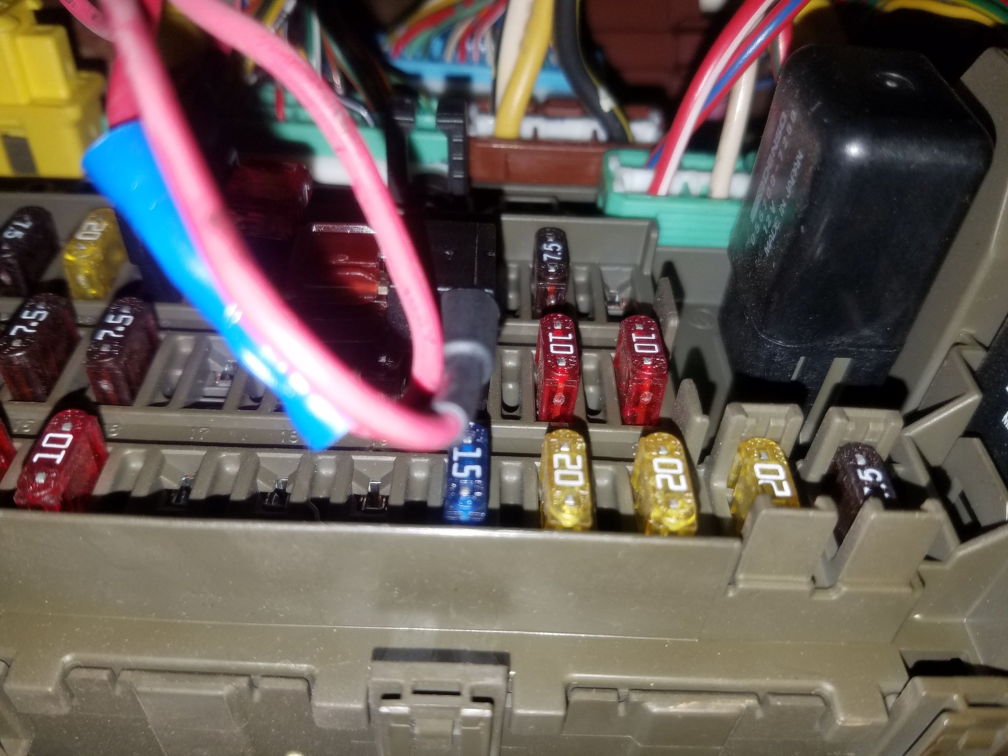

Also WTH IS THIS BULL ****! IT MUST GO! *grabs wire cutters and needle nose pliers*
There were 3 of those in there, hell one jumped from one port to another port, literally a jumper wire but with both ends fused? And then the wire under the hood I mentioned earlier that went to nothing was plugged in there too, I pulled that as well, wish I had snapped the pic of the port it was plugged into prior I had planned to take the main fuses out of these jumpers and put them back into those ports but in my haste lost track...w00ps... well like I said I haven't noticed anything not working yet... any idea how to find out what ports go to what without the cover?
(hope I didn't need that, cause it's laying in the shop floor now....I started the car and checked the blinkers, radio etc. *shrug* everything still seems to work. There's no cover to know what the hell each fuse is for or what those ports went too, Any references around here?

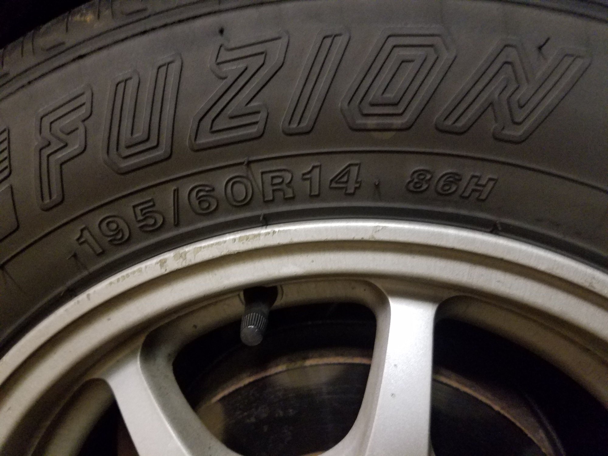

Also are these the right wheels/tires? Seems the speedometer reads a bit faster than the car's actually going.

First section of air intake.
Don't be tempted to add a cold air or short ram intake..won't add power or mileage.

I don't know but it's not stock. Did the seller mention anything about a cut-off/kill switch (anti-theft)? Did you notice if the radiator fan was running constantly before you removed that wiring.

Stock is 185/65/14

No the seller didn't say anything about a cutout switch or anything.
Good to hear the tires are a shorter sidewall than stock, explains the speedometer being a little off.

Well found out by removing those jumper wires I had no more interior fan, started plugging in 7.5amp fuses around the areas of the 3 I pulled until it came back. That's the only thing I could find that wasn't working...though I didn't try the A/C since it's was below freezing this morning though I suppose I could listen for the compressor clicking on, I'd be surprised for there to be a fuse in that block for it anyway unless it was just for the switch? Anyway, found a bad brake like and replaced that. Also looked around the weather stripping around the truck and noticed a spot of paint that had faded to where you saw the primer under it (or the factory never got it there) anyway very light rust there, rubbed with some denatured alcohol and grabbed some red spray paint I had mixed to match the Talons so it's actually automotive spray paint, tapped everything off and sprayed that, color is more of a very red orange than this Honda's red but that 1 little spot recessed in the corner doesn't show much and actually sticks out less now compared to the grey primer showing before. Saw no other signs of rust though I didn't pull the whole liner or anything but looking around all the edges and back up under the trunk area around the speakers and what not I didn't see any signs of anything.
I did annoyingly find this huge bundle of wires for accessories and subwoffers etc. from the head unit that came out from the center console next to the drivers seat which was wrapped into a big coiil under the drivers seat. Considering pulling out the center console and tracing it all back, cutting and capping all the unused wiring. Found nothing else wrong yet. Cold start this morning, no smoke or anything idles quite. Window regulators are meh, you can tell they're struggling so those may get replaced this summer just because. Otherwise just did a little much needed cleaning of the windows. Later when it warms up I may go tinker with it some more and see how involving it is to try to loosen a fender and move it around to see if I can get it to line up with the hood better. Also bought a Hayness repair manual that covers the car...

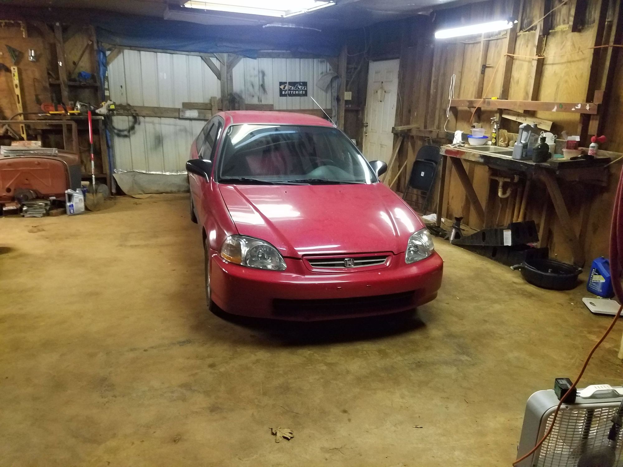

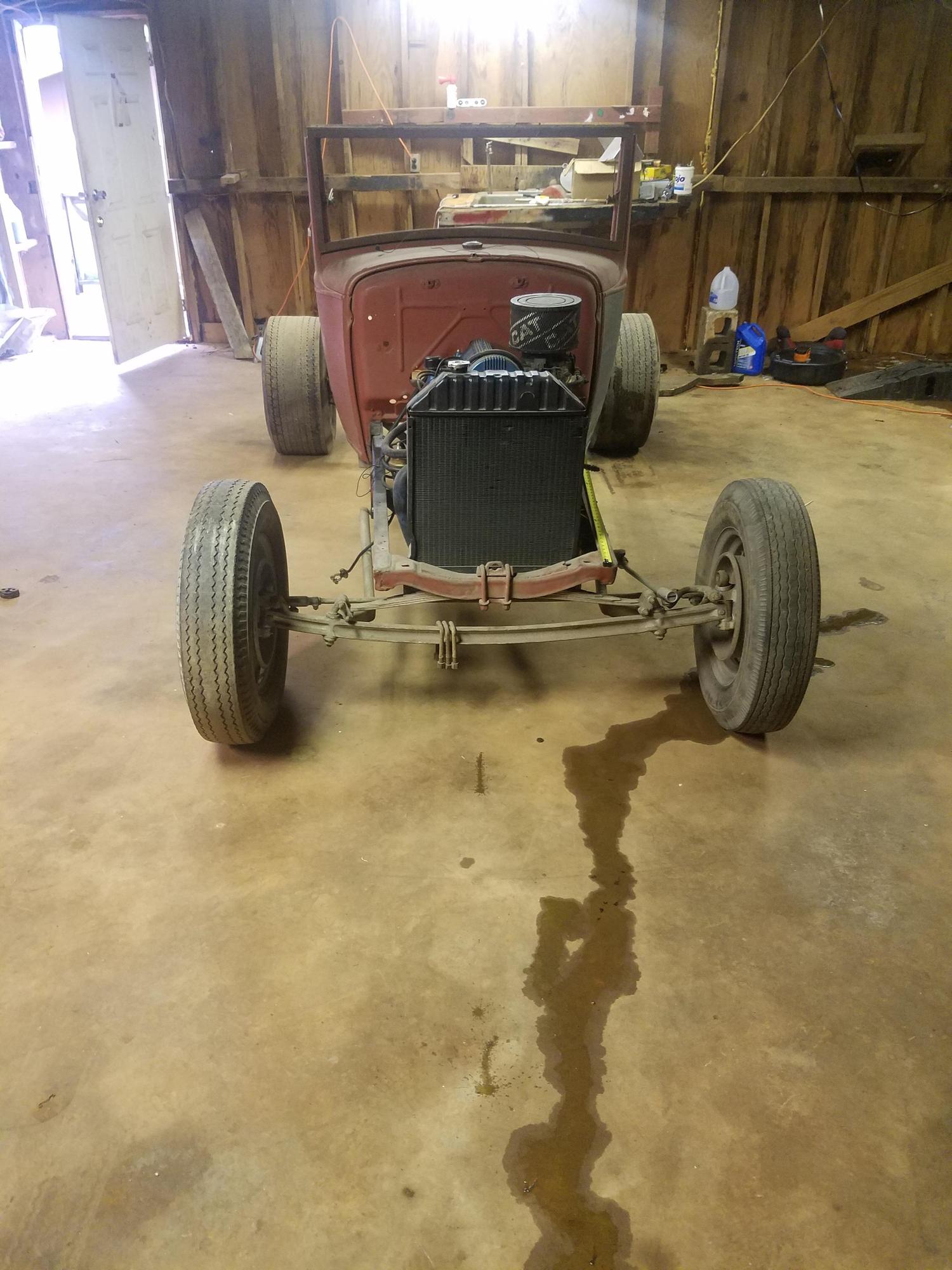

^What's the firewall and windshield frame to the left of the garage door?
^resonator chamber and its inlet tube or snorkel. Yes it's part of the stock intake breather system. The other huge chamber behind the filter box is a muffler.
See if it's in the owners manual.
Or google (your year civic or 6th gen civic) fusebox diagram and see what comes up
{read further}
You may want to get some good wiring diagrams to put the car back to stock.....or figure out why someone hacked it to make it work they way they did.
Tire circumference will be damn close to original. Use an online tire size calculator to figure the general differences and % of expected speedo error. Original tire size is on a sticker in the drivers door jamb.
The speedometer can't be factory calibrated to read slower than actual speed, but can read faster than actual. (some % error in that direction is legally acceptable, I forget the actual number now)

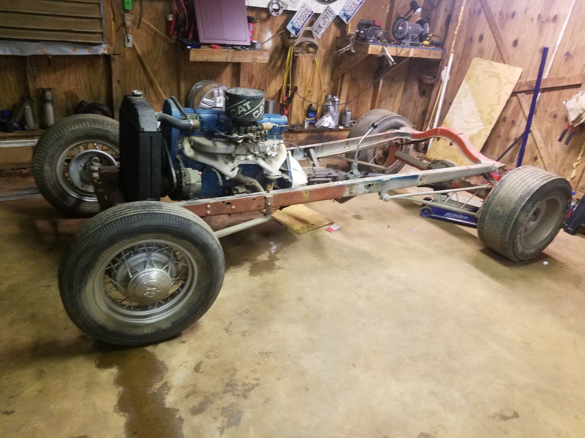

It's a "Cowel" for a 1930 A model, it's off the frame, the frame and drivetrain are off to the left out of view, on it sits a 1966 PMD straight 6 from a 1966 Le Mans Sprint 6. (PMD = Pontiac Motor Division) It was the first mass produced OHC engine, and American made, designed by John DeLorean while he worked for GM. (Yes, that DeLorean) They're fairly rare engines now days.
That's a project I got from my father, he's in his 70's now and doesn't have time for both it and the 53 Chevrolet pickup he's building so he asked if I wanted it....duh. One day when the kids are older and moved out of the house I'll build it. Plan is to tear down the engine (there's nothing wrong with it buuuut) and have some custom rods and pistons made for it, drop the compression as it's 10.5:1 (best I recall) to like 8.5:1 obviously much stronger rods and fabricate a blow through carbed turbo setup for it. then build the rest of body. NA and bone stock the engine makes a little over 200hp and 200 ft/torque. Want to see what the 3.8L straight six does with some boost.
Sweeeet
I'm old enough to recognize all of these lol

Also noticed the air dam/guide/duct/sheild piece under the bumper is split and torn up somewhat, but looks like it's mostly all still there so I'll see what I can do to patch that up. But other than these small few things it seems solid so I'm fairly happy. It's actually sorta fun despite not having much power, just drives so smooth and solid.

Nice garage to =D.

Nice garage to =D.
Thanks
