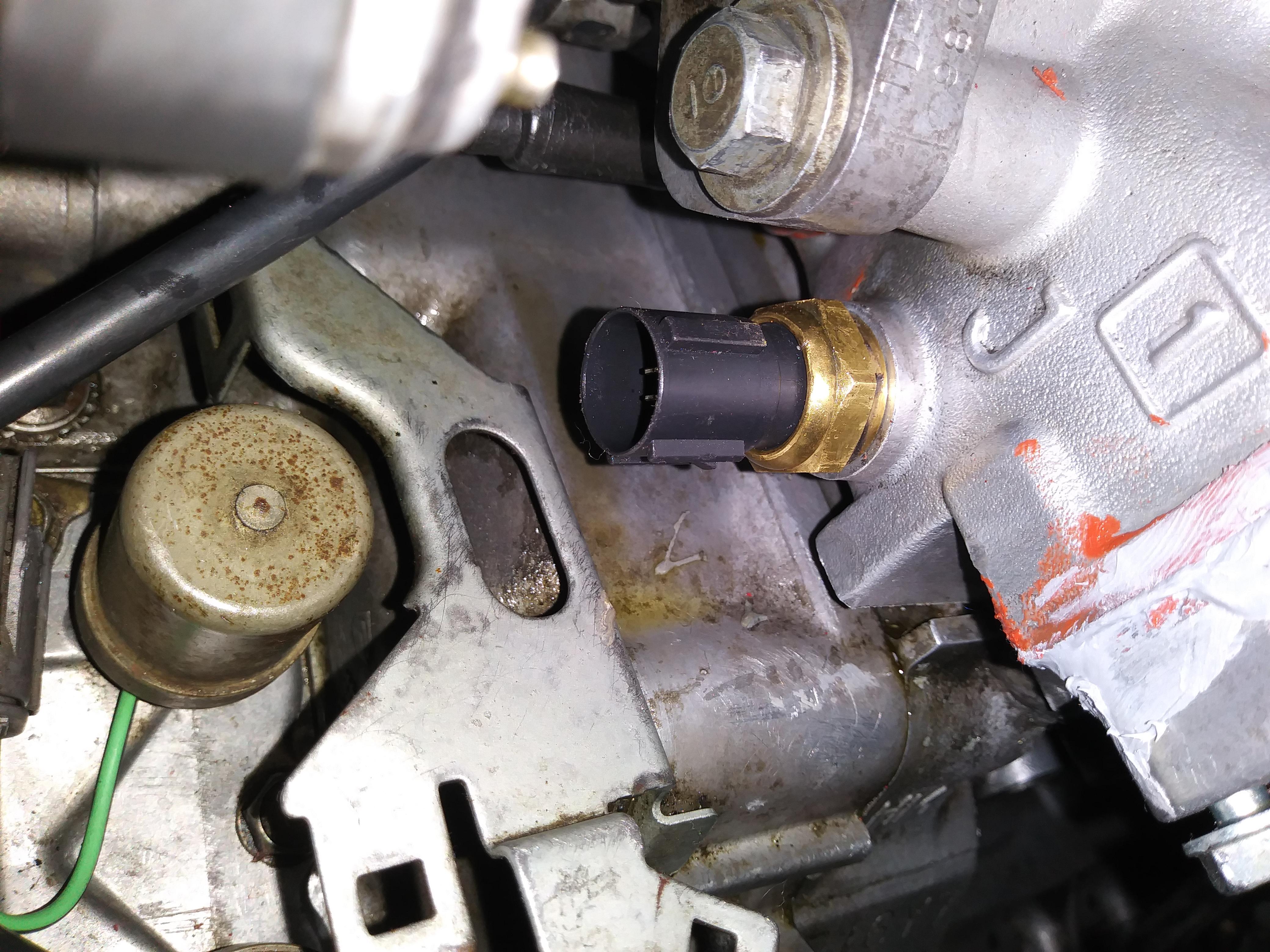

Also noticed a SMALL coolant leak coming from ECT plug its actually coming through the plug itself - my fault - amazon special. What scares me is the small oil coming from the corner of the block/head on passenger side of engine so while valve cover was off I checked head bolts which were unusually loose..Torqued in order again to spec which slowed possibly stopped leaked..

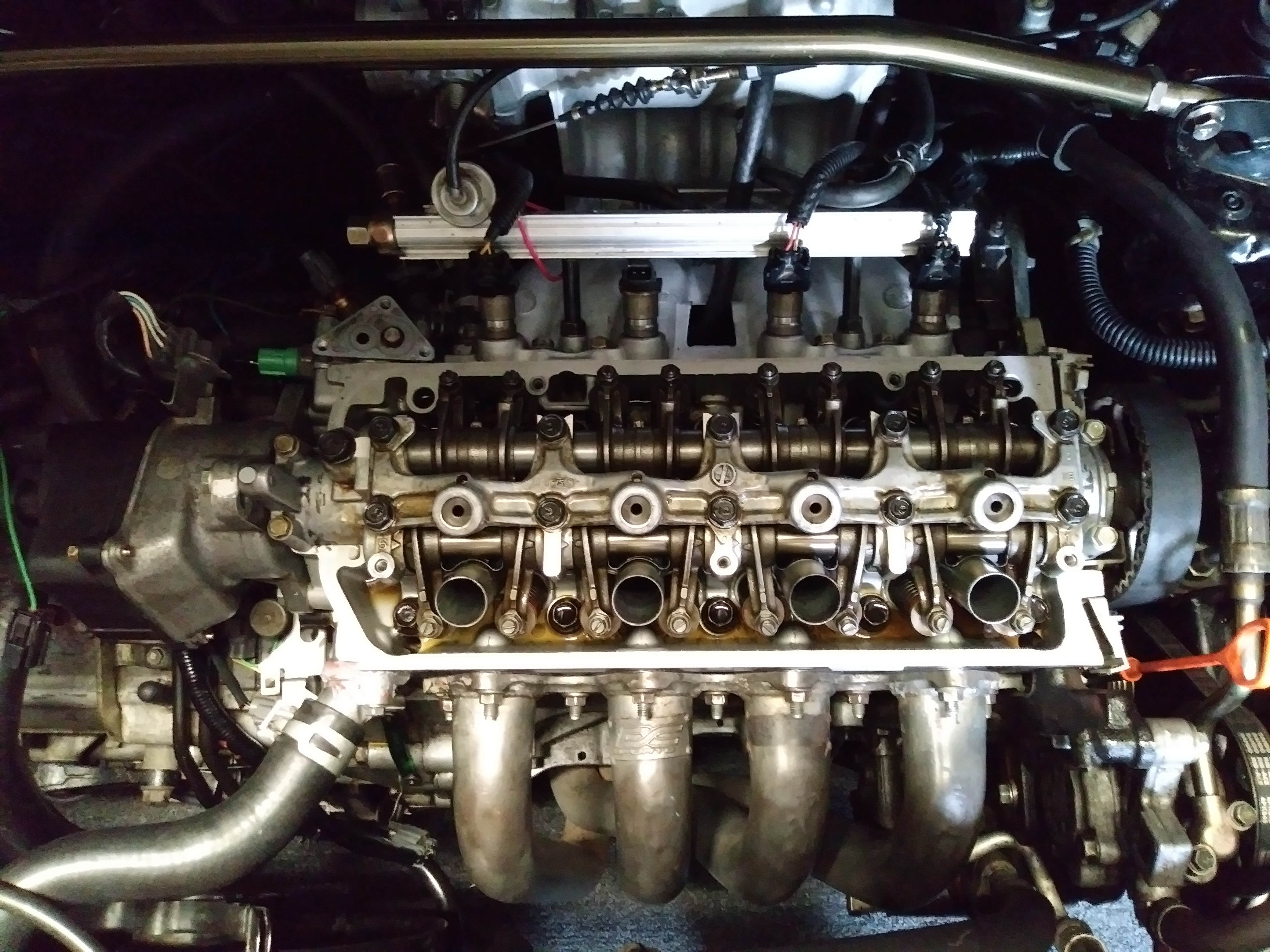

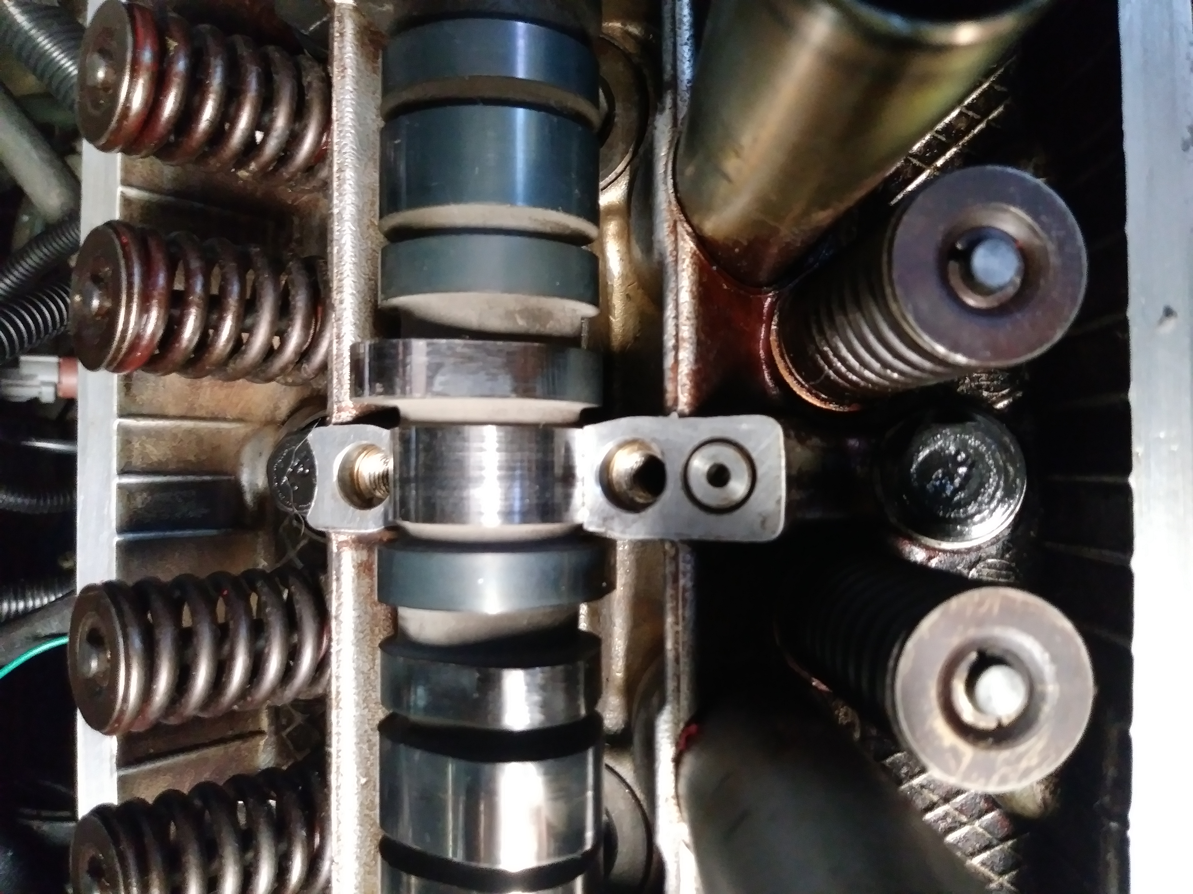

Old May 26, 2017
2kej6's Avatar
Joined: Jan 2017
Posts: 109
From: Napa California
2kej6 is an unknown quantity at this point
Re: last questions/issues with mini me
pictures
ID:	89863   Click image for larger version

Old May 27, 2017
Rep Power: 518
Almost like very little pressure is getting to the head.
Have you done an oil pressure check?
If that is successful, how about an oil pressure check at the VTEC oil pressure switch (will require more adapters for a gauge, and manual operation of the solenoid with a jumper wire)
Is it possible to install the head gasket upside down and cover (block) the oil feed passage?
Edit: Did you ever try cranking it while the VTEC solenoid removed to see if oil reached the unit at all?
Got an air compressor?
4. Still missing an 02 sensor - does this cause vtec to not engage/ system failure? due to CEL?
Nope.
Um.....did you forget to extract all traces of liquid from the head bolt holes prior to installing the head and head bolts? Maybe that's why the head bolts seemed loose.... during torquing they bottomed out on liquid before clamping the head down on the gasket........but FYI you can hydraulically fracture the block by tightening the bolts on top of liquid.

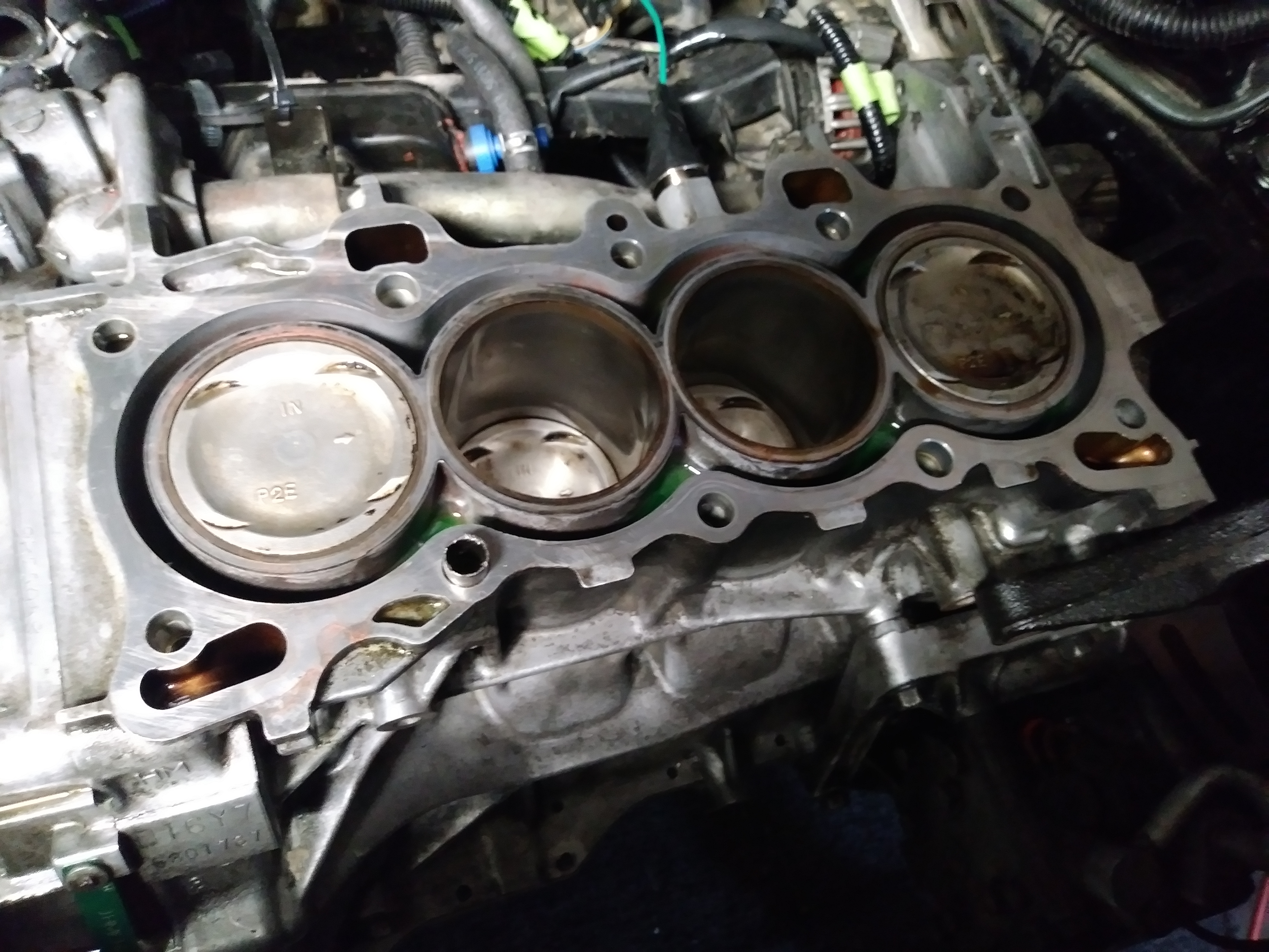

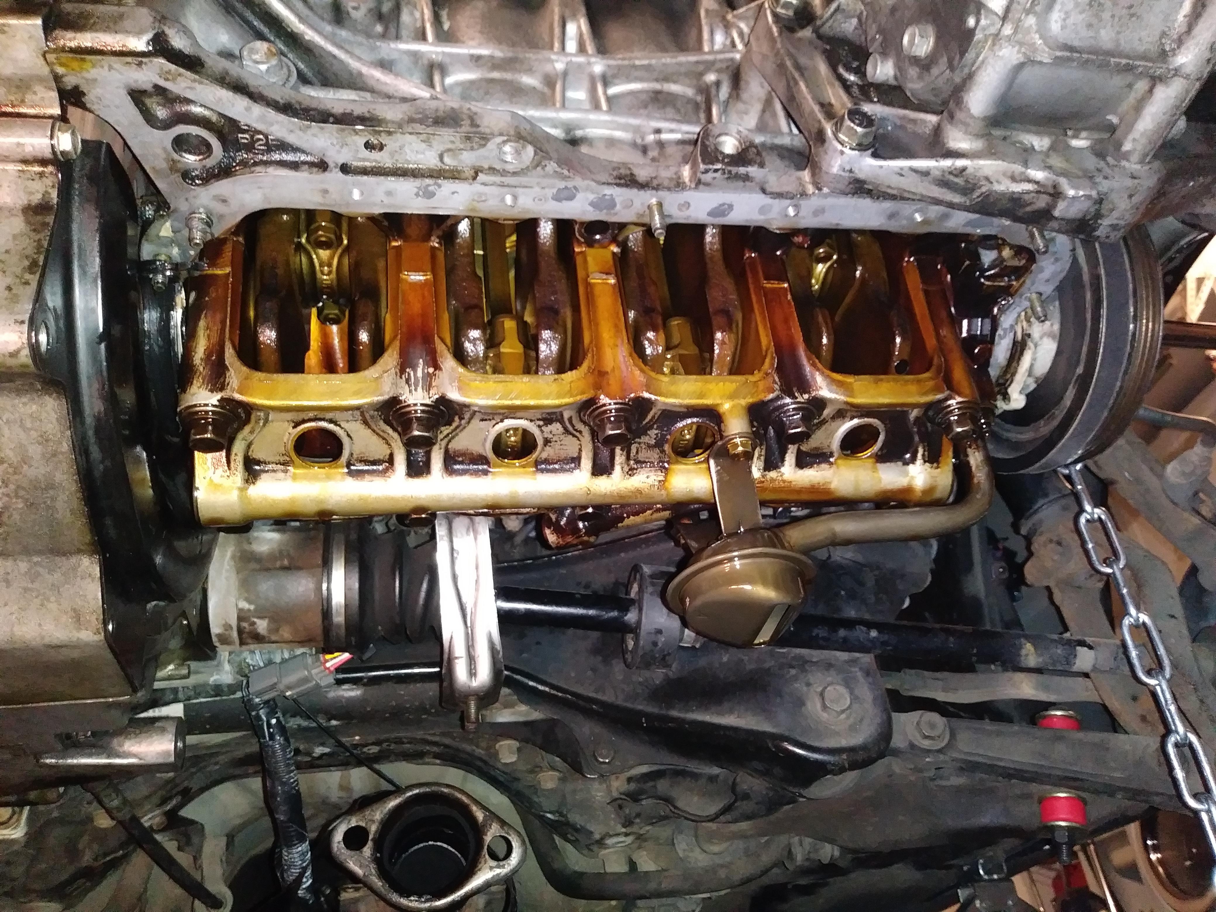

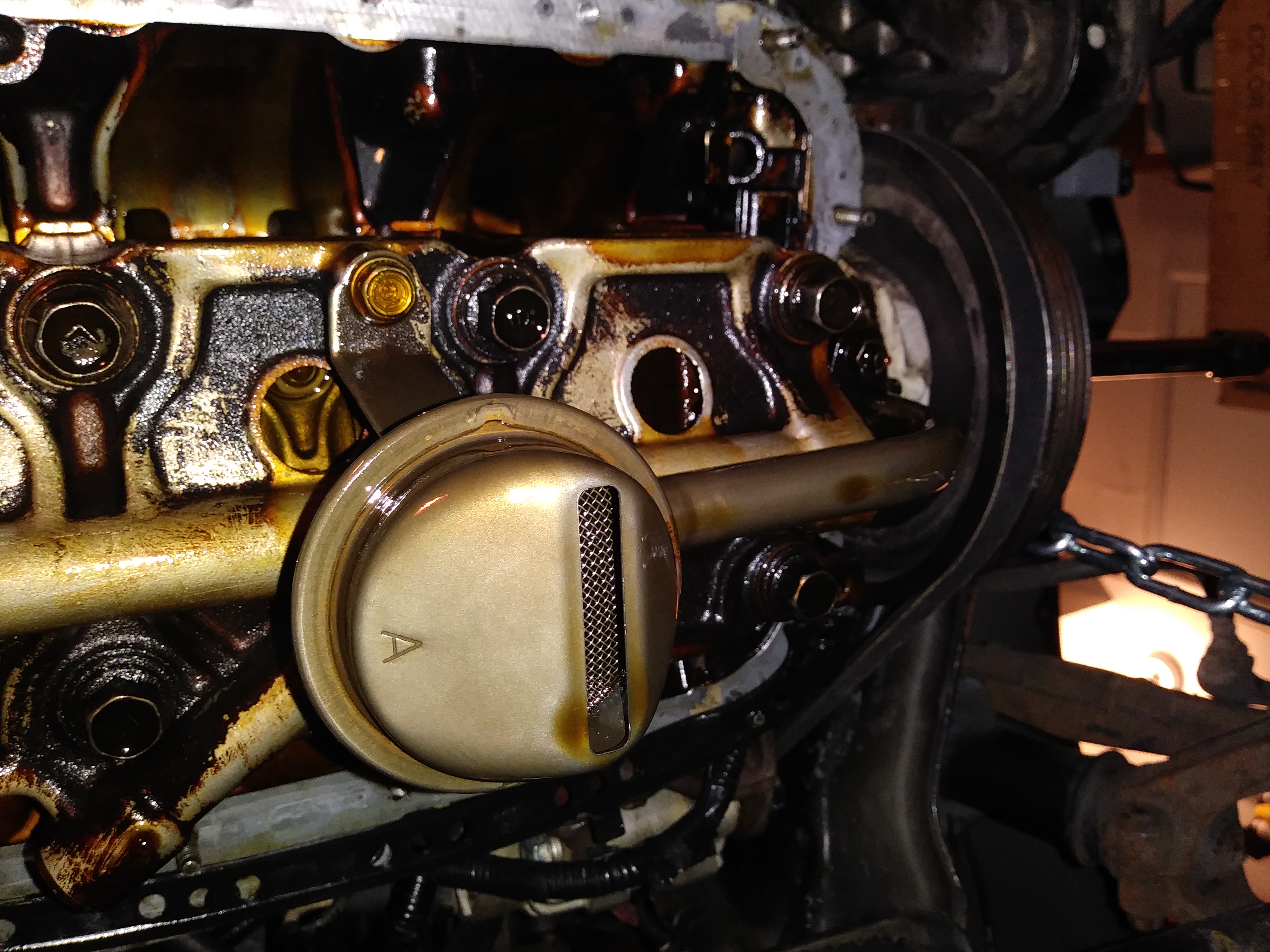

aldo have to replace gasket on oil pan. this is what i found..normal?
ID:	89871   Click image for larger version
ID:	89872   Click image for larger version
Old May 29, 2017
Rep Power: 518
Make sure you get all the tiny little washers removed from the studs or else your new pan gasket will leak like a sieve. I think I can see at least one stuck to a stud near the rear.

Old May 30, 2017
Rep Power: 518
just pulled out the last head bolt on at least two of the head bolts I noticed sucking air noise
That's the sound of oil trying to fill the hole as you pull the bolt out. NBD. You will need to suck liquid out of the holes again before assembly though.
their policy is no return if the box was opened so now debating
Ok how the F are you supposed to know it's wrong until you can see it right next to the original part? Counter help effed up, right?
Won't let you return it brand new...Elmers glue that box closed LOL......or make them lifetime warranty that ish.
The guy on our tool truck does warranty game with tools that are past the warranty period LOL....sell a brand new tool to replace the broken one, then 5 seconds later claim warranty on the new one so it's free replacement to me.

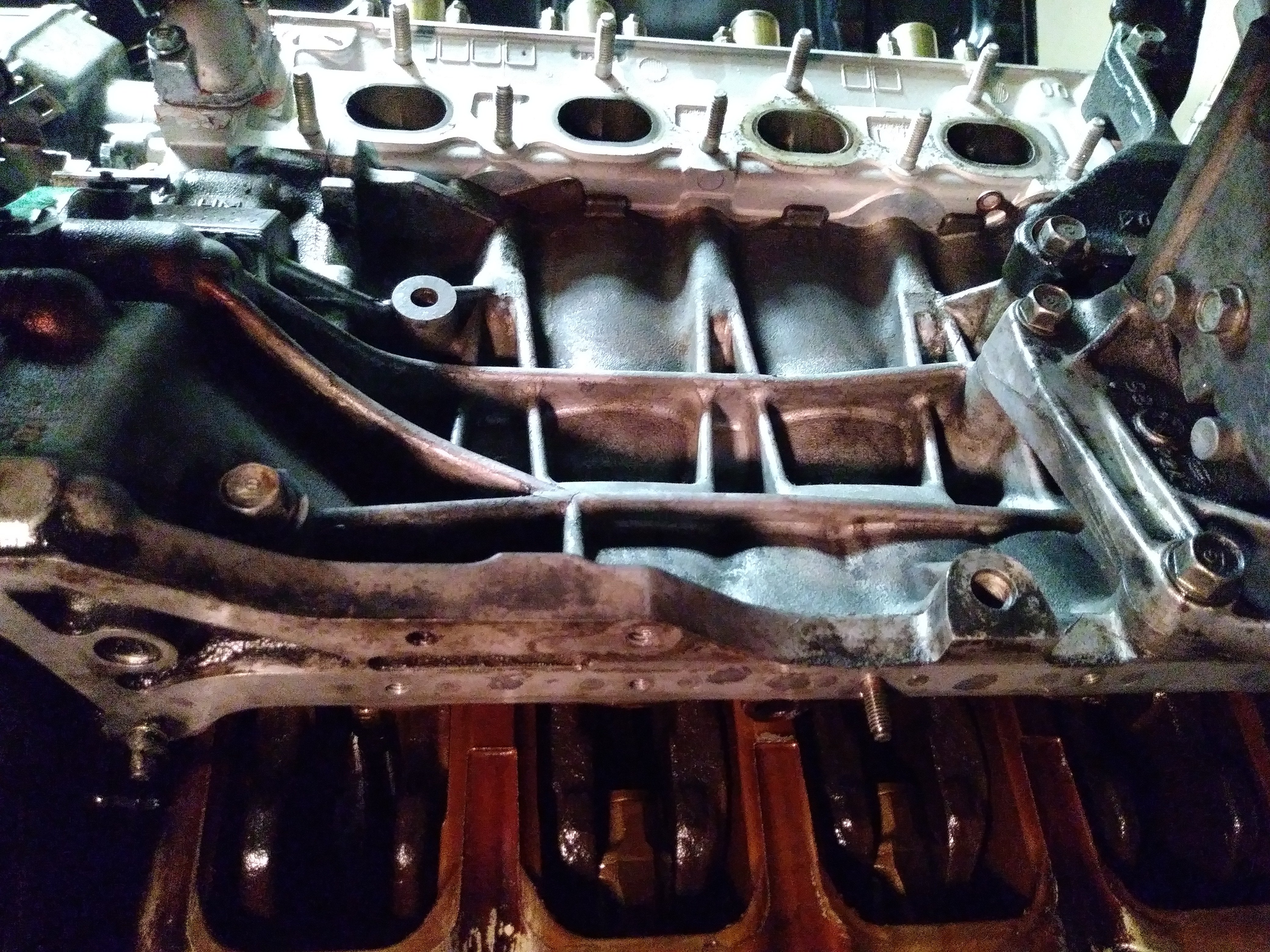

haha im sure they would work me. if they know my name, car, year and let me rent the honda crank tool for free because "im always in the store" they will...issue tonight is a ride etv but no biggie...other things i can do while head is off.got a picture attached...looks like i have 1 damaged dowel..hondas got them for 6$ for both..or there is a home depiot within walking distance lol. before i get back to work i have to ask your opinion on this too....watched a video on a guy who made maybe 3 small holes in his oil pickup tube due to low pressure etc. has me intrigued but im done "experimenting with the car" haha

I see one dowel that looks a little chewed, where is the other one?
If you can make it round enough to fit each end in its holes and still pass the head bolt through it, then I'd use what's there.

other dowel came out clean. im just wondering. if it looks like a "must replace" Last thing I want to do is pull the head again..
Much like a keyway is used to keep parts aligned during assembly, the dowels are used to ensure the block/gasket/head are all correctly aligned during assembly.
They don't have to look good, but they have to be round enough to fit both ends in their respective holes so the head sits in exactly the right place. They could be cut in a zig zag like Charlie Browns shirt as long as they can do the job they need to do.
Bellhousing dowels sometimes become seized in place, I have mangled many during removal and managed to straighten them out enough to be usable again. A variety of sockets can help clean it up....

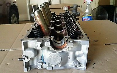

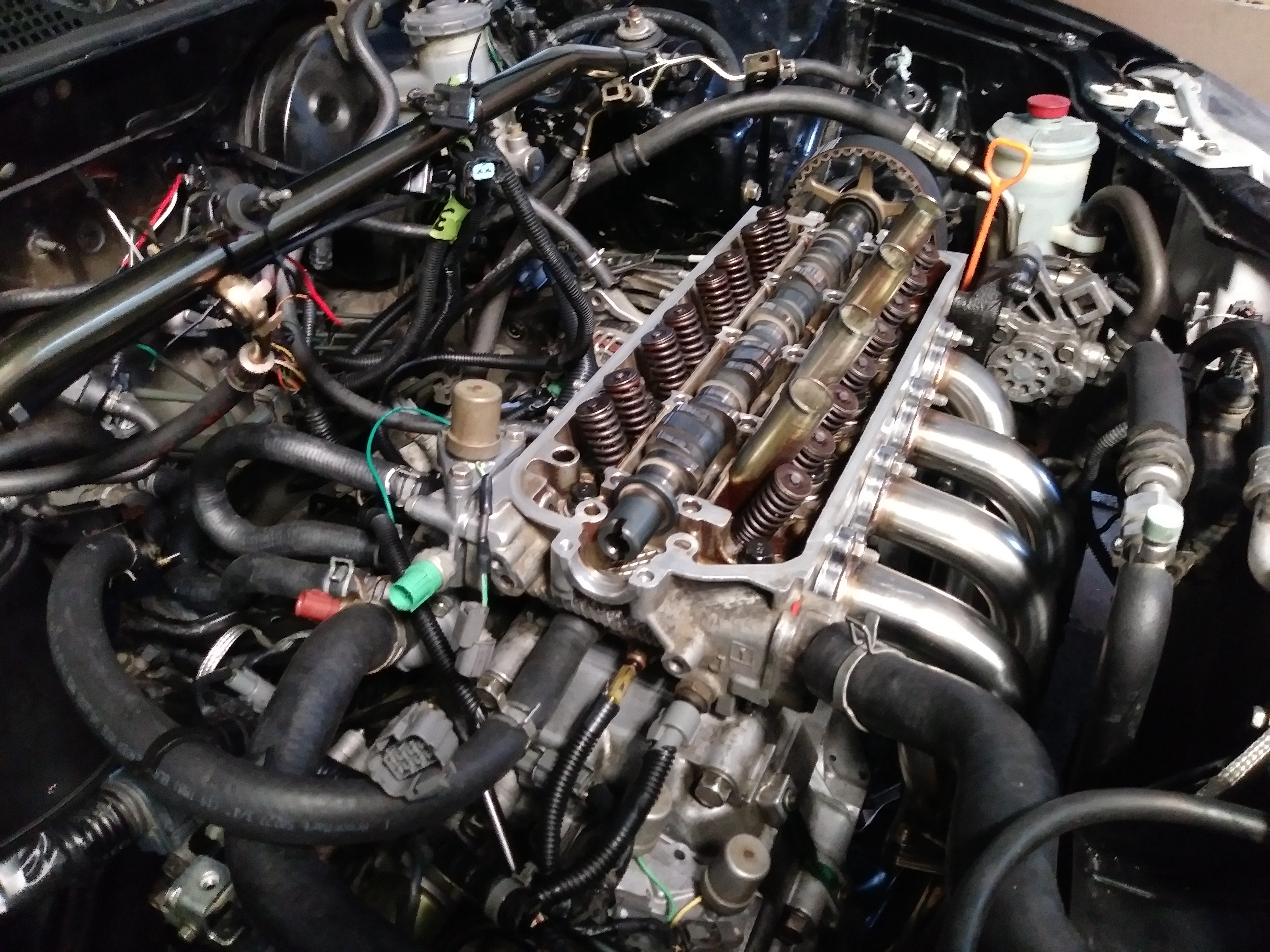

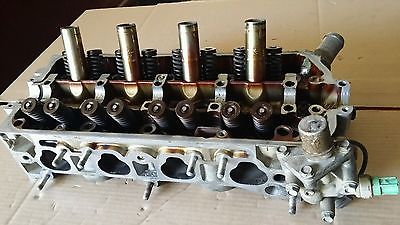

And I'm back...long story short turns out my low oil was due to the -you guessed it - oil control valve om the block.. Im sorry inside the head...well me being a rushed removed thwo bolys you arent suppose tl remove...shortly thereafter i jave the assembly in my hand....right then and there pieced jt back sold ot same night for 130$...head IM header and TB....wtf...then few days later I'm at it again on a VERY tight budget...ebay either had damaged neads for 50$ or rebuilt nicely for 500?..somehow o foumd this guy reveived today and new bolts are stil "out for delivery".. So now need to finish up the head decide if new/aftermarket parts are going in since its wide open...NEVER liked balve tran..but this time around its slow and by the book...iys still not running tonight thougb...comp cam is expensive ha
If anyone hates in it ..hey i blindy shot an offer of 80 when he had it for 100 even. Free shipping...guy i know hooked it up with free inspection etc. And said besides quick wash it was good to go. its gonna suck building last bit up but maybe itll be worth it who knows.. sorry in adva cfor rocker arm lma and cam questions in advance. Sorry about spelling on cell phone

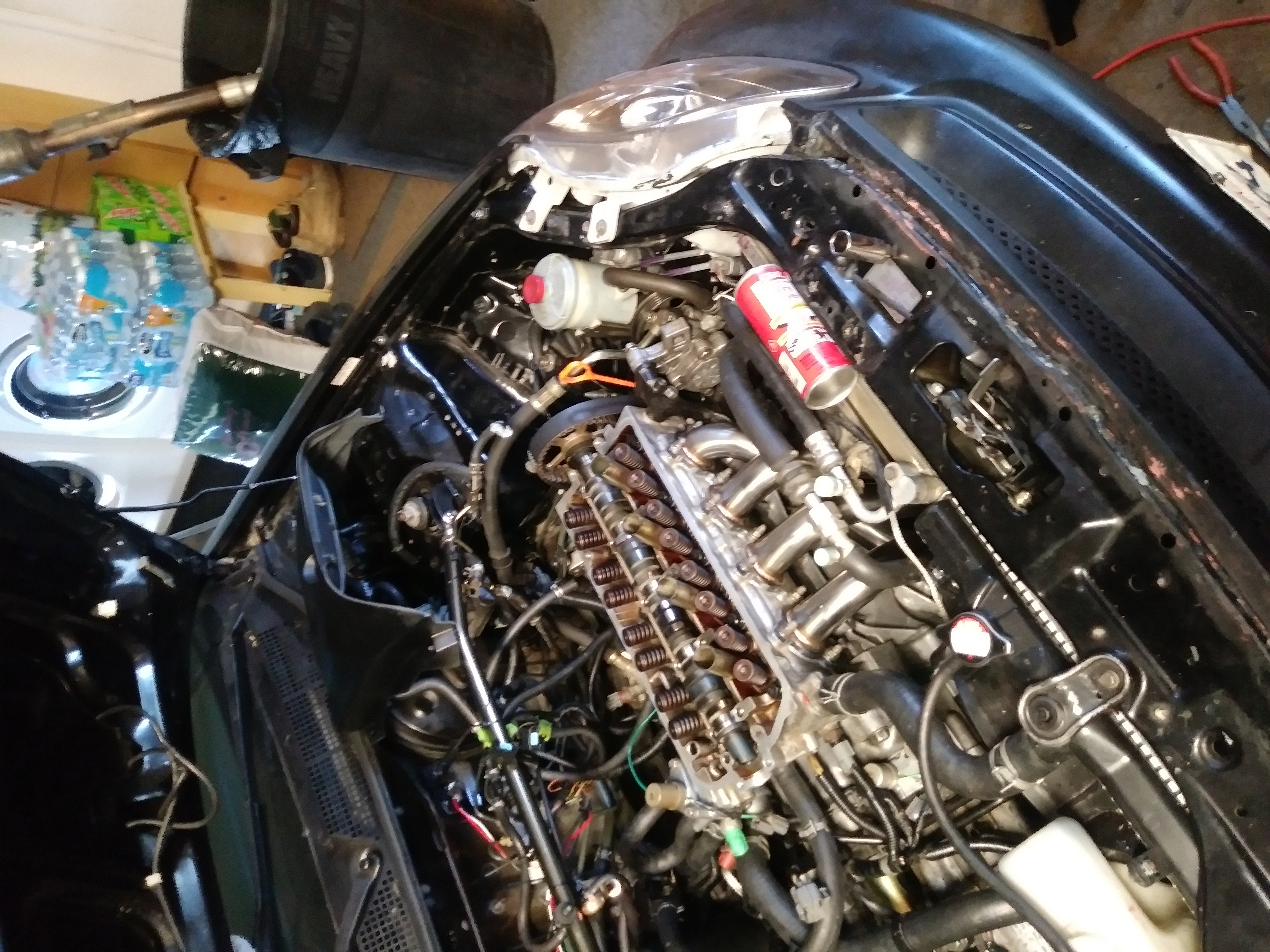

Old Jun 20, 2017
2kej6's Avatar
Joined: Jan 2017
Posts: 109
little update

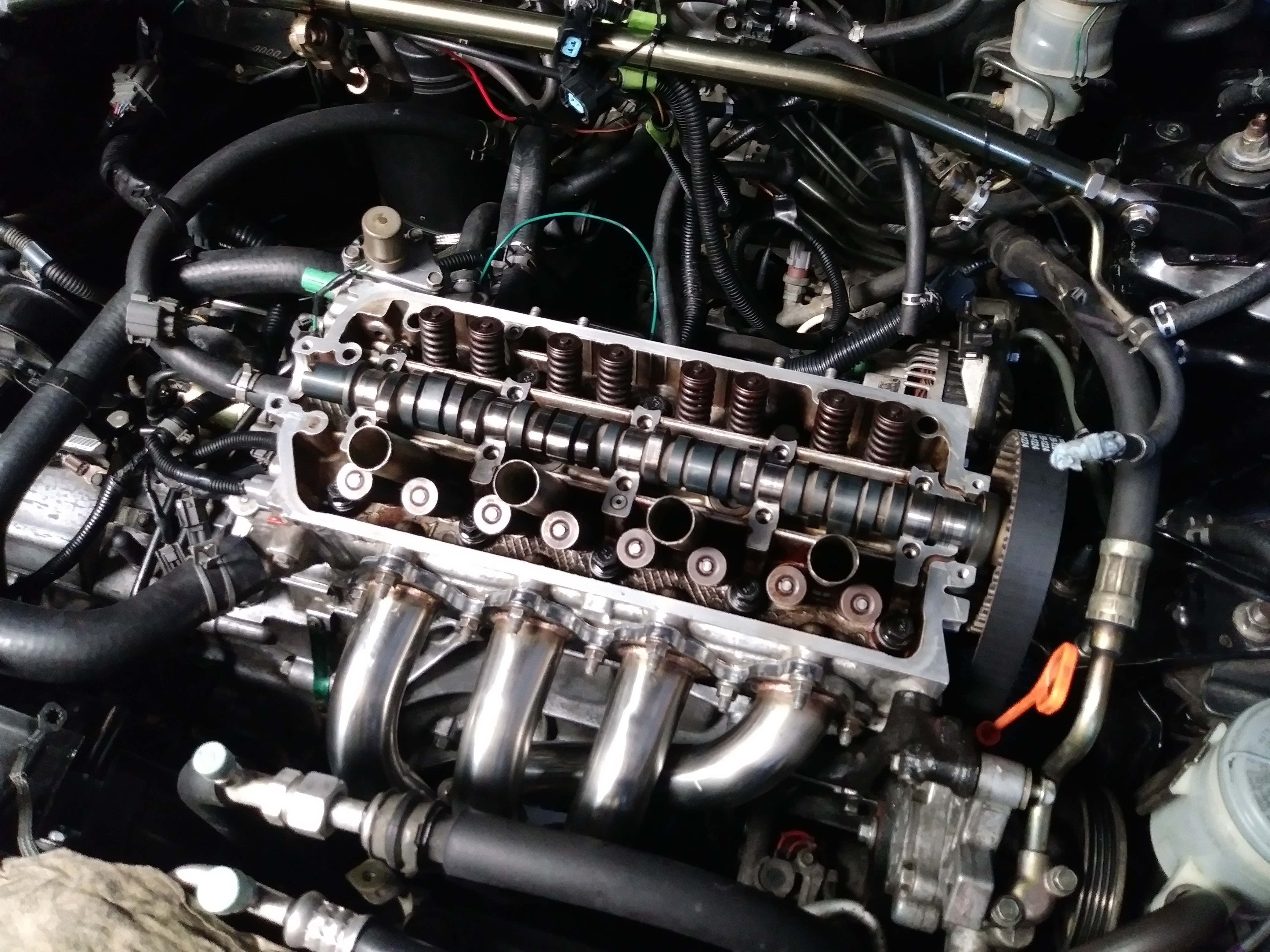

alright so the head is on with new head bolts torqued the right way/sequence. cleaned the ishh out of it before putting it together this time IE vacuuming out bolt holes, area around cylinders etc.. went to the pick and pull and found a camshaft w cam gear for 45$..(thought about comp cams/crower etc. but the way my wallet is set up...) Id like to do the measurements with a micrometer before everything goes back together...went ahead and bought a header (one that fits and has an 02 port so hopefully no cel. In the pictures you might notice the "oil control orifice" to clarify I NEED to remove this when doing the y7/y8 mini me...I didn't last time and had 0 oil reaching vtec solenoid...so the last items ill be shopping for are rocker arm assembly and lost motion assembly. Cant decide on pick and pull due to $$ or swap out springs, valves? I am also replacing the seals on valve stem since I'm in that area anyways..thoughts? input?
ID:	89915   Click image for larger version
ID:	89916   Click image for larger version
ID:	89917   Click image for larger version
Old Jun 20, 2017
Rep Power: 518
Head came without journal caps? Waste of an otherwise good head.

Old Jun 22, 2017
2kej6's Avatar
Joined: Jan 2017
Posts: 109

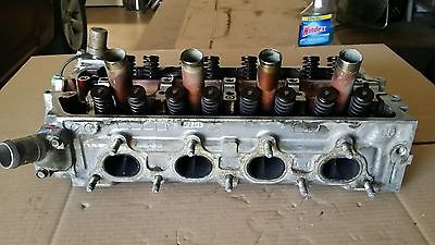

so i got around to snapping some pictures of this y8 head...to those who have built, serviced a bare head how does this look like for starting point? so far ive just cleaned it. i do see some scratches cant feel though...will replace seals...other than that should i bother? or buy a complete head..also professional machining or diy status?
https://drive.google.com/open?id=0B_...UQ1MnNUU2RCVUE
Old Jun 25, 2017
Rep Power: 518
Where are the cam journal caps?
They are "married" to the head during the machining process and should never leave the head.
Any replacements from any other head may not match exactly, which could lead to camshaft binding or locking, and/or lubrication problems.
All times are GMT -5. The time now is 12:35 PM.
