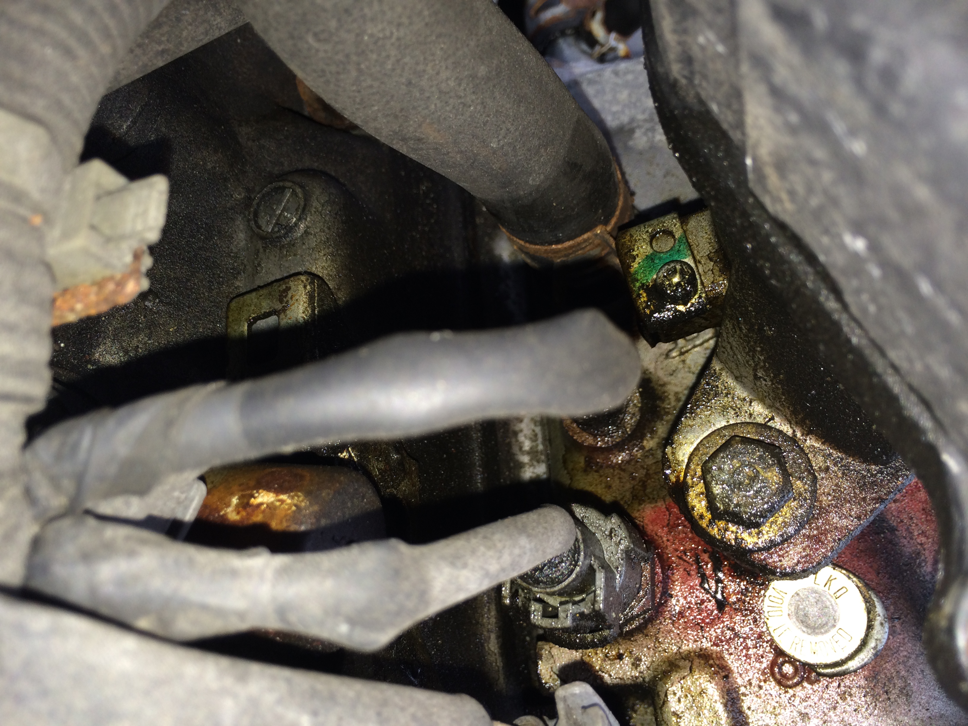

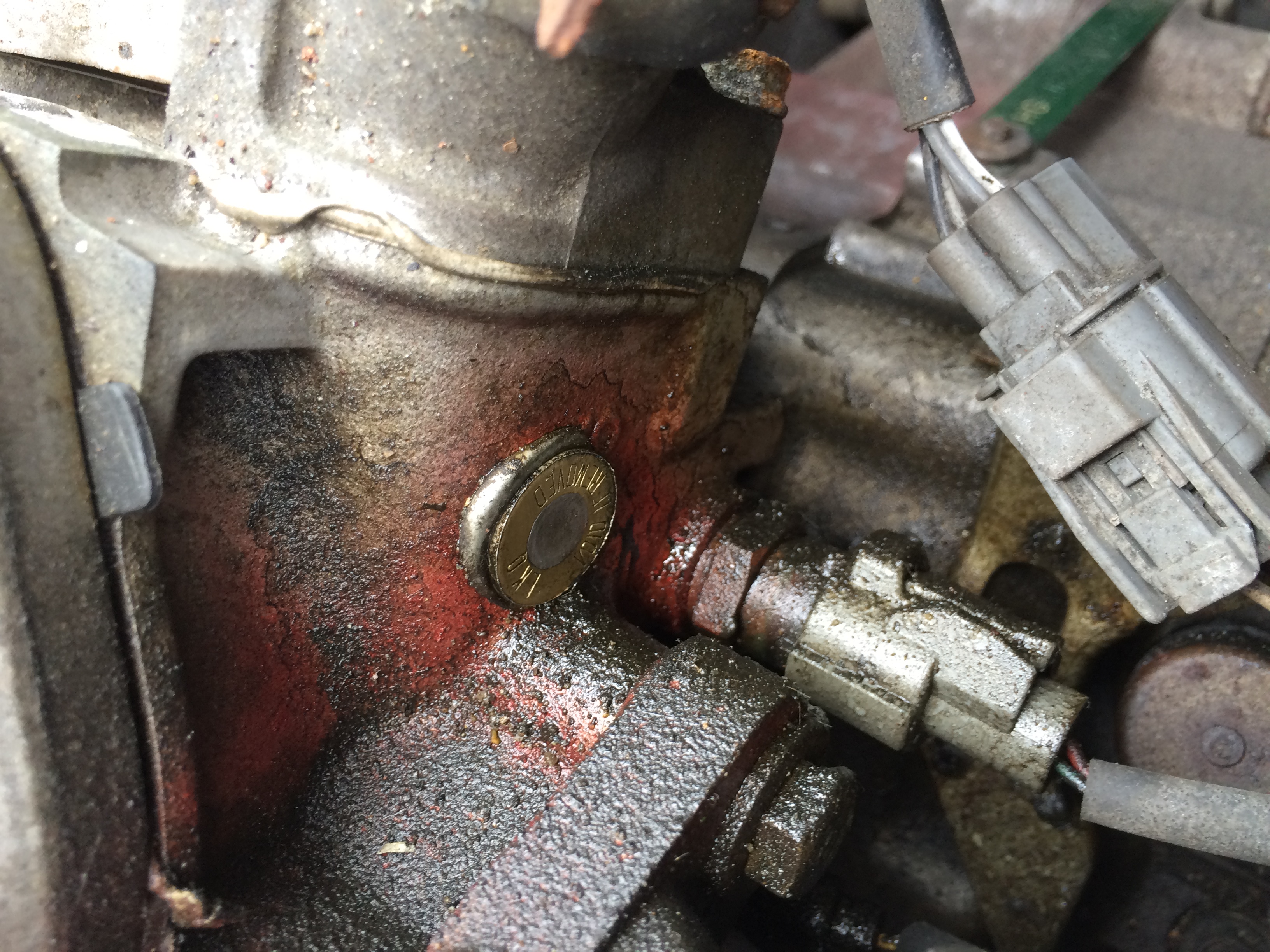

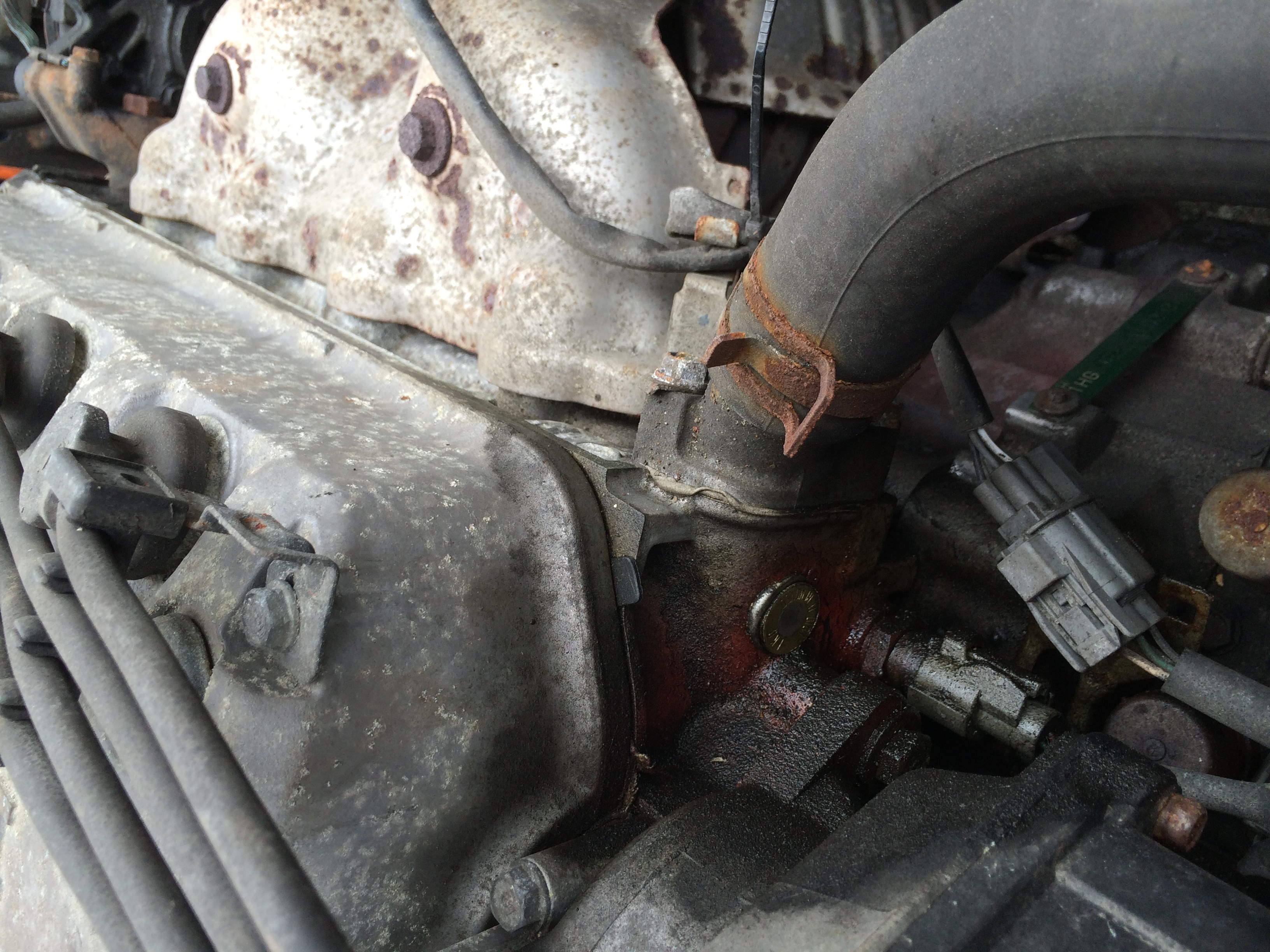

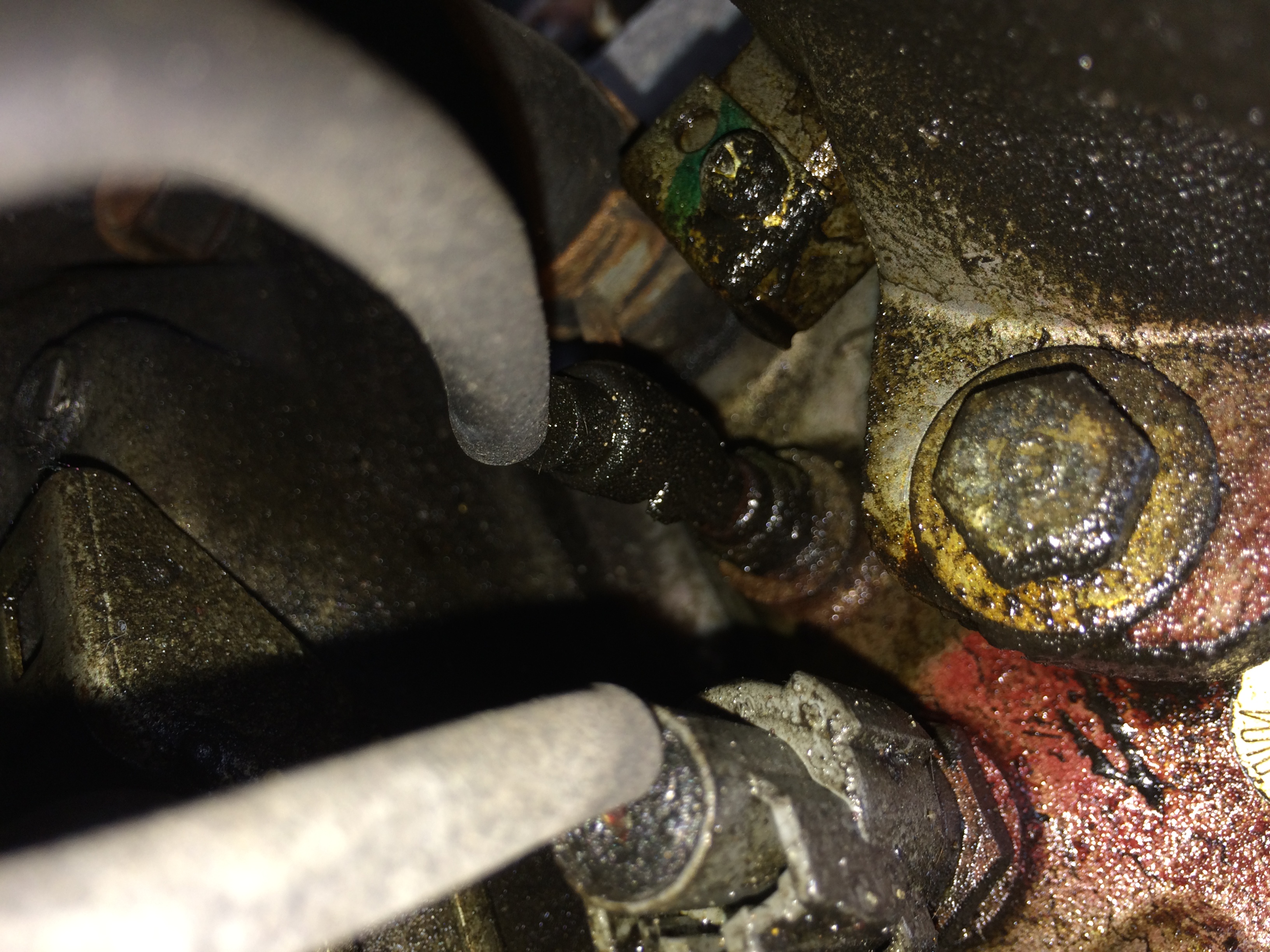

First and foremost- my cylinder head has a LKQ plug (#1344)... so I have a reman'd head - no mention of this from previous owner(typical) or carfax. The plug has a bit of fluid around it and has given the area a light coat (#1348) (#1355) (#1356). Upon further investigation I revealed that engine serial is not the one my car was born with. SOO... "new engine, new cylinder head" maybe new internals? I'm gonna go out on a limb here and say the yellow Gates timing belt tag on the fender would be the best estimate of when this EJ got a heart transplant.

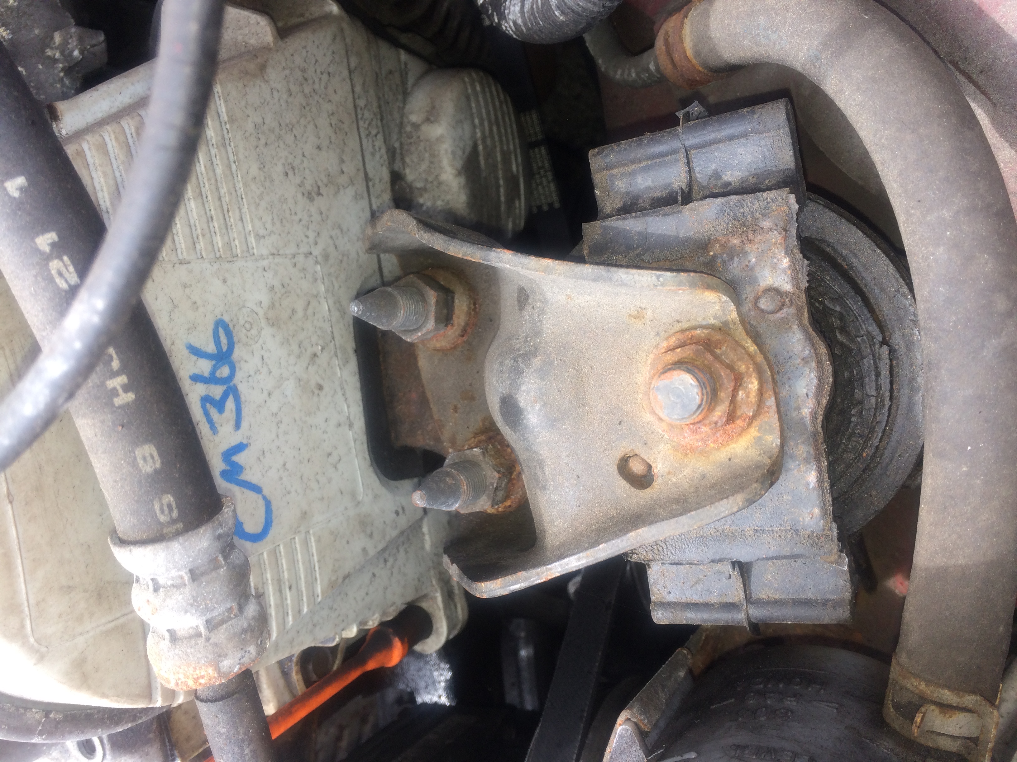

Next, I wanted to check the engine mounts- which look ready to be replaced. (#2350)

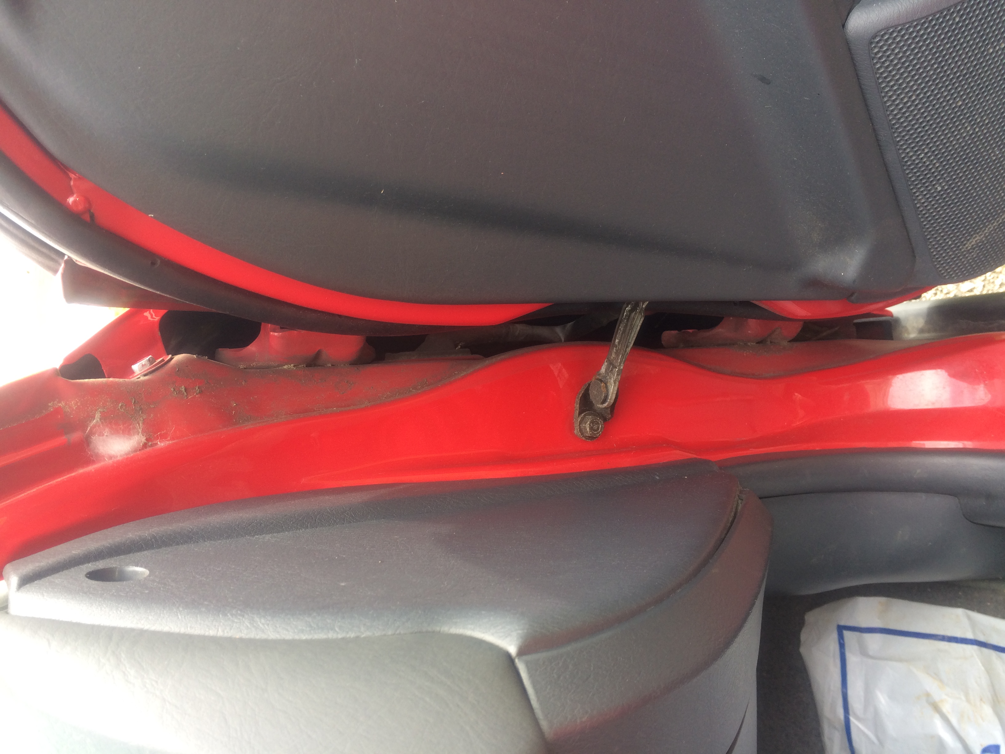

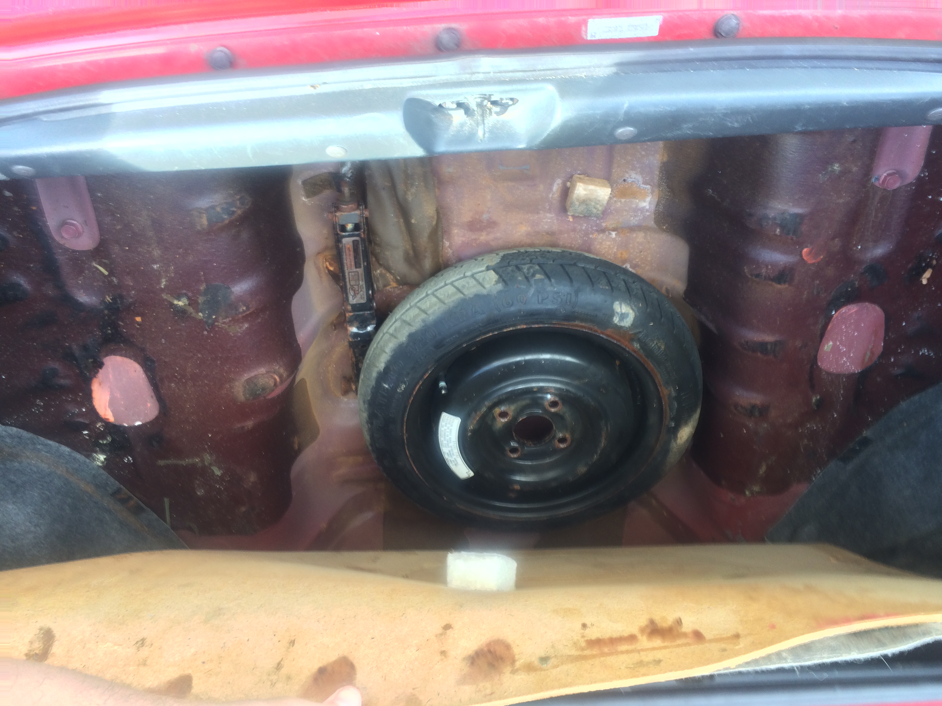

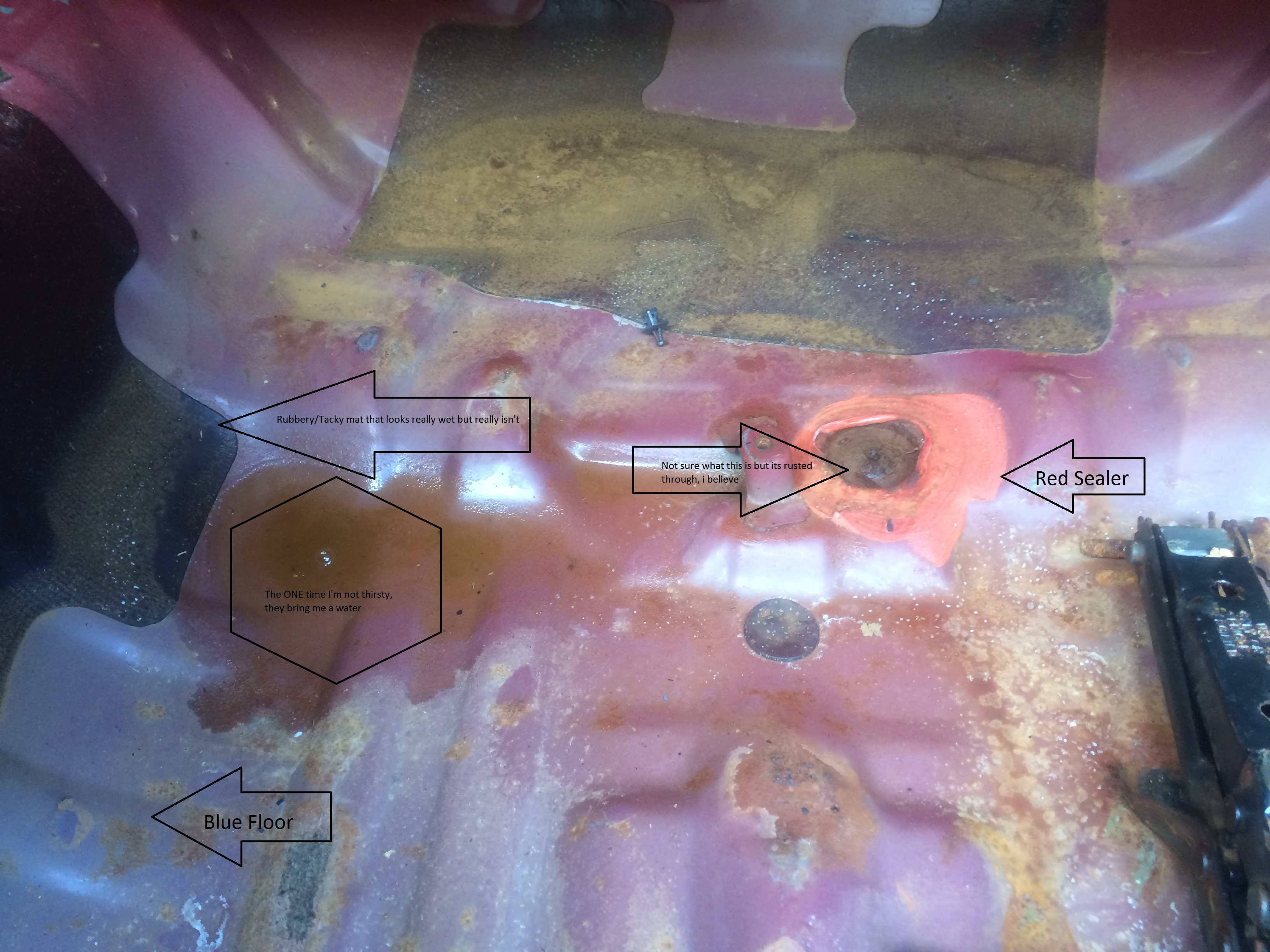

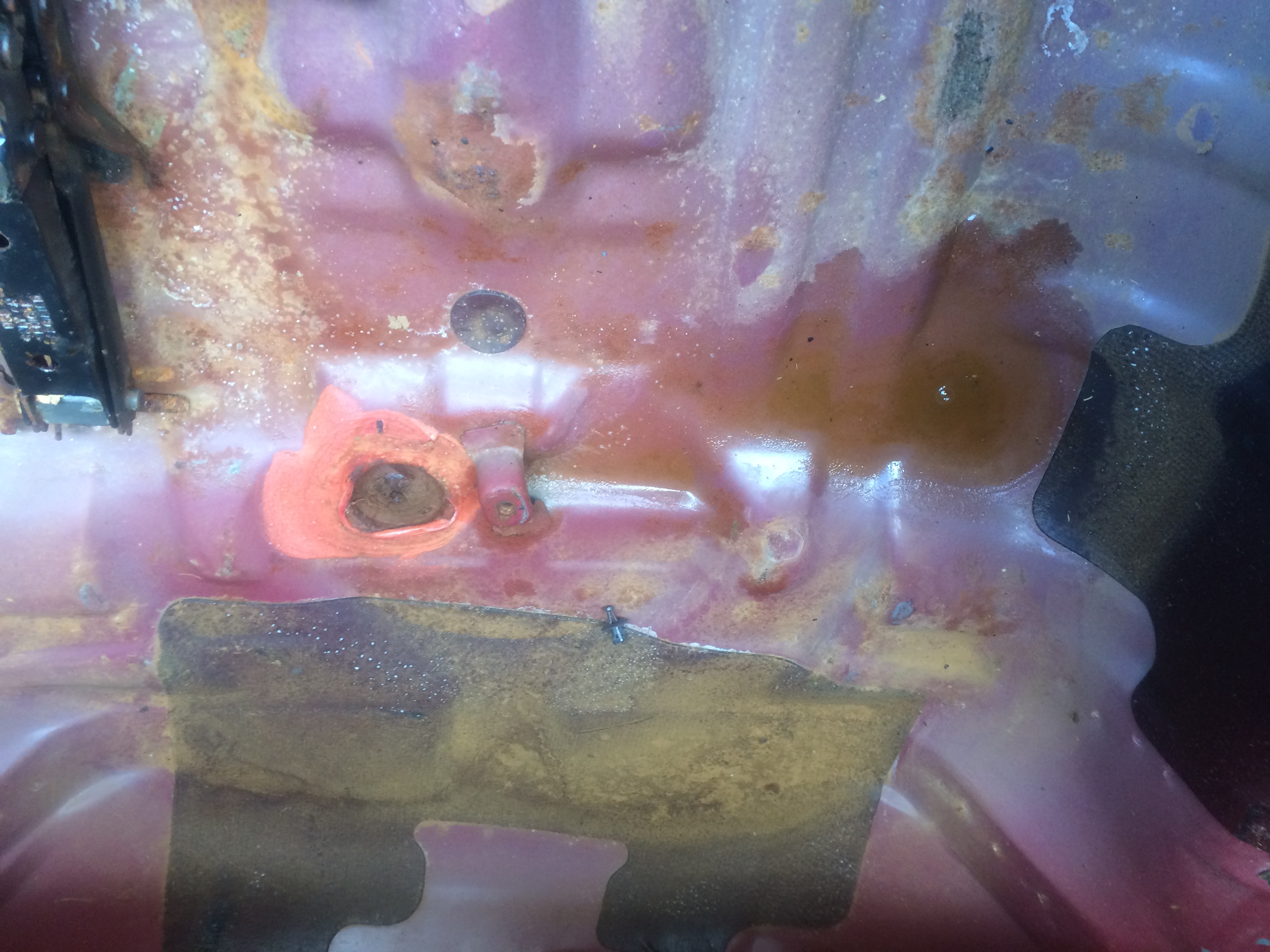

There is a weird "issue" in the trunk that needs addressed sooner rather than later. There is water collecting. Stagnant water + metal = bad.

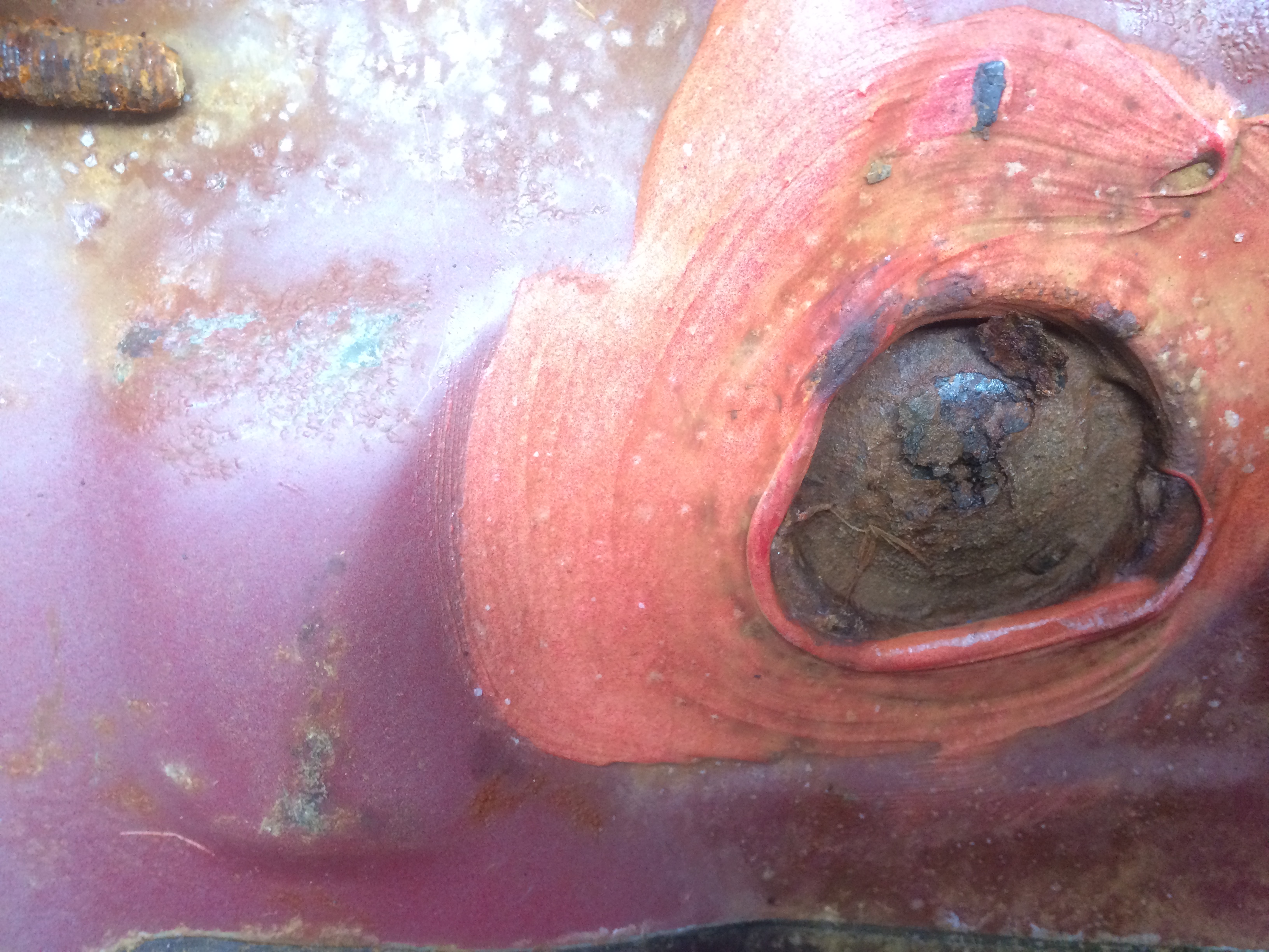

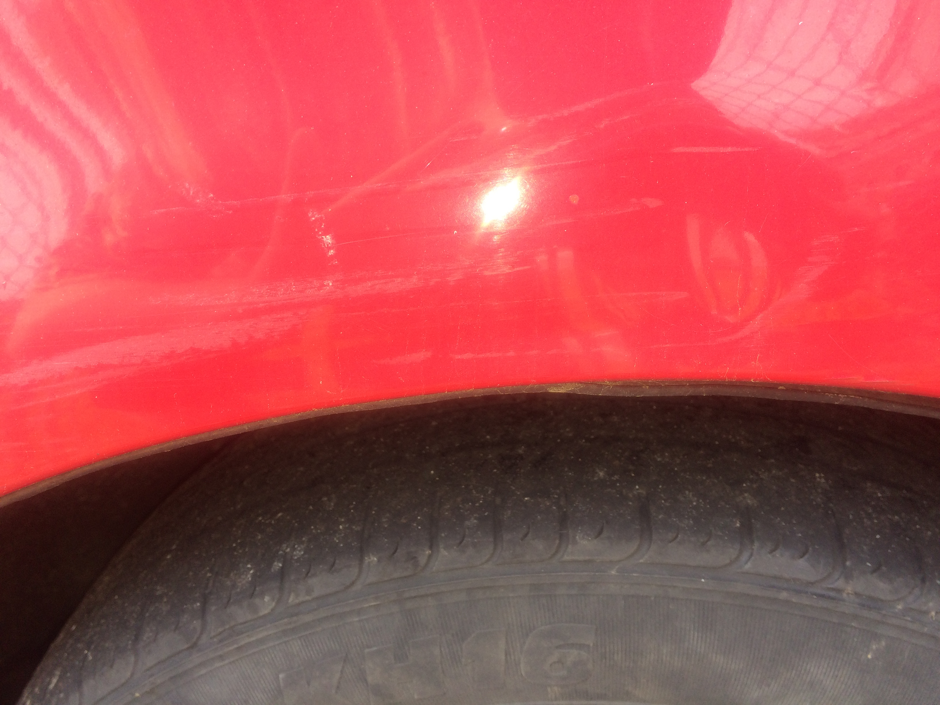

(#2305)(#2307) (#2308) This lead me into a different train of thought when I was taking these pictures.... Why is the floor pan not the same color as the rest of the car?

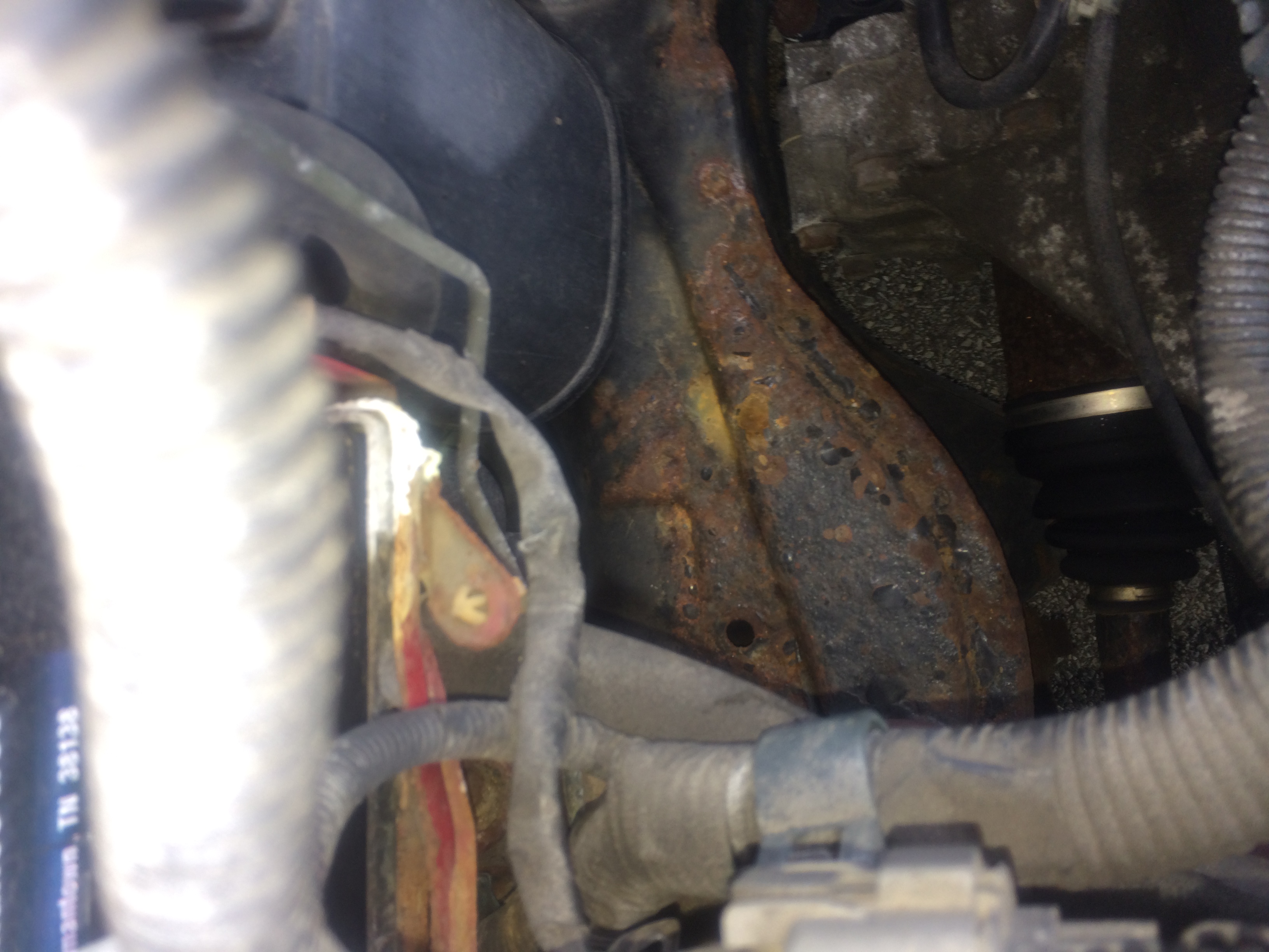

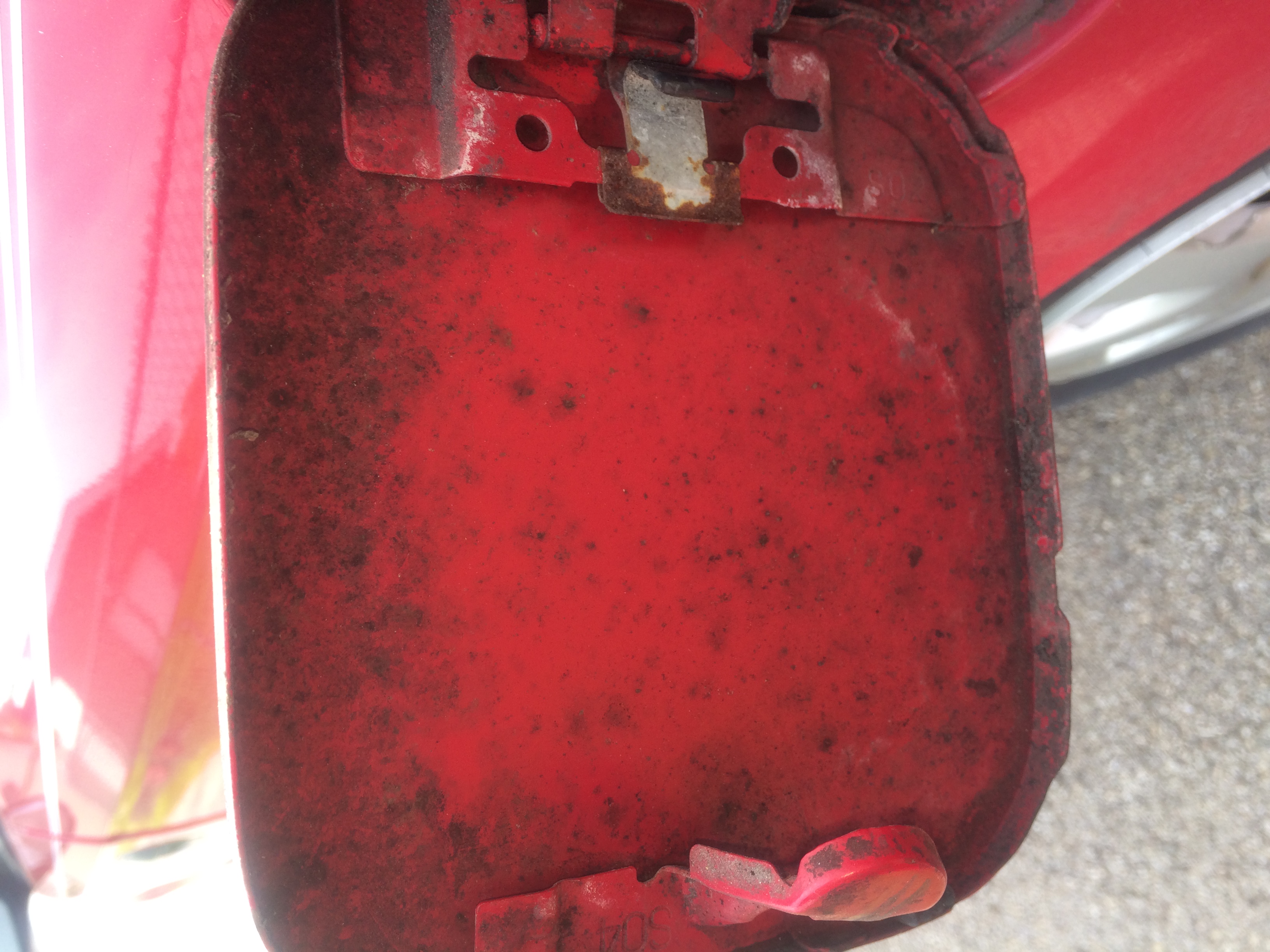

Finally- on to the less than prime real-estate that could use some rust-eze.
(#2351) (#2363)

First and foremost- my cylinder head has a LKQ plug... so I have a reman'd head
And most likely due to overheat(s) issue. Hopefully previous owner fixed it properly. Looks like LKQ tapped the head and inserted that brass plug.
With e-brake engaged, engine running..have a helper put transmission into forward gear while simultaneously pressing the brake pedal and slowly applying gas pedal. You're job is to (standing on side of car, hood open) watch how far the engine lifts when load is applied. The engine will lift some and that is normal. Abnormal is excessive lift, vibration and tapping noise (severely failed mount(s). Also, perfrom the same test in reverse gear. Use plenty of space (empty parking lot) and caution (don't stand in front of car while observing mounts).
There are three motor mounts: driver side upper, passenger side upper (under air intake), rear lower (firewall near charcoal cannister) and two torque mounts: driver side lower near a/c condenser and passenger side lower near radiator. The two torque mounts are commonly and easily torn. Cheap and easy to replace but, debated whether they provide support for engine. Ezone told me they are there for safety reasons in case of accidents.
Rain water is most likely coming in through rusted or bent seems in rain channels located under the trunk lid: between trunk rubber seal and body.
This is another fairly common issue with older 6th gens. The factory seem sealer eventually breaks down or rust develops from underneath the rear glass or lmetal lip that the rubber trunk seal covers or the seems themselves and eventually creates holes for rain to get in.
My '98 EX has this issue: I replaced rubber trunk seal and re-applied seem sealer but, it still leaks. I narrowed it down to passenger side rust underneath the rear glass..yet to fix it though. Each case is different and the best way to find a leak is to have a helper use a garden hose to apply water all around rear glass, rear tail lights, and underneath trunk floor while you are inside closed trunk with a bright (LED) flashlight looking for sources of leaks.
Looks like a repair attempt of some sort? Maybe a colored silicone or hybrid silicone/latex sealant.
Obviously..that car has spent much time on ice/snow covered roads that use a lot of salt on them. If you don't care how that car looks use some "rust to black" product like Ospho and plan on having it painted. Ospho won't help through-rust..just surface.

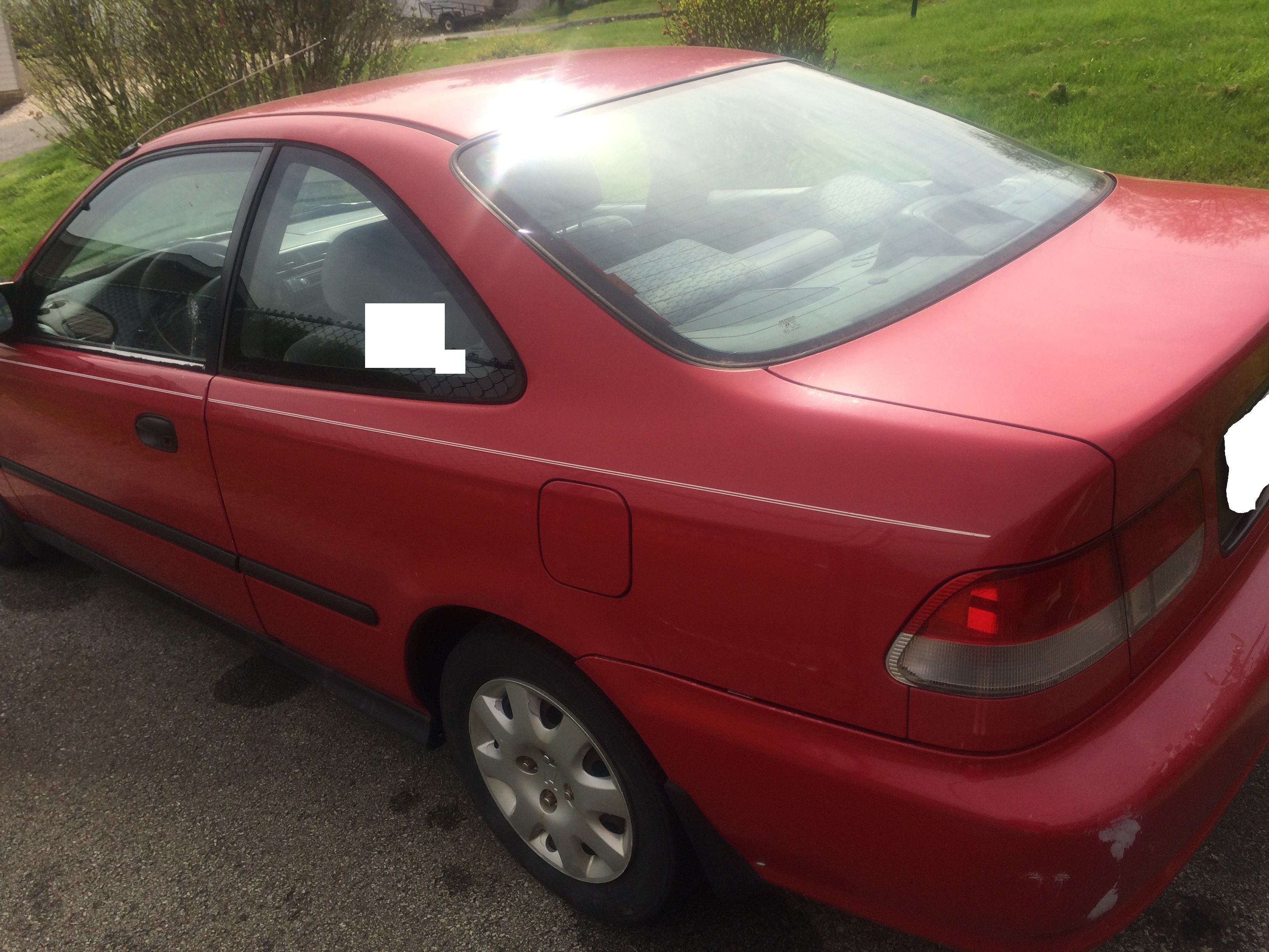

A couple more pics - I'm sure someone will ask about the spots on the pavement, the only ones from my car are under the wheels. Its finally starting to dry out - been rainy almost all week- hence the water in the trunk lol
Which reminds me- I did pull back the carpeting to check the little flapper vents- no rust! I check using the small screwdriver method
LKQ is a auto dismantler/recycler (salvage yard), that's just a used engine they sold.
Those round things are heat tabs installed by the seller (LKQ), the middle of the button will melt away if the engine is overheated.....and then any warranty LKQ gave the purchaser would be void if the button has the center melted out.
And it's a leaker. Looks like all the usual high mileage oil leaks, and that heater hose under the distributor is wet with oil, that's a bad bad thing for the rubber. Fix leaks, replace hose. Oil leaks are usually all of the rubber gaskets needing replaced as they get old and brittle with heat and time. .
Not sure what you are seeing wrong.
Find the source. Could be rusting in the trough and seams below the rear glass where the trunklid seal is. Or leaking around the tail lights
*reads turds post* Yeah what he said.
Floor is red, car is red. Samey samey. It's not had the floor replaced or anything if that's what you are thinking. I'm sure you would find similar color elsewhere in areas not normally exposed like main floor under all the carpet..
Ya, you got some rust worms at work....I'm in the salt belt too, some cars might be starting to look like swiss cheese by 10 years old.
They were flimsy AF when brand new (and the rubber is usually shredded to nothing by the time it gets a timing belt done), the rubber can't support anything and there is certainly no weight applied to them.
My understanding is the two lower ears (mounts) are only intended to help guide the drivetrain downward and under the passenger compartment in the event of a front end collision.
Phosphoric acid, also called Naval jelly. Probably cheaper without a brand name attached to it. See teh goggles for moar infos

The pics were just to show more of the area since the one is just a closeup of the LKQ tab. I thought it was trying to push out- the picture doesn't quite do justice. The silicon around it is slightly bulged but in the picture it looks flat.
Then again I could be overthinking the leaking gasket. I overthink ALOT.... and squirrel
I did a little diagramming with the trunk, see pic

You're right- I meant used engine. As for the AT, as long as they didn't tamper with the vin plate beside the engine serial- its the original.
Then there is the Odom reading just over 92k- again IF it hasn't been rolled back or swapped. The gates belt was installed in 14'. SO.... I'm thinking maybe belts, gaskets, and hose? I'll admit- thinkin on this path is getting me leaning more towards finding a full swap haha

Mat is a tar like sound deadener, I'm pretty sure you can find more of it in the floor of the passenger compartment under the carpets.
Round thing with sealer on it---did you try pushing on it, is it steel or is it rubber or plastic with dirt caked in it? If it is rubber or plastic it could be pushed out to drain water if need be....Not sure and I don't have any similar car to look at.
But the other round black puck near it looks like it's probably a body plug for the car as I remember it.
Color differences....no big deal IMO, it doesn't look like anyone welded in half of a trunk floor as a patch job. Anything in the last 18 years could have discolored (or colored) the paint....and that paint in the trunk was never as nice as the outside of the car.
I don't think anyone would try to swap a VIN tag from an original engine or transmission to a used unit either. Most would either tear up the metal tag doing so or the fasteners would show obvious signs of tampering.

The sealer one is like "RTV" or like a paste that was smeared. The circle with rust is like a cap. I did a "screwdriver" test. Barely tapping on it almost went through. The color difference is no big deal, its covered by the cardboard sheet (albeit alittle deformed) and the carpet. I just thought it was really odd lol
What I put about the VIN, was more of a CMA incase someone popped the question- it would be answered before asked- thats all
It's a body plug and the smeared stuff is a body seam sealer to make it 'permanent' and leak proof, it's not exactly the same as RTV, it's used in body panels and seams.
Now that I'm awake enough to goggle surch it:
(strangely enough, from a thread about water leaking <--link)
