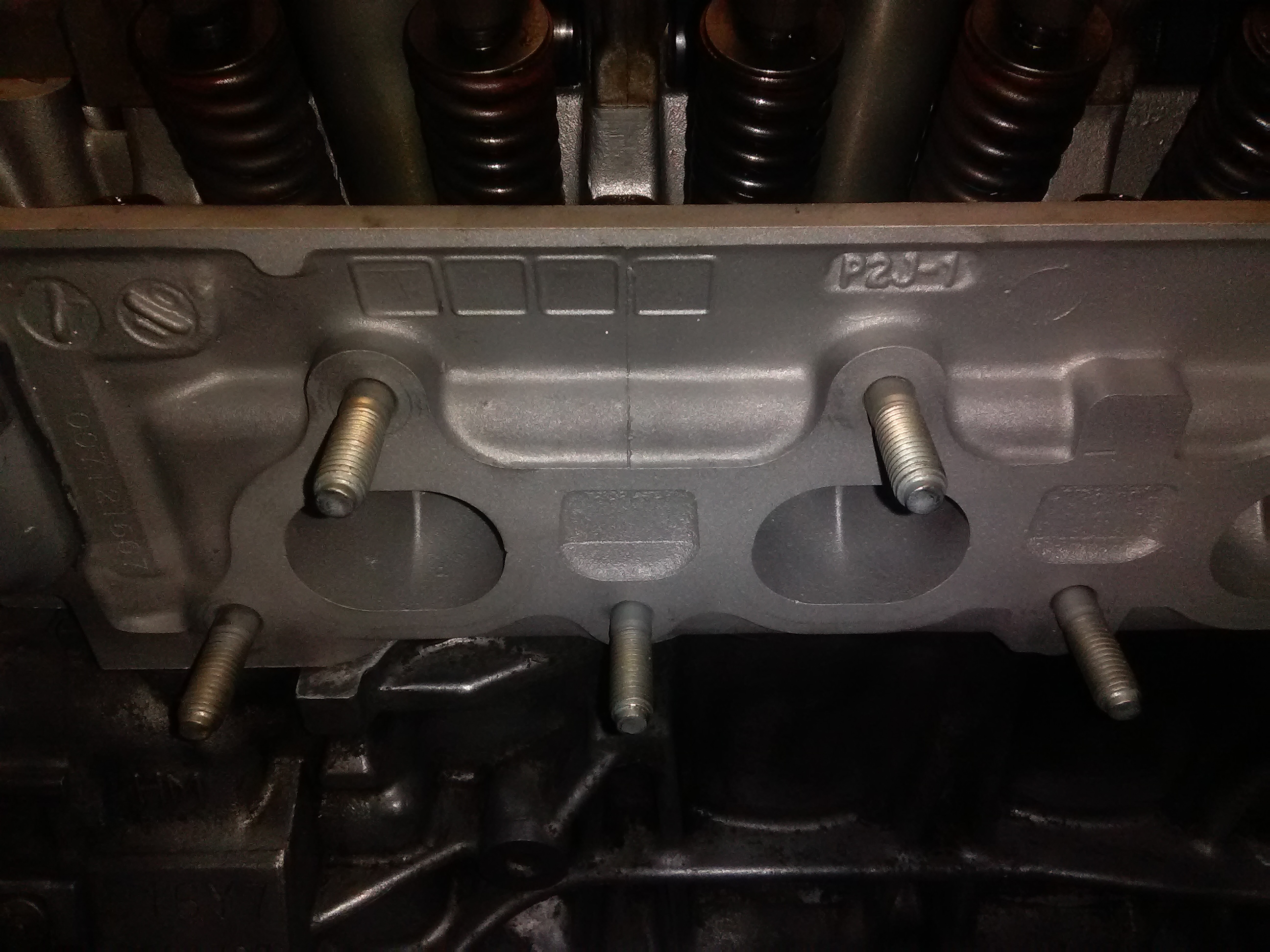

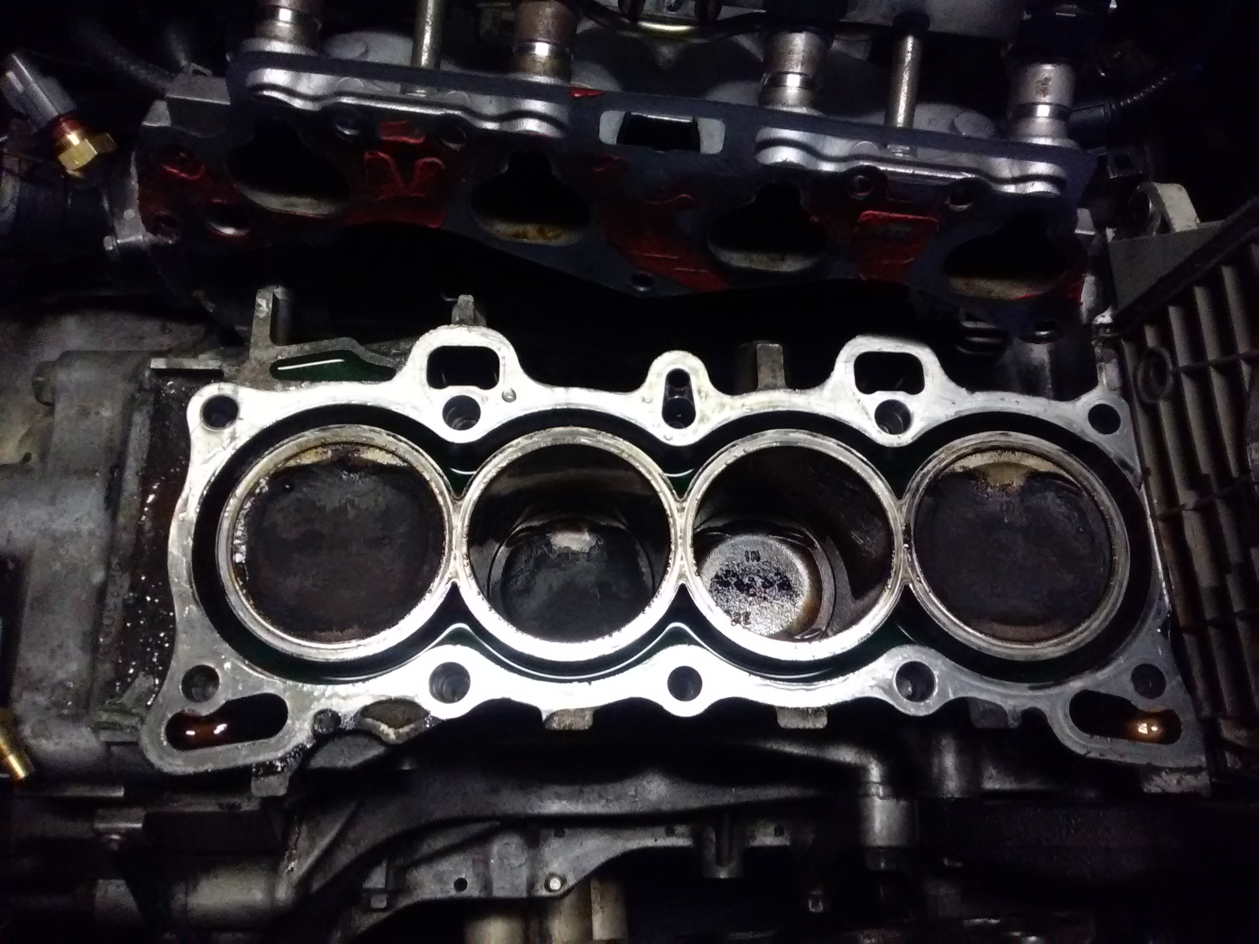

For a while now I've had issues with idle/overheating/leaks/ you name it..so decided that if I'm going to do a head gasket change why not pick up a cheap rebuilt y8 head for some vtec action haha. well here's where I stand on the swap..i forget the member who linked me to the YouTube video but it was on point and in no time Head is finally off and I could see what was going on:
My only question id what the circled holes are for in the picture of the y8 head..I know that I need to swap over some things from the y8 still but I have no idea what would go there or what they're for. Sorry if it sounds like a noob question - first timer with a mini me vs complete swap Also those who've done it any advice etc?

According to the linked diagram below they look to be the Lost Motion Assembly and LMA holders.
http://s639.photobucket.com/user/Ron..._3960.jpg.html
Mini Me info:
https://honda-tech.com/forums/honda-...be-not-735196/

Thanks for the info. This wouldn't be an issue I wouldn't think.... 200y8 on a 2000y7 block....Also...Since I'm still cleaning up the entire engine Bay while have room....Would you know how to accidentally slowly remove AC from lines....Asking for a friend.....Overseas I was certified to use Evacuation tool or purge if none were nearby...In the u.s however..... Something as easy as a pin size hole leak??? Again asking for a friend...
Plenty of info on the net concerning mini-me swaps so do some research. The LMA's shouldn't be an issue.

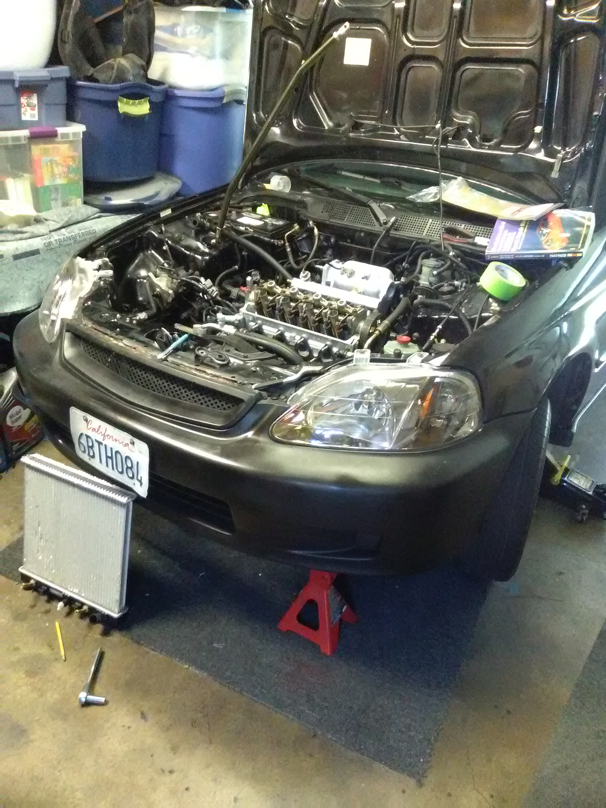

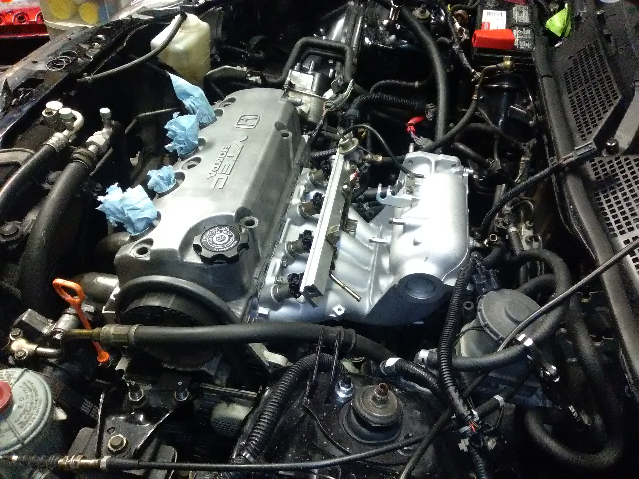

ending day two:

Originally Posted by 2kej6
Now I need google/YouTube to give me a crash course on valve adjustment
This is better than Youtube...free service manual download: https://www.manualslib.com/manual/46...nda-Civic.html
then in the AM pick n pull to hopefully find correct ecu/vtec solenoid/y8 fuel rail and possibly TB. Also need to figure out this knock sensor issue everyone writes about, each post is different
Can all be found on stock '96-'00 EX model. Pull the knock sensor too because, a new OEM one is expensive ($200) and the Ebay one's are crap.
.head is officially torqued.
These guys are offically torqued too..lol:

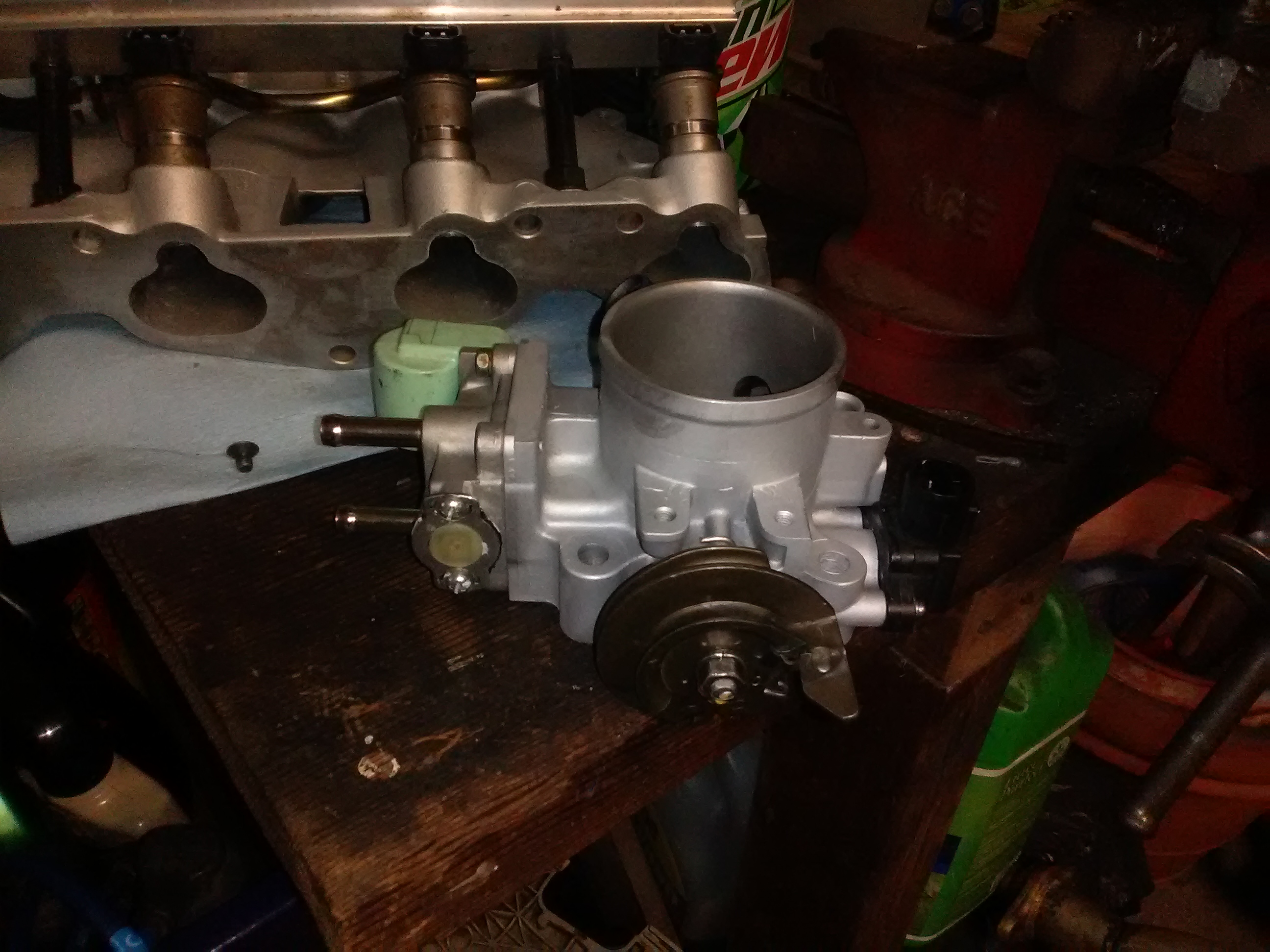

alright. my "genuine" Honda leak less intake manifold is out for delivery according to usps...It didn't come with the regular guy who walks so hoping it shows on the little package truck.... either way today I have to adjust EVERY valve because when it was rebuilt it was pretty much thrown on just enough to not fall apart...slowly but surely its coming along (not sure if anyone is even following haha). still looking for a reasonably priced vtec solenoid. and knock..(ill grab the knock from pick n pull when the rain stops) amazon had awful reviews on their 8$ sensor compared to Hondas out of control 50-80? so all I have left:
solenoid and connector (pigtail connector is en route via mail)
knock sensor (awaiting CA weather)
y8 fuel rail/injectors? (more googling on that)

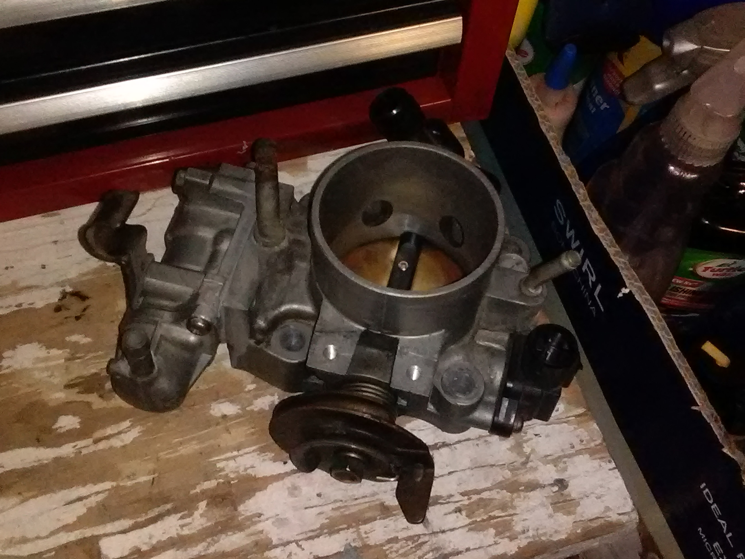

Throttle body? + gasket (cleaned my y7 just in case, gasket is a must either way) I've been running the y7 TB on y8 IM anyways.. Also I have a b18 TB that matches but the IACV looks off and I don't know how or where I'd connect lines/ block what off etc.
I may be wrong but as far as wiring vtec my p2p (off an auto EX) should work. Given I wire it up of course.
By the way how do I get one of those cool "rep points" lol...I want a rep point.

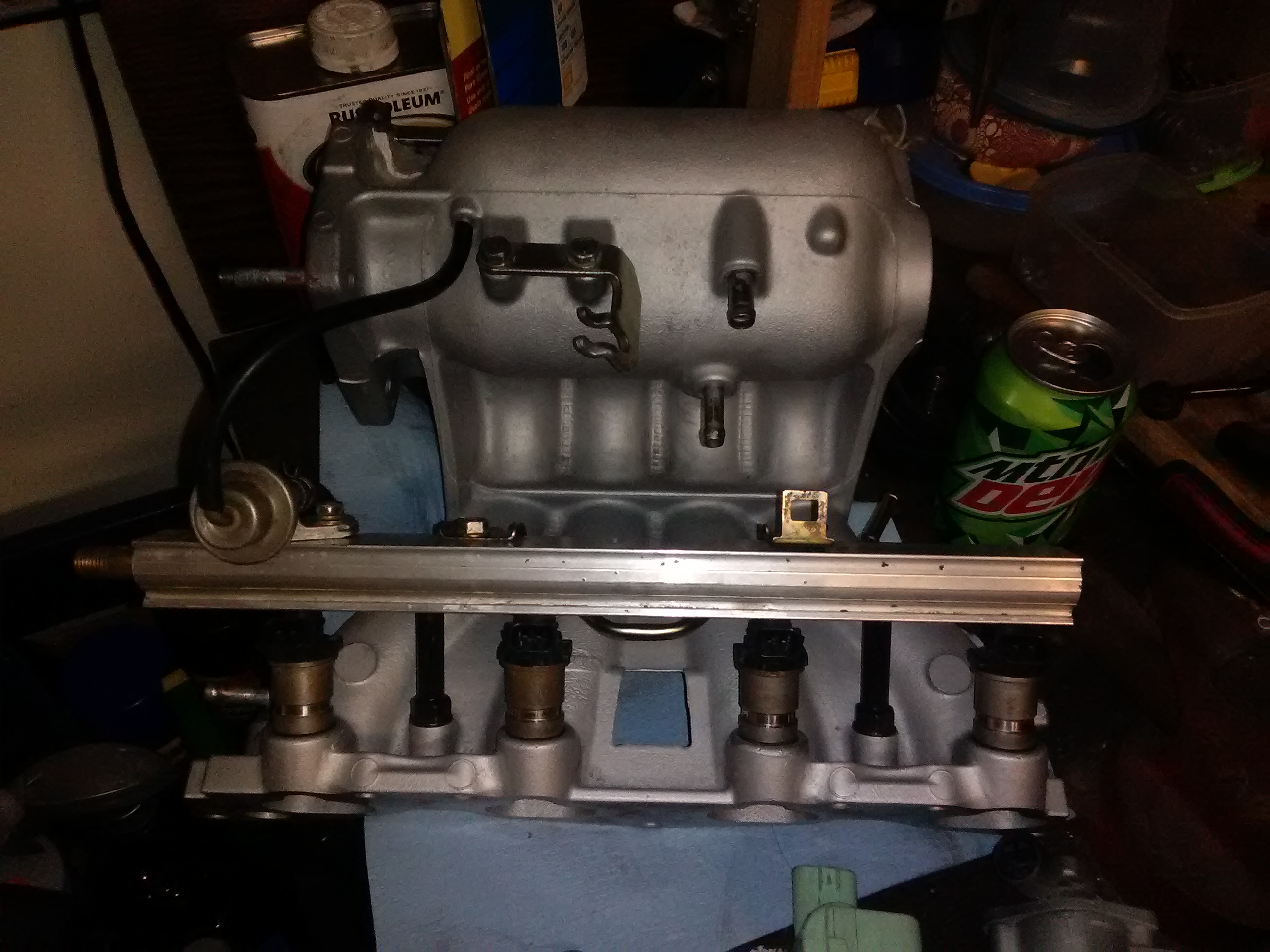

Pictures attached:
Cleaned up y8 manifold. Bought block off plate for the rear since it was off a 5 speed... the IACV with the green on it is the y7...now the other one that is sitting on the IM and wooden table is from a B18 Ls...just curious if this couldn't work...slightly larger than the y7 but fits..

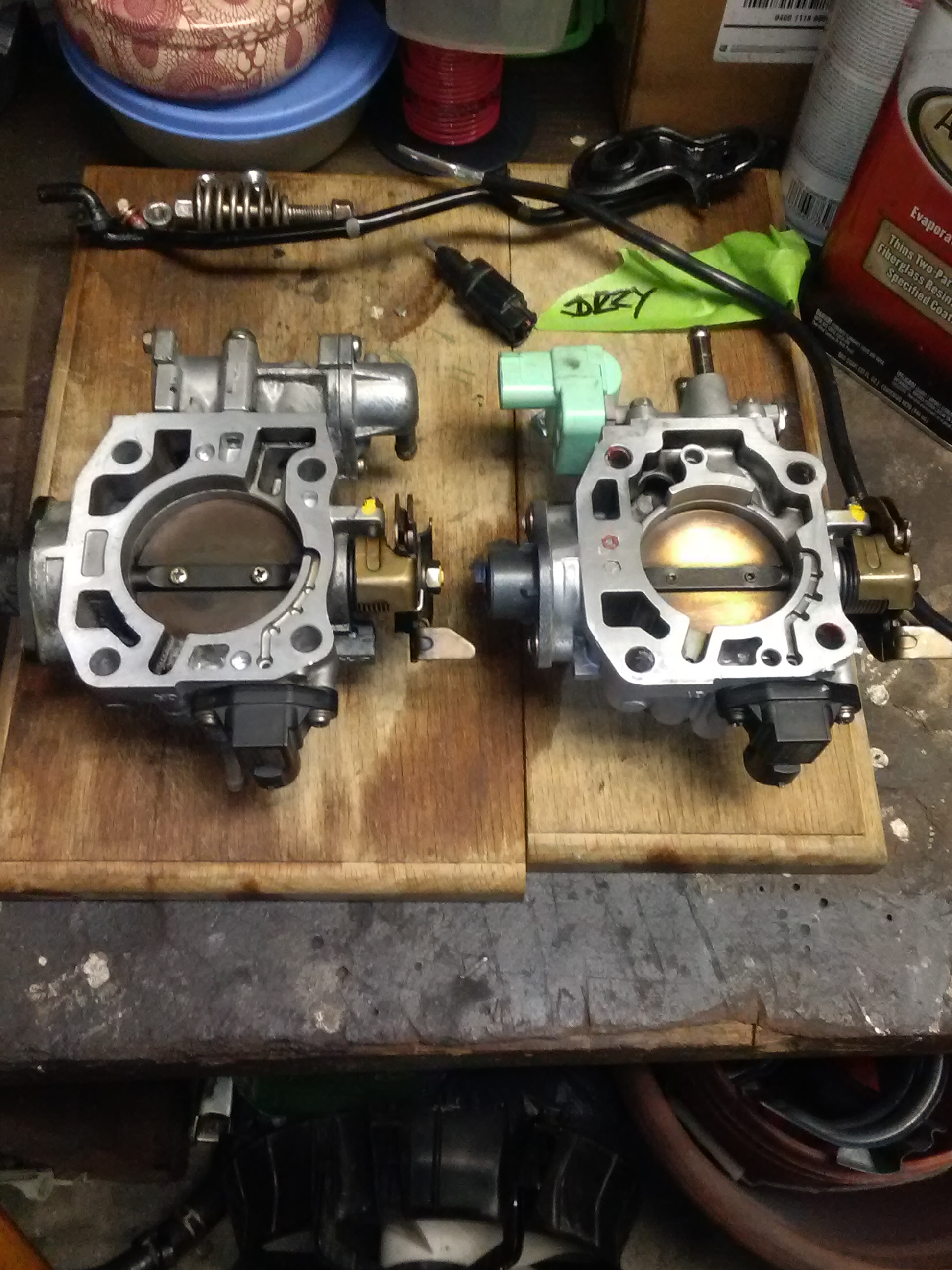

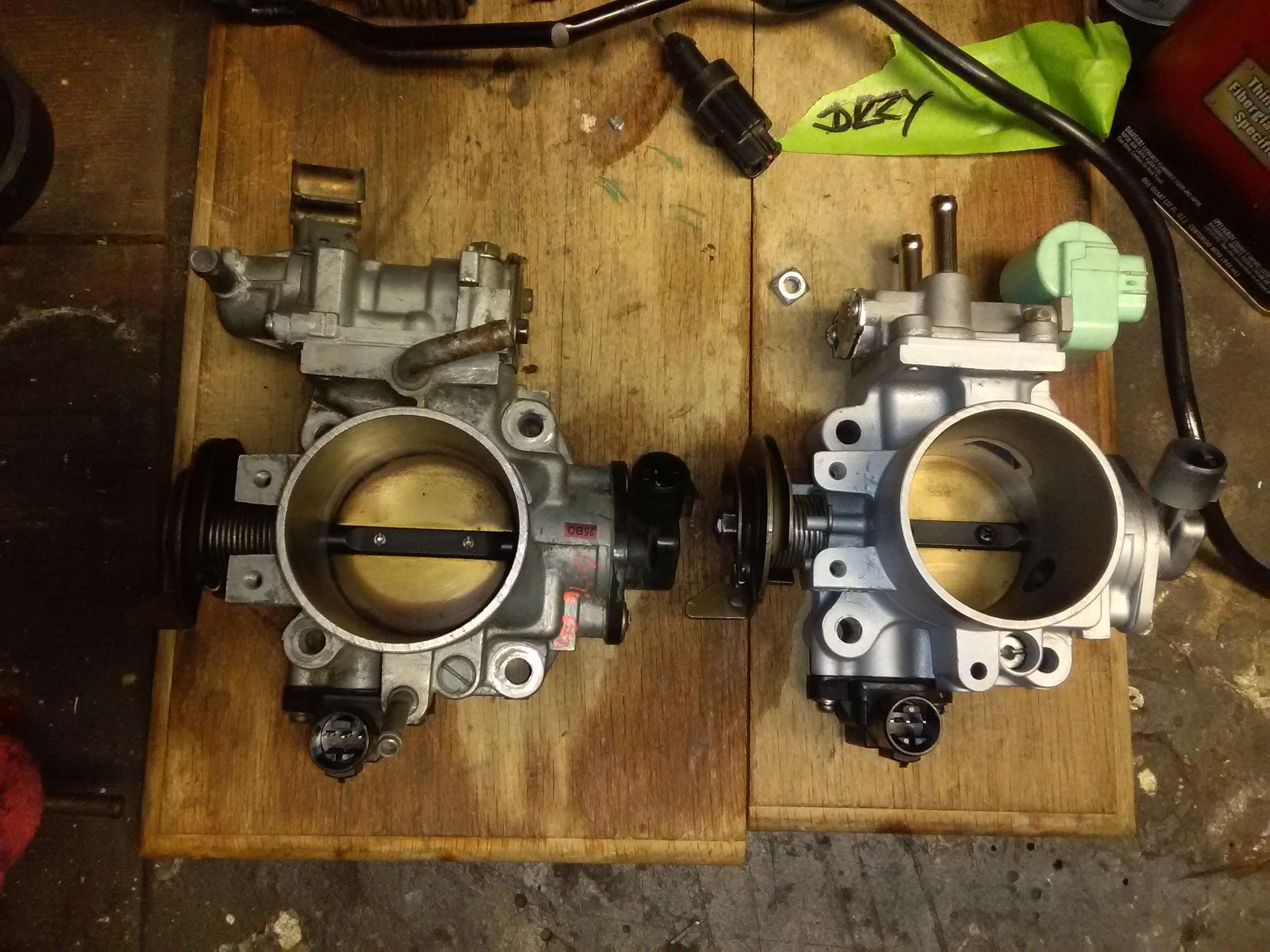

Alright, hated to spend it buy honda has a vtec solenoid in the way. Still going to yank a knock sensor as well...Doing best to avoid CEL (minus the emissions) adjusted valves yesterday since head came with them barely screwed on...Went .008 intake and. .010 exhaust those were the happy medium between oem specs... Closer I get closer I second guess my work....IE. weird TQ wrench was it Calibrated right? Did I twist dial correctly etc... Anyways to those following if any here's pictures as if last night.....Took one of my y7 TB vs b18 TB I had..... Almost identical anyone know if I could use that..Bolts right up just slightly larger etc...
Well today I'll see about this ECU double check valves And then valve cover is going on.... Also...For now o left y7 fuel rail and Injectors ( want to swap it all at same time..Maybe newer injectors high flow fuel rail fpr .Etc...I know y8s on a y7 make you run too rich...Not sure if y7s would be too lean?? Ahhh what else did I overlook??

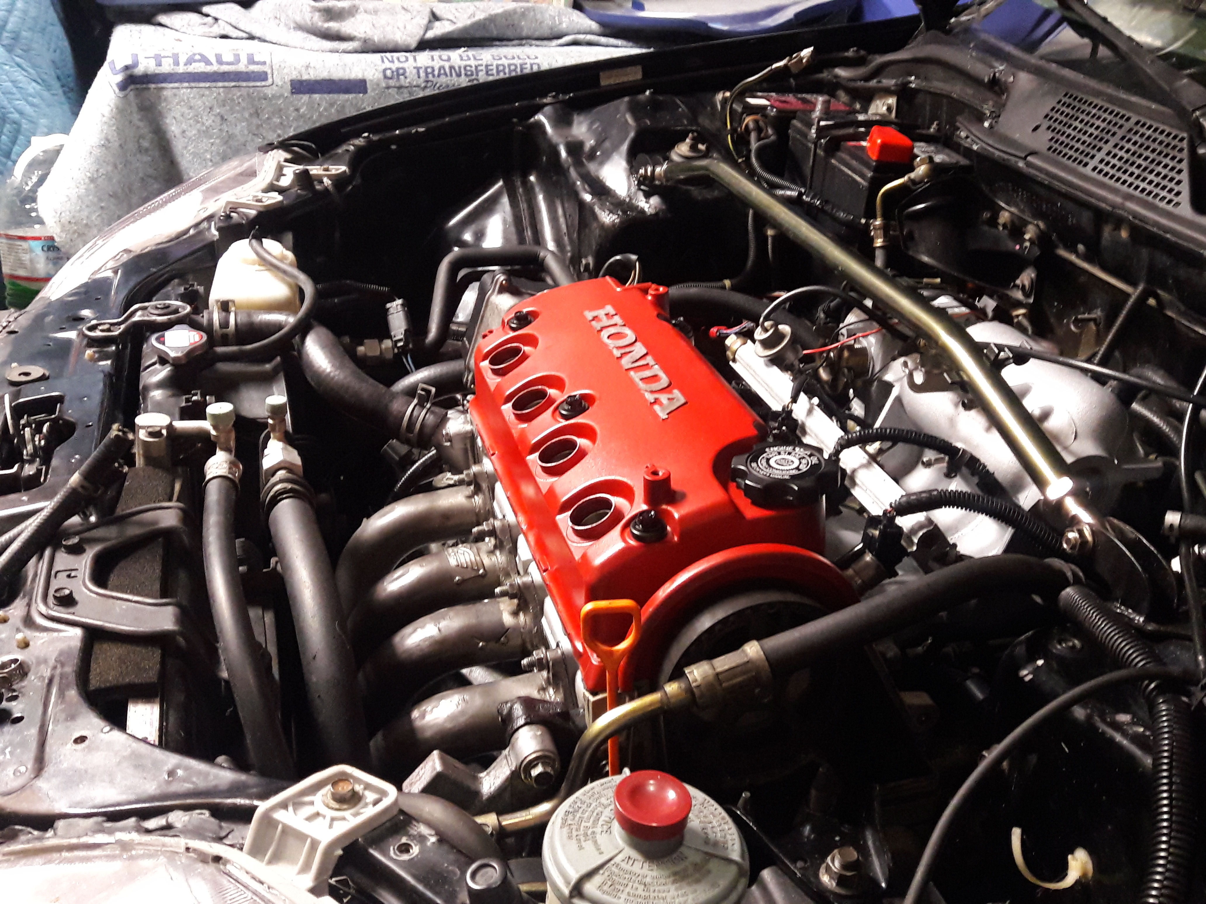

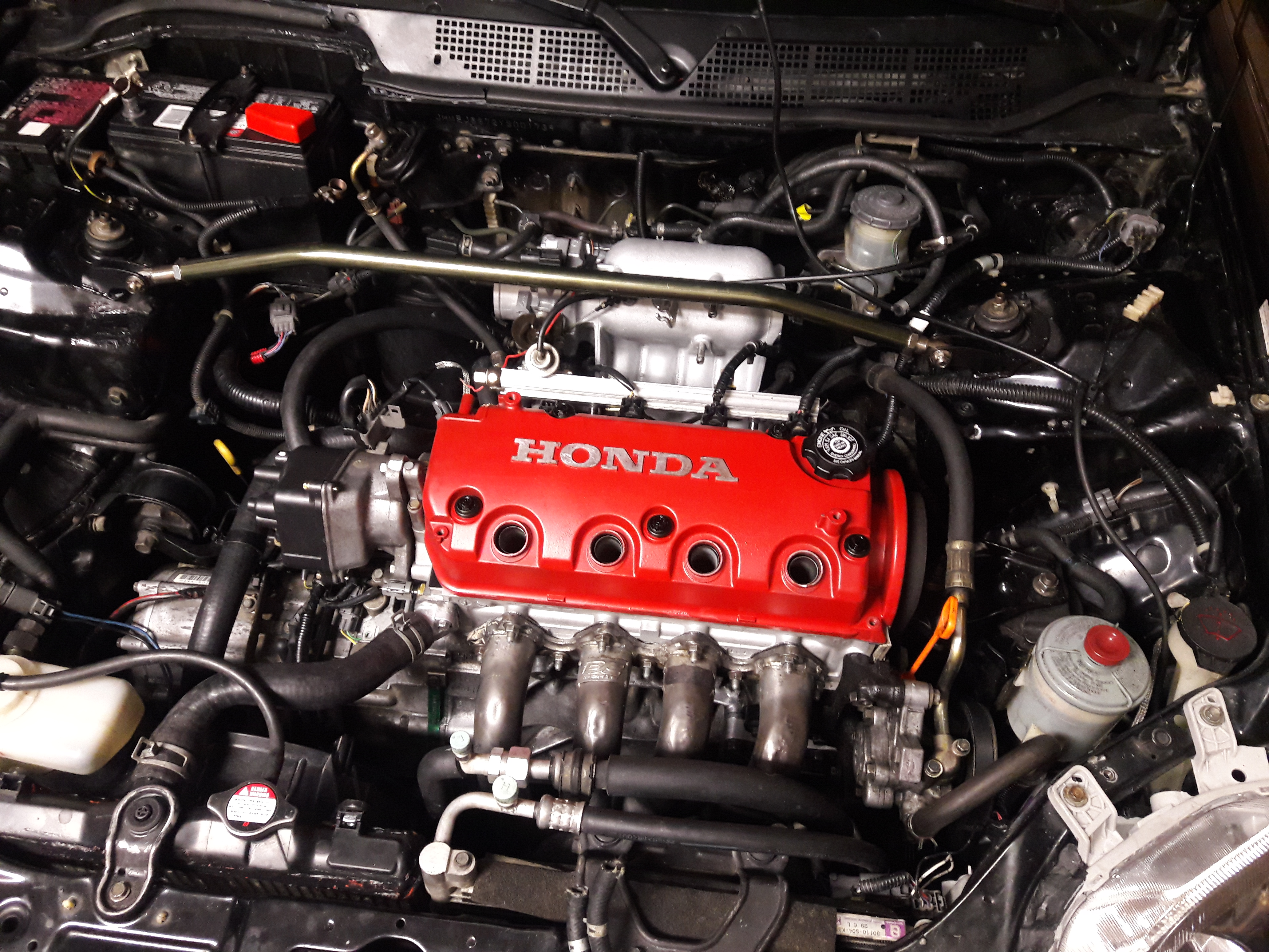

valve cover on. awaiting solenoid. scheduled for delivery today...hitting pick n pull for knock sensor and misc...startup tonight? probably not...im sure something will need something etc ha...I'd say Monday its on the road
