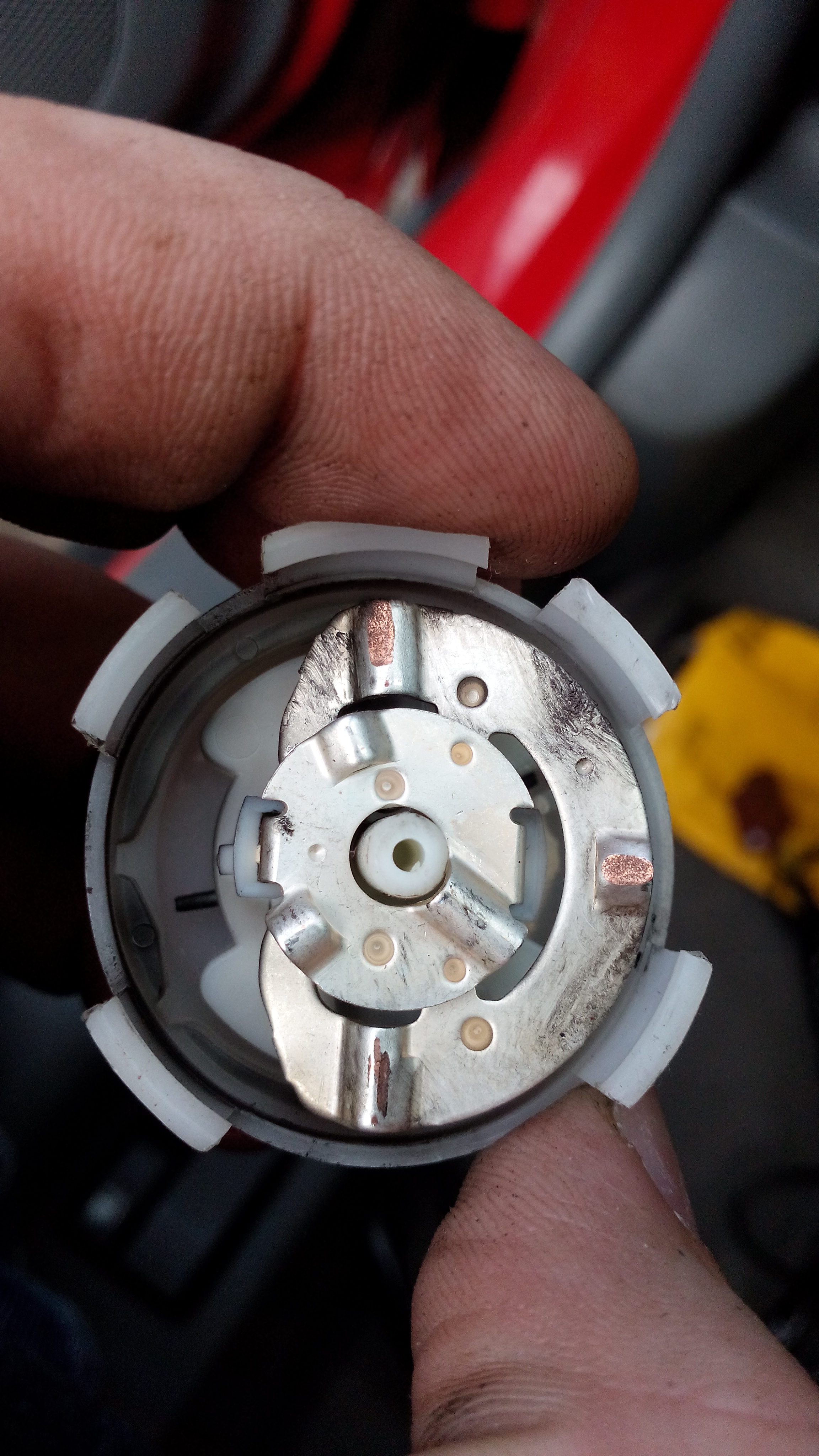

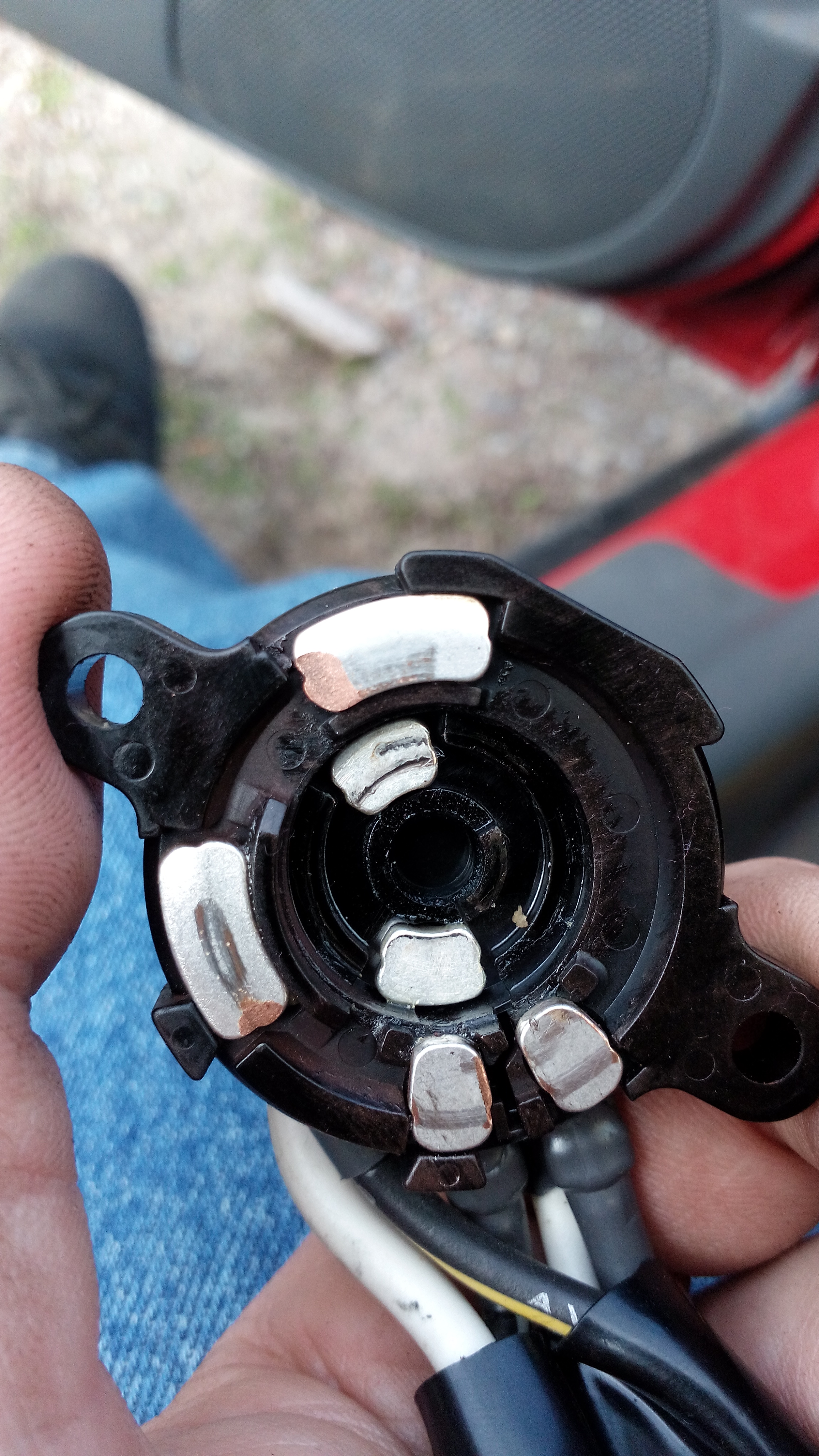

You have to rip the switch apart to see the insides. but you can test the contacts of the switch once you remove the covers from the steering column. This was in my girlfriends '99 sedan.
Here's the thread:
https://www.civicforums.com/forums/2...ml#post4713663
I bought a new switch (just the electrical part) off rockauto for a really good price. I just had to move a couple wires from the old harness to the new one.
Here's the thread:
Re: 97 Honda Civic starts then dies when warmed up
Colin42,
RockAuto is showing a switch+lock cylinder+key... the entire thing... What do you mean by just the electrical part? Just the pigtail or?
for my 97 Civic I only see the entire assembly.
I appreciate you help. Thanks for pics

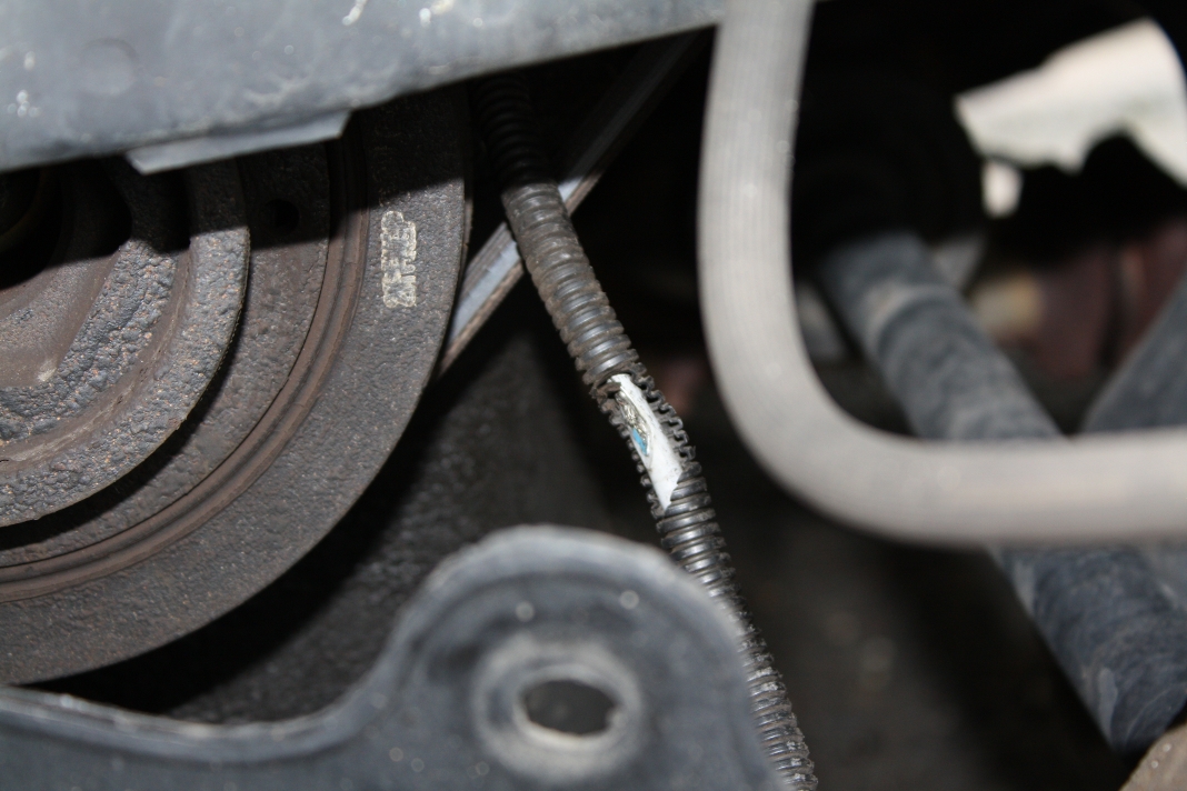

Last night I found another issue. The alternator belt rubbed through the crank position wire sensor. Do you think this would cause the car to start and immediately shut off? Or cause my car to foul the plugs?
Also - last night I disconnected my map sensor, IAC, TPS, and ECT while the car was running... Since the car continues to run without these... Doesn't it mean they ARE NOT the problem?

I replaced the Crank Position Sensor last night (the one inside the timing cover behind the balancer - I am not sure what you are talking about INSIDE of the distributor). Incidentally - it never set off a fault code but im replacing anyway for good measure.

It was the DISTRIBUTOR! that fixed my issue.
Word to the wise... just pay $137 for a new distributor... don't buy a coil and ignition module like I did.
The car idles ask good as it did when I bought it in 1999.
Good to hear it.
Now we can wonder if the problem was one of the three sensors inside the distributor would quit and not set a fault code, or if it was some different item inside the distributor that was causing the problem without setting any fault code....these types of problems really can suck.
