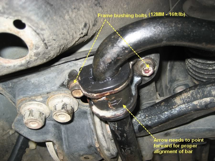

If it is the style I'm thinking of, yes they are in the K frame
Does this look like it?

That is it.

It's a Minnesota car. Do they usually rust out real bad? My sway bar mount is busted off and I feel like the only way to repair it is swap the k frame.

I think we covered this in your previous thread.
Needs the crossmember replaced....but if there's a crapton of rust in the structure the member has to attach to, it may be a lost cause.
Is the rest of the car in good enough condition to make this a worthwhile repair?
