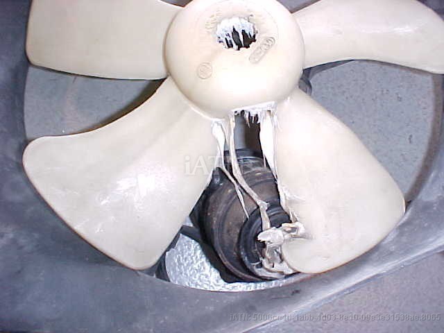

If the radiator fan and motor looks like this, it might not be much good...
Lol yeah if they looked like those pictures and I didnt know, well...I wouldnt be much good at all here trying to troubleshoot this lol

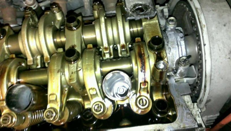

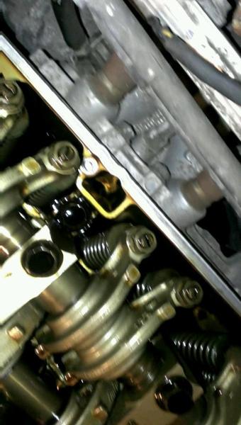

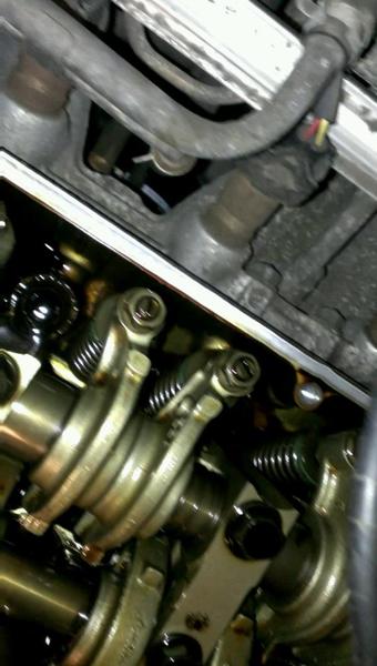

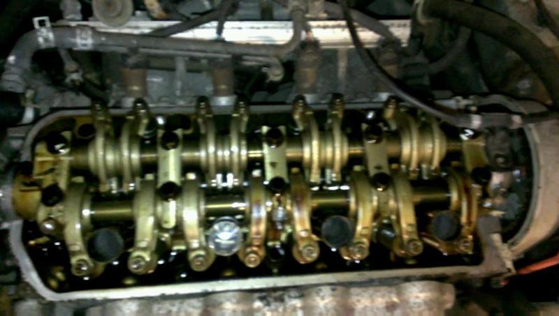

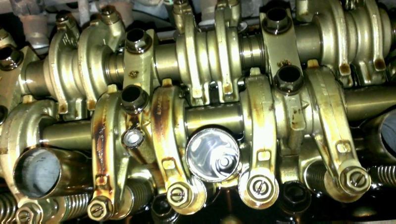

First thing I wanted to do was simply change the valve cover gasket because you could see a lot of oil buildup on the valve cover.
I was also going to change the thermostat but was wondering if it was necessary to change the coolant as well at this time.
here is a video - how does everything look. I apologize for not turning the phone sideways so, hope use can get a good look.
Sorry for the late reply but my car has not moved in a few weeks and I've been inactive because I was away on business. I had my wife starting the car up here and there and taking it for a short drive just to keep everything flowing.
There was some good pooling of oil all around the valve stems? You can see in pics effete it's all dark at the bottom.

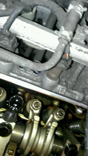

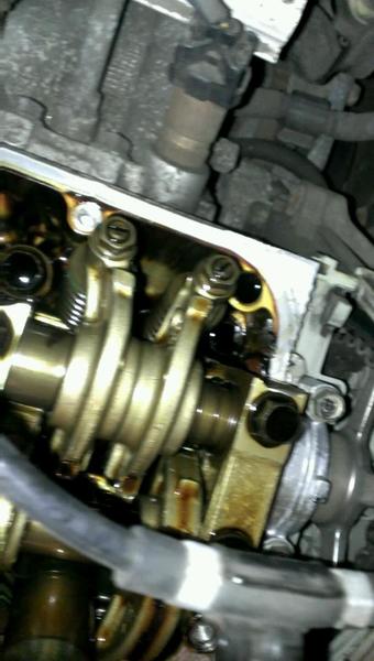

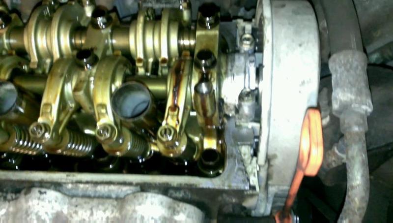

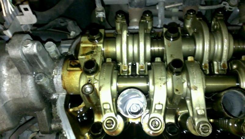

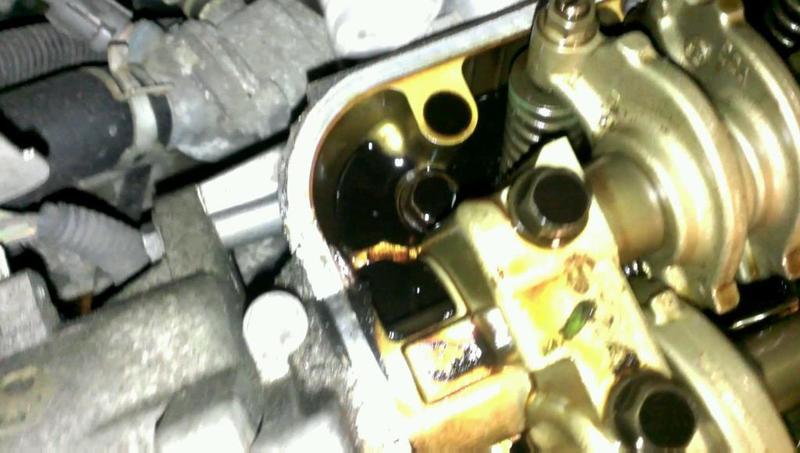

here are some shots, I hope this helps to see if anything doesn't look right under the valve cover
It would be an ideal time to do so.
Um, now I know what Stevie Wonder feels like at the movies.
Looks average to me. Yes there is supposed to be oil all over there.
Yeah after all of the spilling and refilling I've gone through last month, I thought so too.
lol come on...it wasn't that bad haha I didn't know what else to really take pics of and it's the best my phone could do heh
Yeah that's what I was trying to say. It looks pretty good with all of the oil pooled up and not dry or anything like that. So even with the buildup of oil on the valve cover, it's doesn't seem to be burning oil as everything looked fresh under the valve cover, dipstick I check regularly and always looks clean.
Unfortunately I had an expected call today so, the thermostat will have to wait. I'm still crossing my fingers that is what the problem is. Ever since I stopped using the ac (noticing this was the only time the problem occurred when I turned it back off), the problem hasn't shown until last weekend. It was a pretty hot day and just as I was parking the temp gauge went up and then cooled back down. I swear this sounds like a thermostat on its way out and for $20, even if it is not the problem, it could use a change because I had to swap it out for 3-4years ago.
