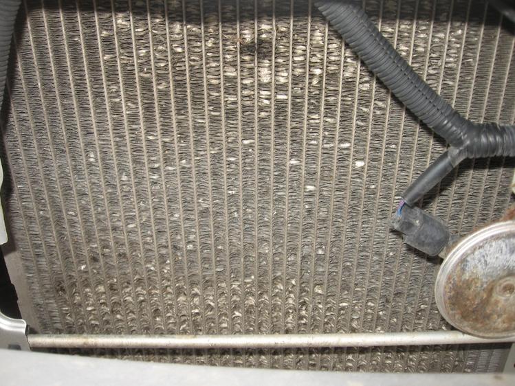

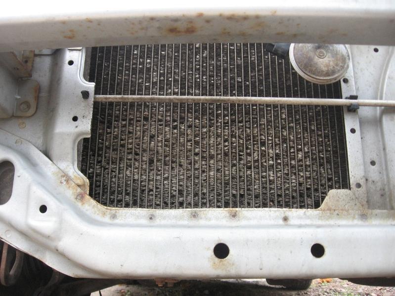

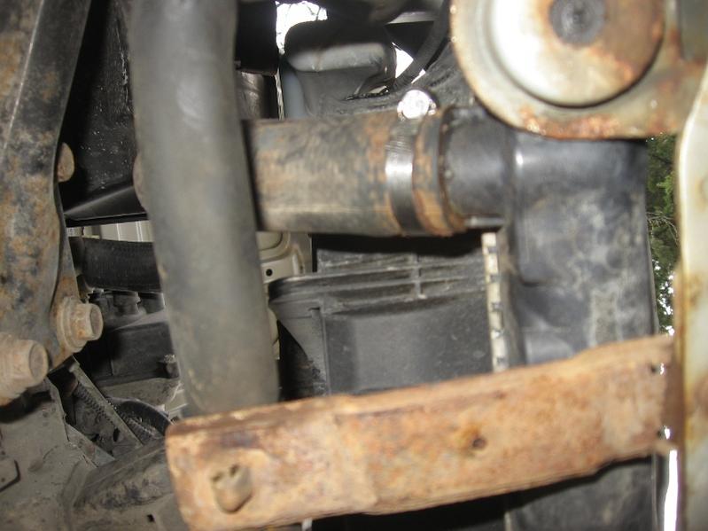

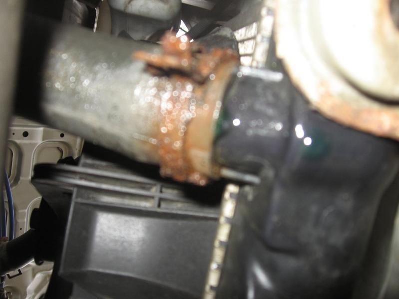

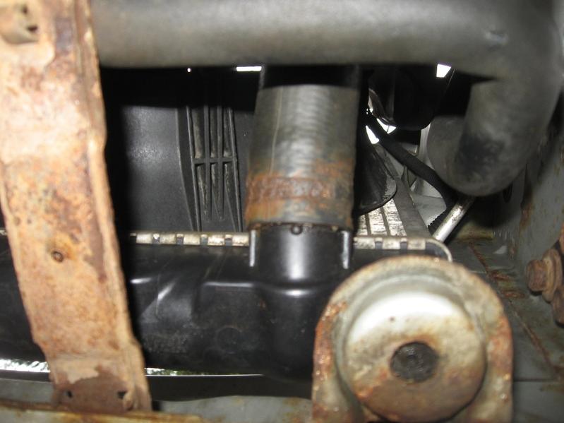

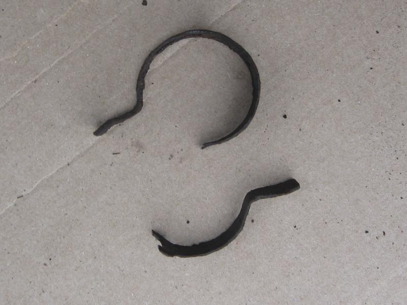

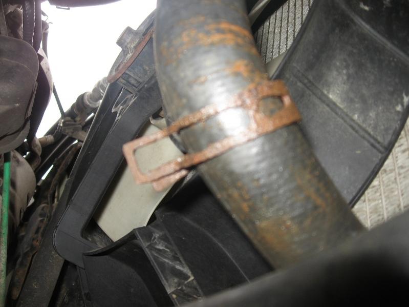

Here's a little heads up for anyone who owns a 6th gen Civic. I've had this leak going on that I haven't been able to pin point for the last week or so. I first noticed just a tiny little spot underneath my car where I park at work. It's my spot so I knew it must be from my car but after inspecting on more than one occasion I just couldn't put a finger on what it was. Wasn't oil and it's a very wet time of year and it just seemed like moisture running down the inside of the plastic bit on the front bumper. Well, I got to work yesterday and noticed that the patch was considerably bigger so I look under and see blue liquid dripping...coolant! My heart sank for a second and little panic set in. Crawl under as best I can in the 15 minutes I had before work. It seemed that the clamp on the lower hose had gotten rusty and cut into the hose... no huge deal...deal with it later. So I've just finished working on it and it turns out the lower clamp had just rusted and fatigued over 15 years....every time pressure built in the cooling system it was pushing past the clamp. A sneaky leak! I literally snapped the old clamp with my fingers with not much effort. So I've just finished putting a new O clamp on it and brought the car up to operating temperature making sure that the cooling system is functioning properly.... Tstat opening , fan coming on, coolant pushing into the reservoir. I've got some cardboard underneath and giving it some time so make sure that is the source..but so far no other signs of leaking.
So if your a DIY mechanic like me the next time your under your 6th gen take a look at that clamp. It could cost you an engine/head gasket if you're not paying attention.
Sorry for the crappy pics....I really wasn't into doing this today...
...and oh yeah, ezone...what do you think? Time for a new rad pretty soon? (15 years old)

Looks like a lot of road debris has folded up the tiny fins over the years.
That isn't as bad as some I have seen, by any means.
I've seen the tiny fins completely detached and coming out from between the tubes too.
I'd wonder when/if the top tank will crack.
Replace? Up to you. Is it a problem yet?
Will the car last that long? There's a lot of rust there......
A lot of people can't justify the expense before it's absolutely necessary, some people can.

Re: 99 Civic lower radiator hose clamp issue
Common?
Twice today I saw a whiff of steam come off the top. I assumed it was just because I'd taken the cap on and off a few times and a few droplets had spilled. I'll take another look tomorrow it's dark already and I'm really done the cars for one day. What should I be looking for? It seems to hold pressure/liquid fine at this point.
You really think that's a lot of rust?
Old Nov 6, 2013
The 2 most common radiator failures I see here are
The nylon fatigues after so many thermal cycles and cracks (rather suddenly) in front, directly where all the hot liquid hits as it comes out of the top hose from the engine,
or the thinnest area in the tank, which could be the flat pad molded in on some radiators for a label. Couldn't find a good pic quick though.
I'm in the rust belt and I rarely ever see hose clamps wasted like that. I kinda figured the rest of the car can't be very far behind.

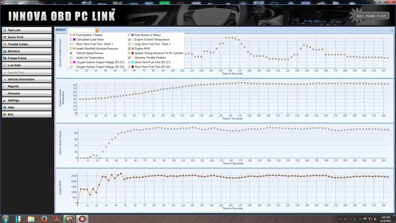

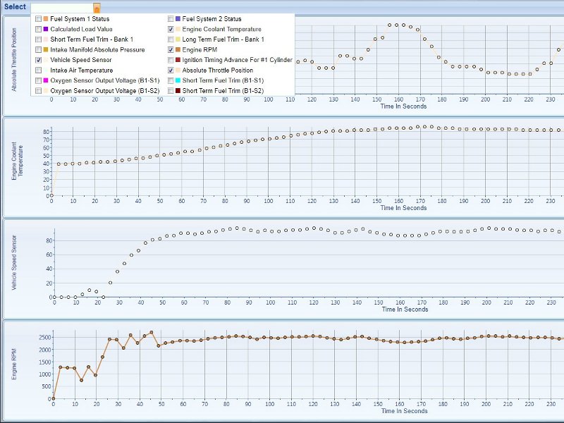

I did another inspection on the top of the radiator today and everything seems fine. I plugged my OBD II scantool in before I left for town today and did a 320 sec live data capture. My coolant seems to hover around 84C (184f) and it seems the Tstat and fan doesn't open/come on for a 20 min drive on the highway. I touched the lower rad hose and it was cold at the end of 20 min (it's 0C(32f) ambient today). Is that normal? or should I look at a lower temp Tstat? I did test the entire cooling system parked in the driveway yesterday and the Tstat does open and the fan does run....it's just not getting hot enough on my daily drive. I literally go out my driveway on to a 100km/h(200mph) highway and pretty much stop/turn it off within minutes of getting off the highway.
Old Nov 8, 2013
...to get back somewhat on topic....
Did someone turn the lights off?
Good.
Yes it is, and you don't need it.
Tstat is regulating the operating temp as long as there is ariflow through the radiator. You're driving at highway speed in the cold.
Fan is not needed until coolant temp gets to 200ish, or whatever temp the fan switch is rated at.
Stat regulates minimum operating temp, fan regulates the maximum. (after warmup).
All normal.
The job of a radiator is to ___________?
Is the radiator doing that job?
(HINT: It's working perfect.)
No no no.
What makes you say that?
If it gets to whatever temp your first line said, it's perfect.
But you have to be running long enough to reach that temp.
No big deal, I wouldn't mash the pedal and do redline runs when it's cold though. (And that car won't go 200 MPH).
Why did that feel like a burn? lol

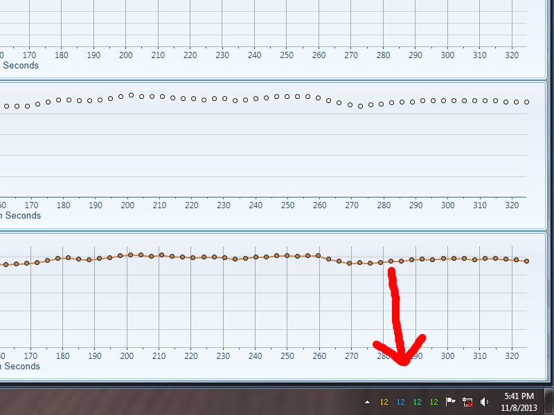

cool, bit paranoid I guess, I always thought normal operating condition was the engine getting hot enough to open the Tstat regardless of ambient.
My car spends 98% of its time between 2000-3000 rpm and it has never seen redline under my ownership. Do they not tell Americans all Canadian Honda's are turbo and push 300hp? I can see why they wouldn't.
little eyecandy...

lol, yeah I know small pic...
I have a pretty nice 27" monitor and it's still just readable....
just been playing around with my OBD II scantool the past couple...
....no sense in having tools if you don't know how to use them
I was trying to make the computer geeks jealous as well when they saw my PC running at 12C....my PC has a radiator/block/pump as well
