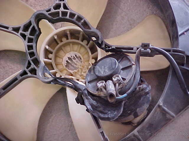

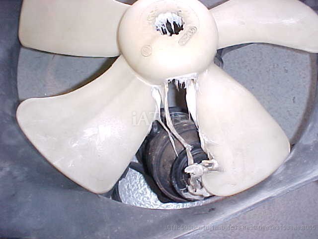

Fan blade won't spin freely? LOUD? Spins but wobbles? Melted center? Junk.
Here's pics of an extreme example of really bad one I fixed a little while back:
Most failures are not nearly as obvious as this.
