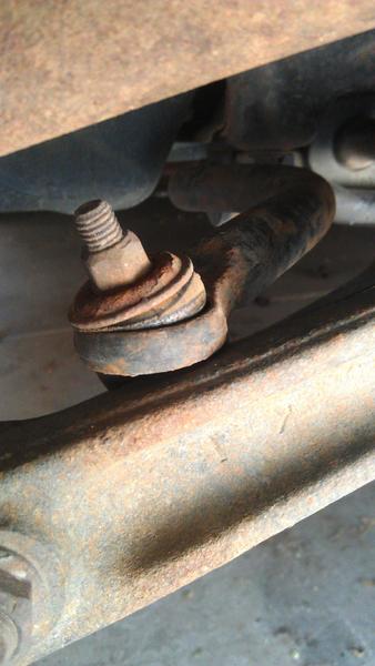

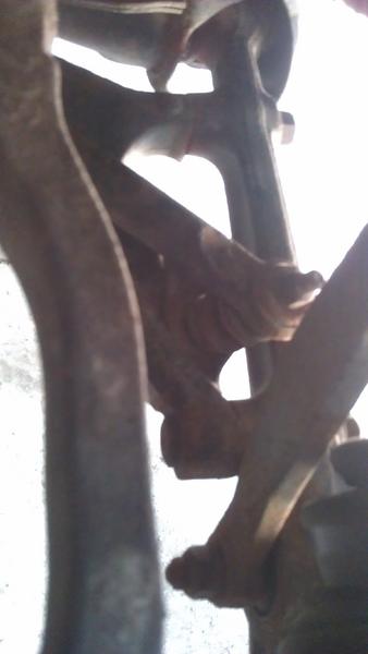

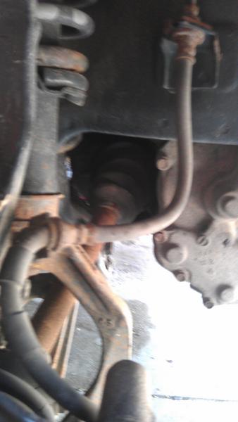

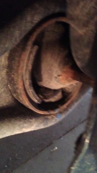

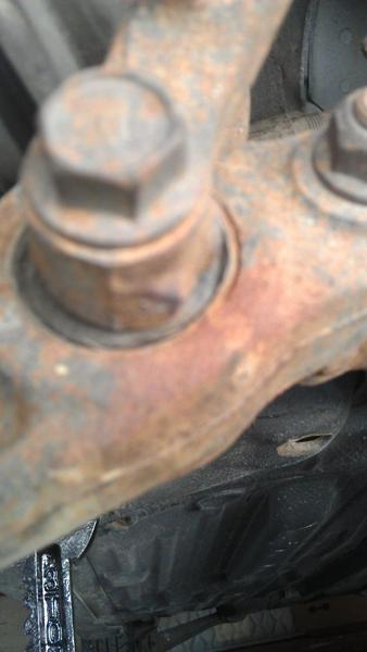

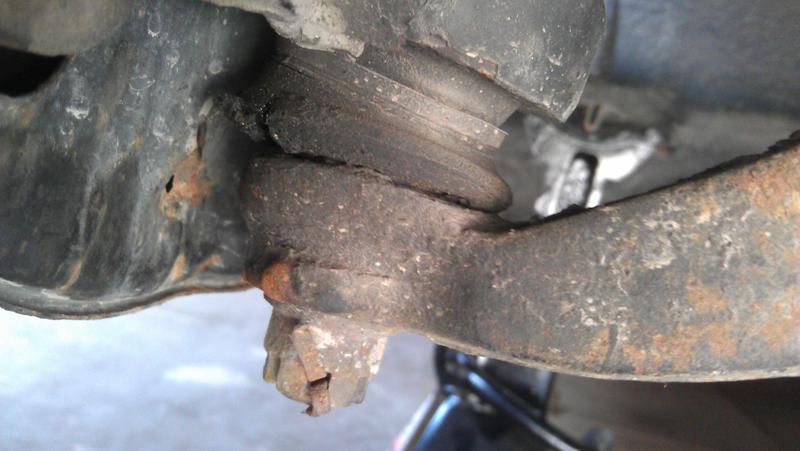

so i ran into a curb earlier this year and i bent the front part of the lower control arm back into the sway bar end link. The axle is leaking grease and the lower ball joint is leaking grease. I also think the trailing arm bushing is bad on the passenger rear, it squeaks bad when going over bumps, plus the rear end wants to walk out on me.
My question is how reliable would a junk yard lca, axle be?

The ball joint is mounted in the knuckle, but you can probably get a rubber boot for it if you look.
A JY LCA would be fine as long as all of its parts are good. Better than your bent one, at any rate.
You can get axles for $50 all day long at the ChinaZone and others.
JY isn't worth it in most cases.
Rear end stuff? Gotta look, gotta find if something is loose or if you bent something back there too.
HTH
