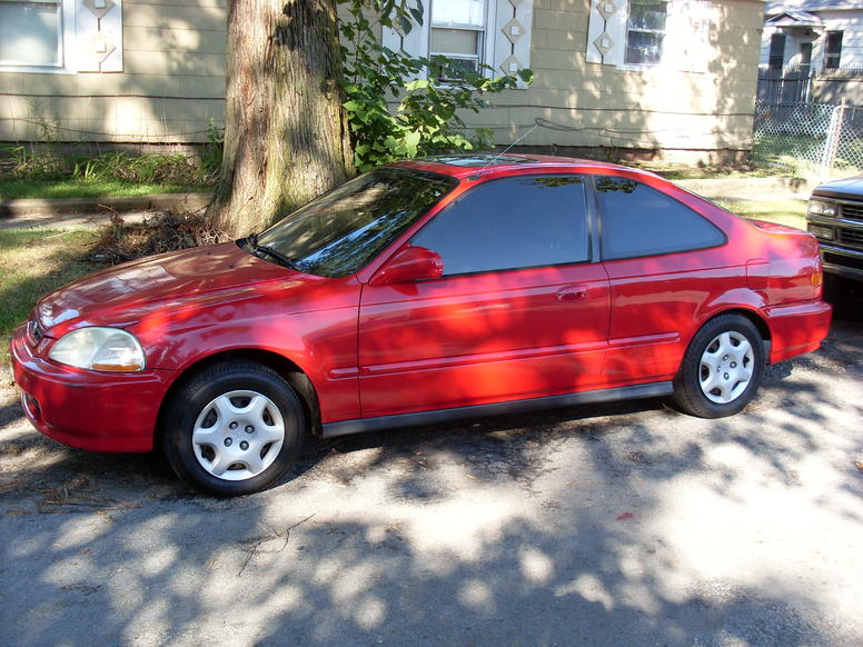

Hey guys. New here. I have a 98 Civic Ex 1.6 non-v-tec. This code keeps popping up from time to time then will go off after a few hundred miles. The last time I scanned it with my buddys scanner that is the only code that popped up and I did a full system scan, he has a pretty nice set up, so anyway when I was done I cleared it and it came back on 300 or 400 miles later. From the research I have done it seems like a pretty vague code. I figured you guys on here have come across this a time or two and was looking for some insight.I do know that the gas cap was replaced shortly before I bought it. BTW, it is completely stock if that helps.Any help is greatly appreciated, Thanks.
