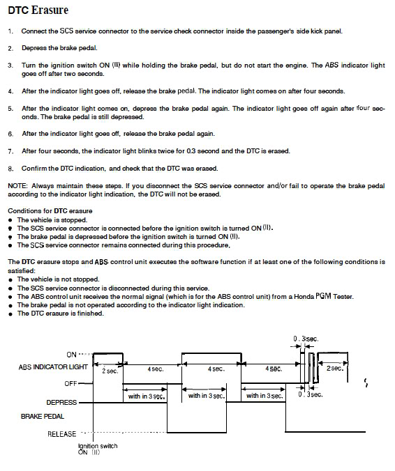

Re: 98 civic ex, abs light problem.

ABS is anit lock braking system, not sure how someone sitting in the back seat would set it off but hey wierder things have happend..try to get the abs code when it comes on using the above procedure let us know what you get.

Gunner: Nice chart.
