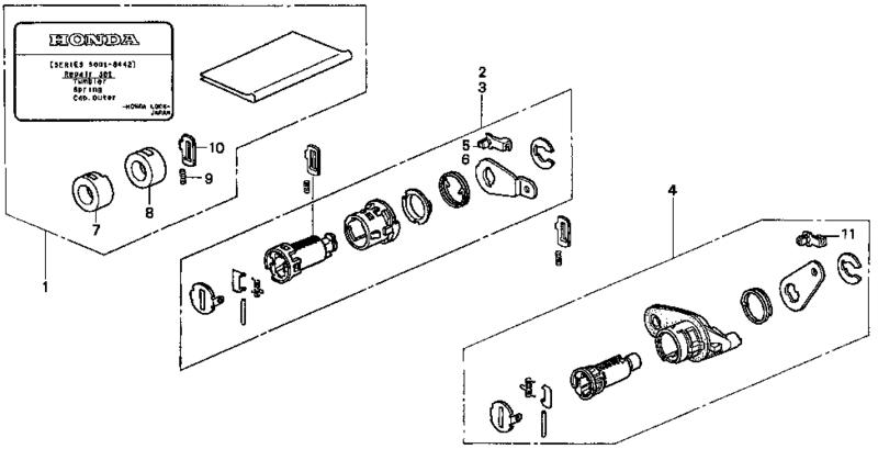

Here's a diagram of the key cylinder (from hondapartsnow.com), and a DIY from eHow:
http://www.ehow.com/way_5513540_hond...r-removal.html
Have fun taking it apart, keep us updated
