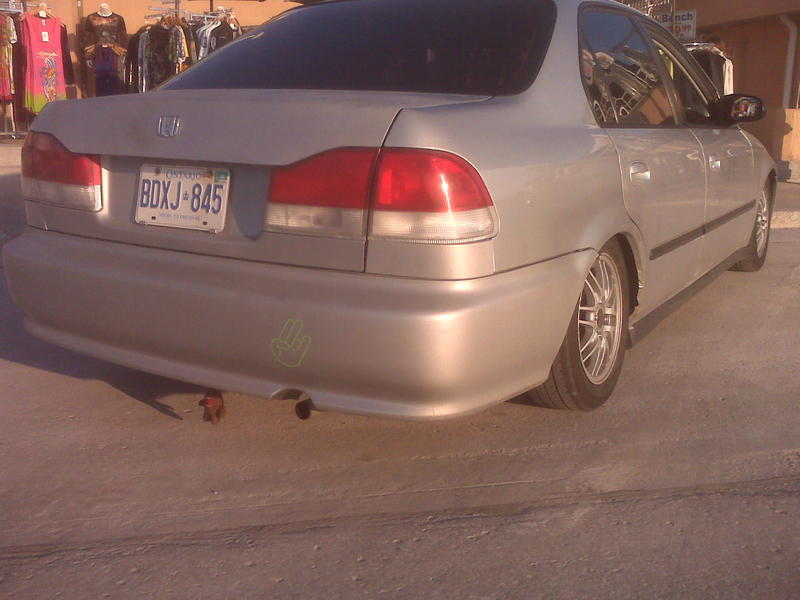

it will fit !! i have done it on my civic i will attach a photo it is very easy aslong as you have common sense with basic electrical stuff lol
i have more pics here ask me any question you have

yo im from canada so im probably the best to answeer question here, soo i made the swap of the 1.6 el trunk on my civic 99 lx sooo yeah the sedan one, it fits bolts on but, u need to get all connectors for lights from the 1.6el trunk, cut all your civic connection and do the connection with el connectors (light socket) and for the trunk light u will need to pass another wire for the brake signal cauz on civic brake signal is only on corner lights, whatever tomorow ill take picture of my setup and send it here sooo it may help a lot of u american dudes !!! Hope ill help u all with thoose 1.6el question, btw the parts for 1.6 el are almost all the same as civic 99-00 suspension is the same, i think rear lower control arm too, ill check on my friend el tomorow too and tell u all thoose ****, whatever, see ya
