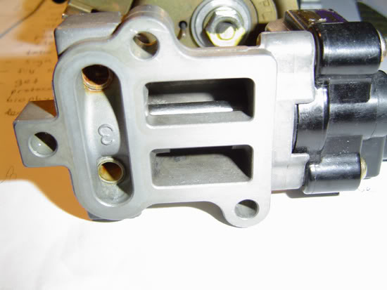

well there is a big difference between idle stall (rpm drops low and then recovers) and idle fluctuation (rpm goes up and down randomly). if your idle is just dropping low and then coming back to a normal level, its prolly an idle air valve problem (IAC). if rpm jumps around from 500-2000 rpms back and forth, then its a tps issue. i would clean the idle valve first, which is the small piece on the throttle body with two coolant lines feeding it. take the radiator cap off first to depressurize the cooling system, then remove the valve and clean with carb spray cleaner.

yeah its not idle fluctuation its idle stall. and can u be more specific where that valve is? pics?
Old Jul 2, 2010
Re: acceleration lag!!!
its the piece with two coolant hoses. you will know when you try to remove em cause coolant will come out. if nothing comes out, its a vacuum line and you have the wrong sensor. its the lower left thing in the pic #9.

its the one right behind the throttle body right? i took it off and theres 2 holes and one has a screen right? i didnt take the lines running to it off tho. ended up i didnt have carb cleaner lol. but i just threw some fuel injector cleaner that also cleans the intake valve when i filled up today. as of right now seems to be ok. guess im going to just have to wait and see. thanks for the pic tho man

yeah try to spray carb cleaner in the ports. it is an air port so fuel additives will not reach there. you may also want to replace the screen gasket if the old one is flat and not sealing.
this is what my 01-05 iac valve looks like after cleaning.

so spray it on the valve or into the ports on the throttle body? and there should only be one screen gasket right? and where would i buy it at?

you can get the gasket (#10) from honda, but only if its not sealing right. you want to spray mainly into the iac valve ports, where most of the buildup is. you can spray the throttle body side too, but its better if you remove it first.
