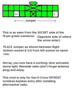

If theres an aftermarket stereo you CAN make the dome light work. I did it, it requires you to take out your aftermarket stereo. will post pictures to help.
Pull radio out and look in the cavity where it was, you should have a 16pin gray connector (radio related) , a disconnected 22 pin green connector (security system, not used) and a disconnected 16 pin green connector.
The disconnected 16 pin green connector needs a jumper installed from pin 8 to pin 14 to complete the domelight circuit and fix the issue. Refer to photos for more info but basically put a jumper between the far lower right socket and the 3rd from left socket on same row (bottom row). That should give you your, door activated, dome light back.

Worked like a charm for me on my 98 Honda Civic EX that no longer has its factory radio installed.
Thanks for posting that fix.

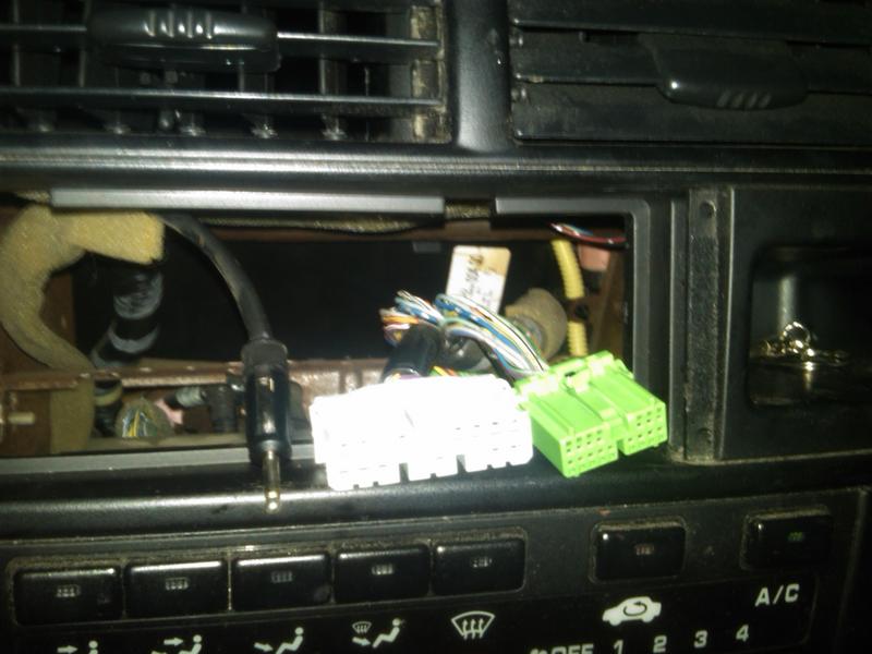

Sorry for the thread necro, but i have a very similar issue...
I have a 1998 Honda Civic Sedan. Base model. I just removed the factory radio in preparation to install an aftermarket radio. As you can see from the picture attached, there are two stock sockets: one grey, one green. I assume that green is for the keyless? I bought the car used, and I never had a keyless fob. So, how can I tell if I have keyless?
Should I try to keep the factory radio in-line and maybe get an aftermarket keyless fob after all this time?
Is there a special harness I can buy to make installation easier?
Thanks to all!!

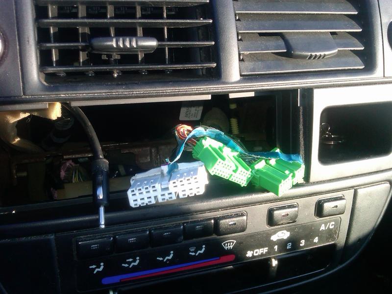

ok, update!
I found a third green socket inside the dashboard.
New picture attached.
