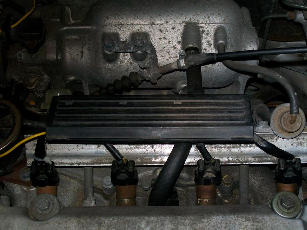

How do I remove the injector wires cover - the plastic one, right behind where the injectors are?
I found one tab clip on the drivers end but that's all I found, and the cover doesn't want to move. I know this should be obvious and simple but - - what am I missing??

You need to release the spring clip that holds it on. Yes it's simple but you just need a tiny screwdriver to pop them off first .

Where is the spring clip hiding?
I saw a couple small rectangular holes near top center of the cover cap. That it??

Where is the spring clip thing?
Pic of the cover cap:
Don't see a spring clip yet. Maybe tomorrow in daylight but I dunno.
I found two release tabs on the top, towards the rear. And the one odd one on driver's end. With those released it moves some, but still something holding it in.

Sorry, haven't been on-line. The clips are visible to me barely in the picture as they are mostly hidden. They are at the base of the gray clip, away from the wire end. They go approximately 75% the way around and the ends are accessible (on the opposite side of camera) with a very small screwdriver. You'll see them in daylight.
Sorry again it took so long!
