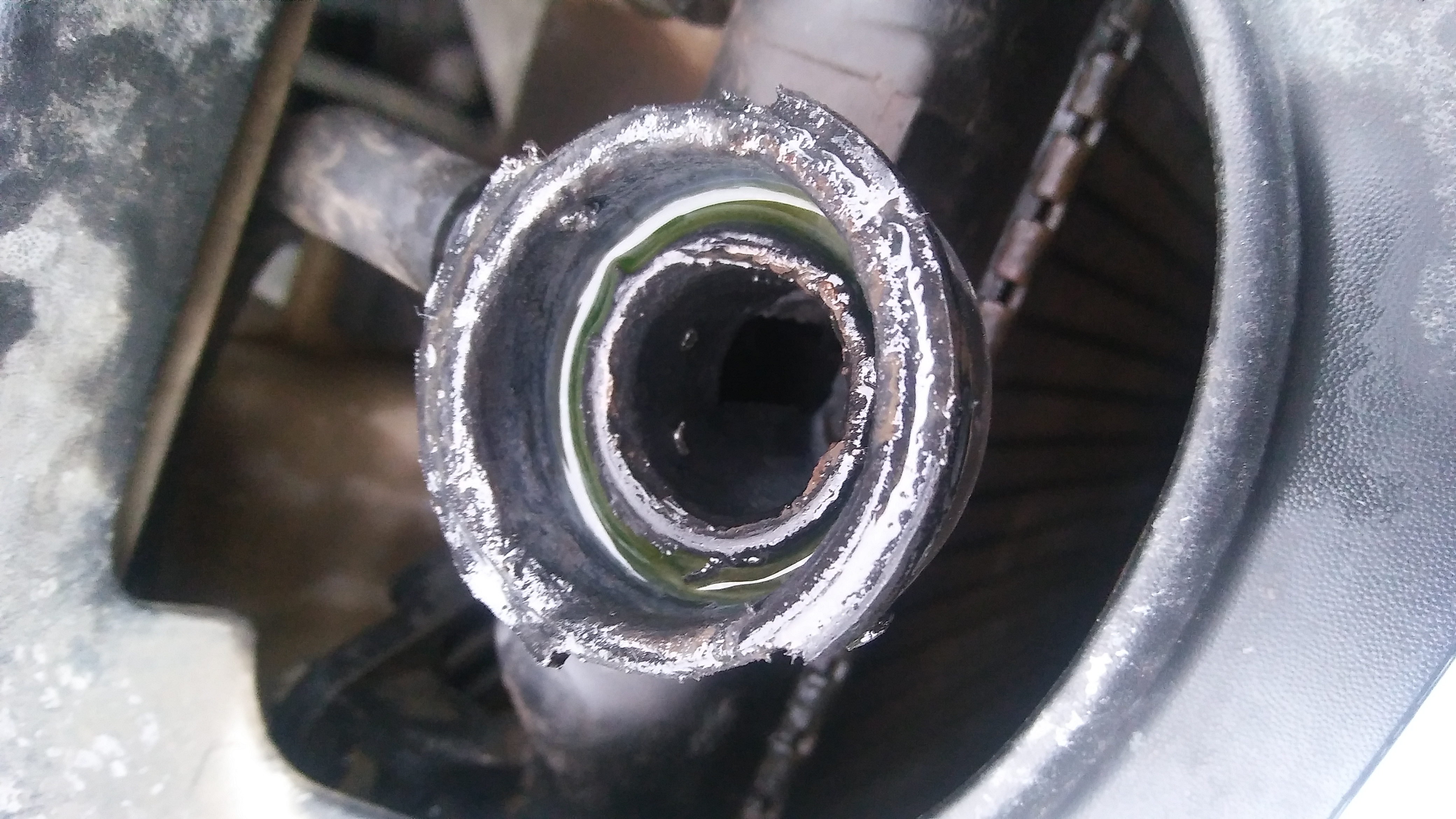

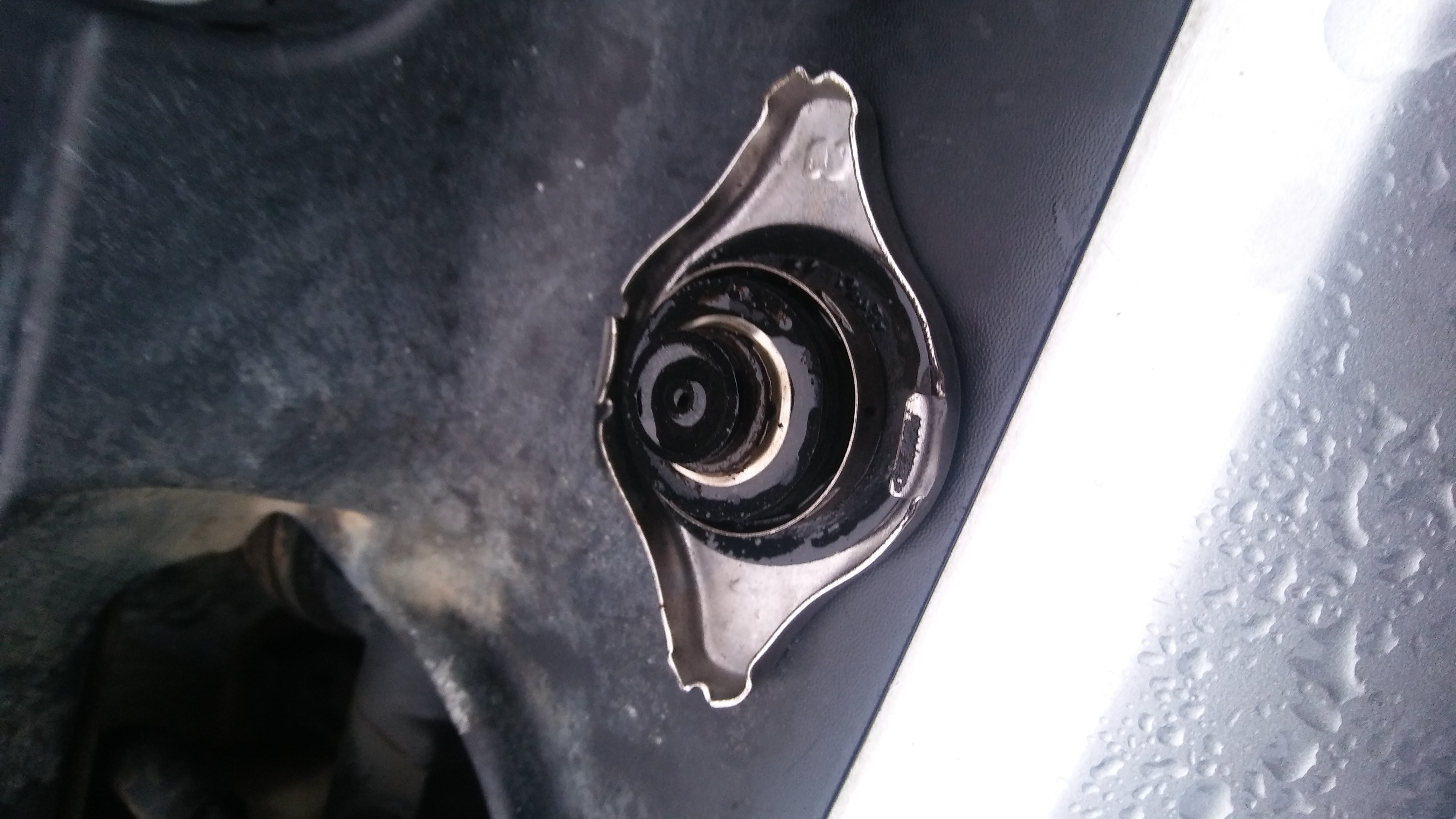

Update.
I filled the radiator back up with coolant, then I got a turkey baster and took out the excess coolant from the reservoir. So far, there was no smoke, but a slight leak of coolant can still be seen from the cap. This is after a 15 minute drive.
These are pictures of my radiator cap and radiator opening

You know what, this cap does look like the original one that I had. And the lips are longer as well. Mine had a black covering on it, but I cannot seem to find one.

Cap:19045-PAA-A01 (Denso)
Cap Cover: 19047-PLC-003
HondaPartsNow: https://www.hondapartsnow.com/parts-...nso.html?PNC=8
Or call local dealer for price.
You didn't give your car's year or model but all '01-'05 models most likely use the same cap and cap cover.
Longer lip is just OEM (Denso) vs. aftermarket and not OEM vs. OEM as there is only one type/length.

In your picture it’s clearly evident that the radiator is junk now.
Before you just replace it, you should trace down why your overheating else your just gonna pop that hose off again, and or create a super steam event again and ruin the next radiator.

im not a certified tech.. but to me it looks like that radiator fill neck part is un-usable. meaning no good.

Re: White Steam Shooting From Radiator Cap
That radiator is effin wasted.
It looks worse than the pic I posted earlier.
Next question to figure out:
You said the head gasket was already replaced.
Has that been damaged now? A single overheat event can ruin all that work.

Not sure how long ago the OP purchased this car but it almost looks like someone (prior owner or mechanic) poured in a bottle of the Devil's Jizz at some point.

Since the sealing surface in your radiator neck is gone, your system can not achieve good pressure and now your likely boiling at 212 which is normal driving range.
To to answer your main question, your seeing steam coming out because your radiator is perished and no longer letting the cap seal correctly.
Before you replace the radiator I suggest you do a leak down test to make sure your current head gasket is not leaking.
