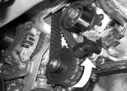

Interesting - looks like it would be really awkward to ensure the belt doesn't jump or move the cam gear and trying to get the spring off/on would be a pain.

The spring still has to be hooked up, think you can accomplish that without pulling the upper cover?

Maybe if I had an upper cover like this - LOL
Definitely would be working blind trying to fish that spring up onto the post but seems 'possible'.

After replacing my timing belt I don't think you it can be done without removing the top cover. Also at first start up my car ran rough and I thought I ****ed my motor up. turns out I missed a tooth and had to open her back up to fix it.
