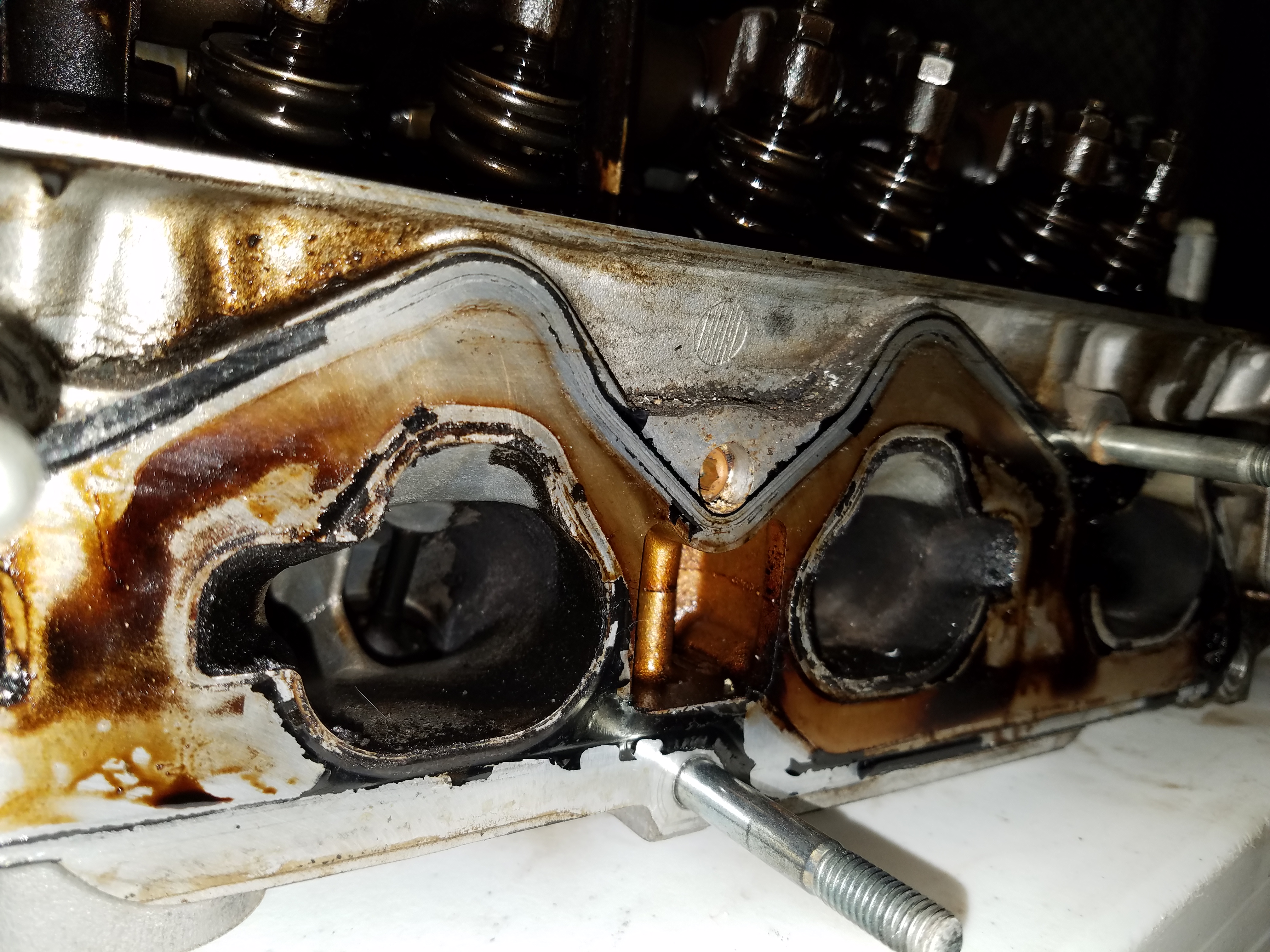

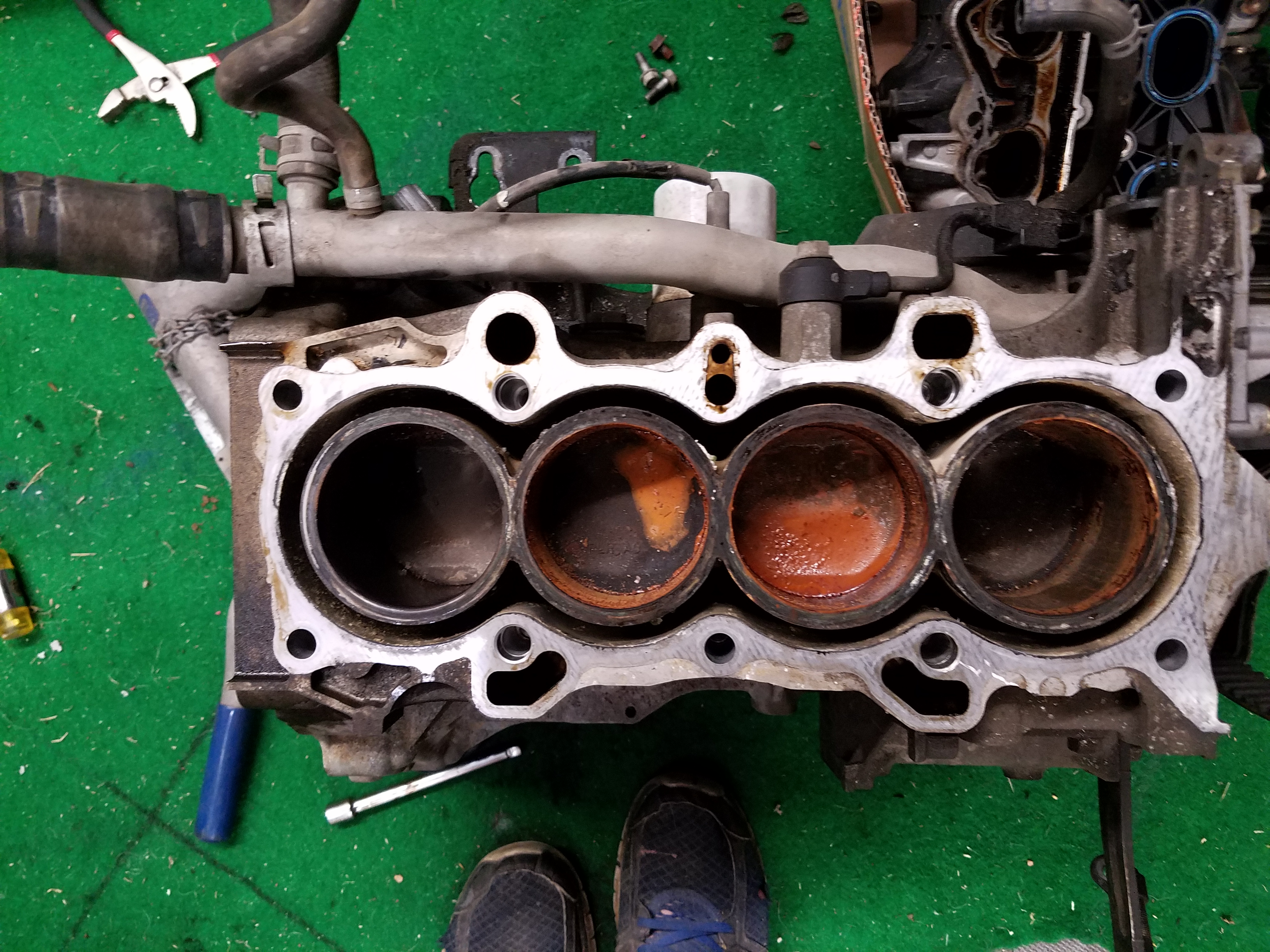

Take a load of this blown engine i bought for parts and to widen my understanding of the d17...

Re: You think you have civic issues????
Y'all get rain in Texas? That engine has been left open or something and got wet inside.

The engine was pulled from a wreck.
Bottom end is locked up...more likely rusted up.
i think this engine had a bad head gasket because the oil is caked on the upper side of the head.
i'm gonna get the head checked out for leaks and if it's salvageable...
Old Mar 20, 2017
More like the pistons are stuck from water/rust. If you unbolt the rod caps I bet the crank would be able to move.
