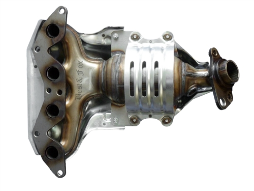

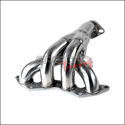

my headers are cracked a tiny bit, but ive noticed the manifold, cat and headers are all one piece on the 01 lx. i was wondering can i get a straight header without the manifold (itd be cheaper) ? and just like punch a hole in the header for my o2 sensor ? or will it throw a code for no longer having the cat

basically can i switch from stock figure A to example B without issues ? what will i have to do in order to make this work.

Figure a is the lx/dx exhaust manifold/catalytic converter assembly.
Figure B is the ex exhaust manifold

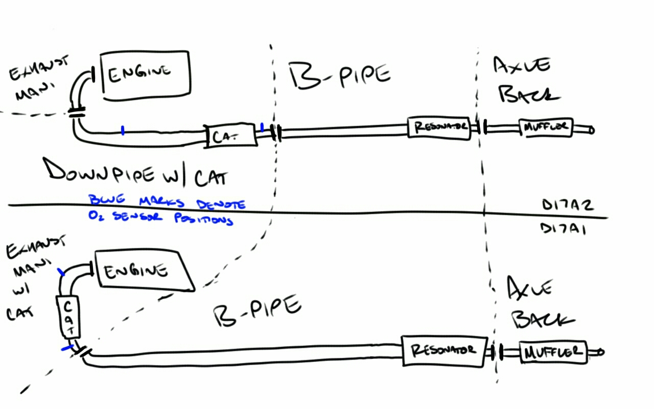

Since your car is originally equipped with the lx/dx one, in order to use the ex manifold, you'd need to buy a downpipe and B pipe, and extend your o2 sensor wires. Refer to my diagram below illustrating the differences

TL;DR not quite interchangeable. Conversion can be done

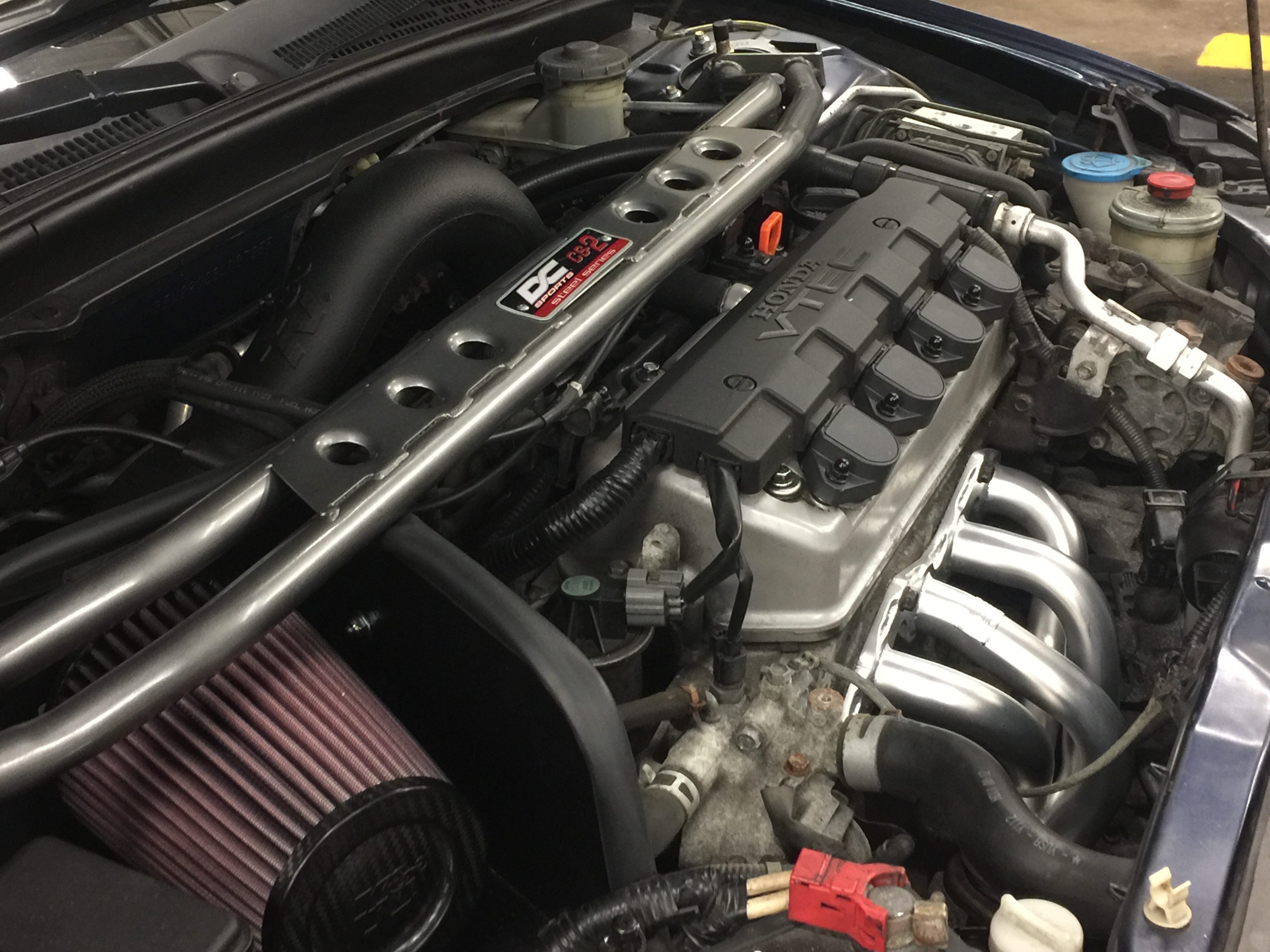

This is my set up. 4-1 ceramic DC SPORTS HEADER. I have an EX so I didn't need to worry about the O2 sensors they are further down on the j-pipe.

so could i just get new headers and downpipe , then cut and weld my existing bpipe , get the extension for my 02 and move it down , so basically total list would be headers, downpipe, o2 extension correct ?
Slight semantic correction to your post, D17 only has a single exhaust manifold, thus header. Again, just semantics. Basically, yeah, as long as you get the downpipe that mates with the ex exhaust mani and you get your B-pipe welded to fit properly, you should be good to go. Well, along with your aforementioned o2 sensor wiring extension.
