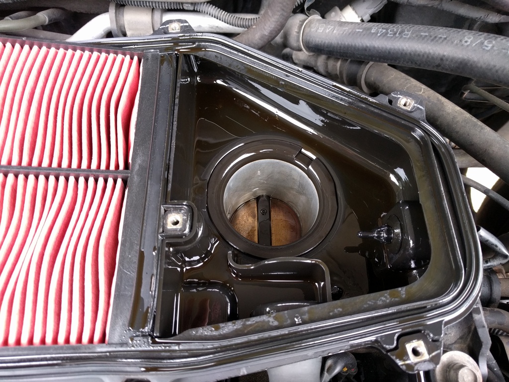

I cleaned the IAC and it started for me. It didn't start as crisp as normal.
I took it for a test drive. All seemed okay while it warmed up. But after it was up to operating temp I noticed it wasn't willing to rev past 3k rpm.
I got up to 60mph on the freeway and I downshifted to 4th. Smoke out the rear and it started to stumble.
It didn't want to idle after that.
Made it home and pulled off the air filter cover. The shiny stuff is oil....
Old May 18, 2016
Re: Cranks, but No start, No CEL... what to check?
Holy poop!
How high is the oil level on the dipstick?
How much oil is sitting in the bottom of the intake manifold?
The filter media looks dry, so...
The oil looks like it had to have come through the breather tube in the valve cover.......
Is there a severe restriction in the air breather ductwork or that big chamber that would cause it to pull oil out of the valve cover (via manifold vacuum)?
Check oil level (again?)
PCV valve plugged up?
Baffle in the valve cover damaged?

I checked the oil on Monday and it was just a hair off full. Which I thought was odd because it was exactly full last week. I checked again after seeing that oily mess and it's still just under the full line.
Its coming from the breather tube for sure... PCV check is on my to do list...
The very large air box could have a plastic bag or something in it... I'll be investigating on Friday at the latest. Its been raining or threatening to... Full day at work tomorrow but I'll either get on it tomorrow or Friday.
I thought I had checked the PCV at some point, but I will definitely check it.
I've never seen signs of sludge, even last month when I had the oil pan off to replace the gasket. I was very careful with valve cover when I had it off to do the timing belt last month.
She was running great until Monday afternoon. I can't see how anything got damaged and it got to this point so fast.
You can guess what my first thought was... since every other thread is about a blown head gasket. But I've never seen oil coming out of the breather as a symptom.
I think its running like crap because there is oil in the intake air... I just need to figure out what is causing this back pressure.

Check the cylinder pressure for bad head gasket, worn piston rings, valve seals, injector O-rings... Change the PCV valve.
I would agree on all these. Runs like crap as soon as it swallows a slug of oil..
Did you open the throttle to look in the bottom of the intake (flashlight ), see if there's a lake inside? (maybe use a dipstick to see how deep it is)

No rodent nest, and not blockages on the very large airbox.
I replaced the PCV but the old one rattled and didn't appear clogged.
No lake in the intake, just an oily film but I used carb cleaner and it was running fine after cleaning.
I now have a vibration when I back off the throttle. Very odd, seems like its coming from the bottom end of the motor.
I drove it but never got above 2500 RPM.
It spit a little bit (teaspoon) of oil out of the breathing tube.
This is not good...

Hmmm.........................Hose attached and flowing?
PCV is supposed to draw a slight vacuum on the crankcase especially while the engine is idling. Does it?
Open air filter box and block the valve cover vent tube with your fingers and wait a few seconds, can you feel vacuum?
(You will feel air pulsations back and forth because the engine is running but overall it should pull a little vacuum)
(Checking for a working PCV system, and checking that it is not overcome by blow-by at idle)
Remove fingers from breather....
If you hold throttle steady maybe 2000-3000 RPM does it spit oil out into the breather area, or must you be driving for this to spit oil out?
I'm thinking a compression test would be in order....
Compression test, is it lower than it used to be? (if you've ever done it in the past)
Pull valve cover and look inside? Oil return holes not plugged, baffle/oil separator area ok?
Puzzled.
Swallowing a huge gulp of liquid can bend rods.

At cold start and idle I could feel it pushing air out the vent tube...
PCV connection was drawing a vacuum.
