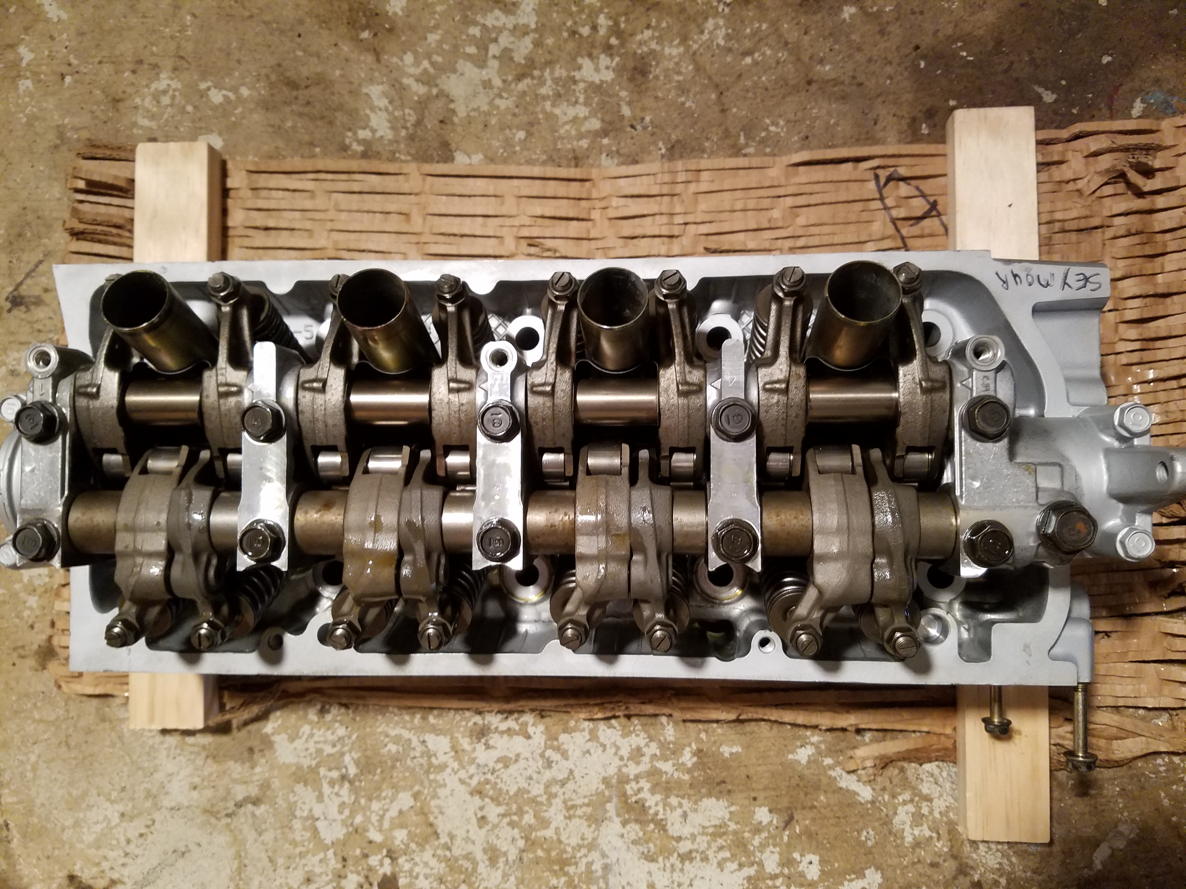

Just bought a rebuilt head. Worked out easier then getting the valves replaced....or so I thought. Looks like they sent me a Vtec head!
I have a non Vtec D17A1
I don't really care for Vtec. I just want to get the car running. Can I use the Vtec head anyway and not have the Vtec hooked up?
I noticed there are some extra holes on the intake side that my non-Vtec head does not have. Presumably for the Vtec solenoid?
Here is what they sent me. The casting number of is PMR-HA-5
Old May 16, 2016
Re: Part Number for Cylinder Head Bolts
Just call the supplier and tell them they sent you the wrong head.
A new vtec valve to plug the open holes will probably cost more than the head did.
Is the VTEC solenoid all I would need to get this head to work? Might be able to get the seller to send me one.
Old May 16, 2016
AFAIK the valve and its gasket.
After that you could wire it to a standalone controller if you wanted.
