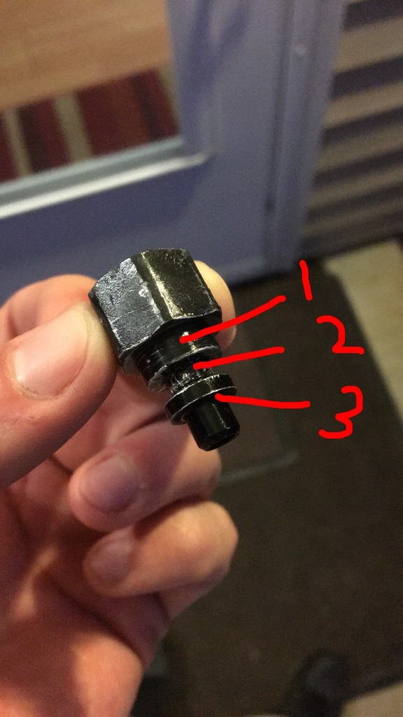

Re: Clutch not disengaging
It's a flat rubber ring, right? It would go into the hole of the master cylinder first, so that's #3.
Your fitting goes into the hole next, so it sits on top of that ring.
The hairpin clip goes into the slot #2 (where all the chew marks are)
Honda also shows a special (somewhat expensive) silicone grease in this bulletin used to lube the ring and for the squeak issue that can come from the swivel fitting. See this PDF

  #48
j.stoltz's Avatar
Joined: Apr 2016
Posts: 39
j.stoltz is an unknown quantity at this point
Yeah it's a flat rubber ring, not an o ring as I said earlier.. That must explain why fluid was shooting out of the retaining clip when I was bench bleeding it earlier
I'm gonna seal that up properly and will be back with an update!

Well I got the new seal onto the plastic fitting, did a bench bleed and everything worked fine. Once I got the master cylinder mounted to the firewall and the clutch line fit, I go to press on the clutch fork to release any bubbles in the line, and fluid shoots out of where the retaining clip is.. I'm wondering how this is possible with the new seal, is the clutch line clogged somewhere?
