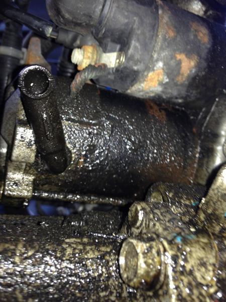

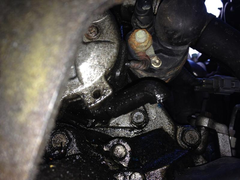

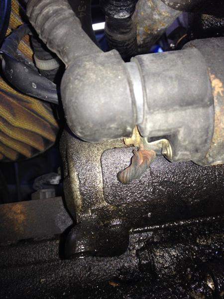

Re: What is this engine part?
Pictures from front, side, and underneath.
Well, the tube looks like a vent for the starter motor.
But it cannot leak oil. A starter has no oil to leak.
Your oily mess originated elsewhere. And that's a lot of mess.
Indeed it is. Maybe ill take a couple hours and clean it all up, then when it leaks ill see where it starts from. Thanks for the insight my friend, ill update then.
^ My guess is VC gasket, cam end plug, or both.
Old Jul 1, 2014
Or VTEC gaskets.
