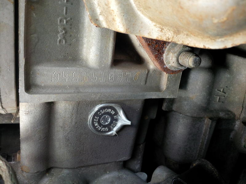

Hello Civic forums,
long time no see!
I have a question on a D17a2 ive stumbled across.
See the picture below, its directly left of the exhaust manifold as noted on the topmost side of the picture. You can see the cylinder head to the left of the shiny object in question.
What on earth is it? The gasket sealant seems in much newer condition then any other gasket on this d17.

It's a "heat tab". The center melts away at a certain temperature. The tab typically gets attached to a reman or used head, by the rebuilder or machinist or salvage yard.
If the engine overheats, the center will melt away and whatever warranty that cylinder head had on it will be void.

Excellent, thanks for the quick turnaround response.
I'm thinking this engine was remanufactured and whatever occurred in the past(pre-rebuilt) must have impacted the cat. Upstream A/F sensor has been replaced with a denso that I can't readily determine if the previous owner replaced it with the right wideband one.
The typical scenario is the head gasket blew, nobody noticed, and ran the engine overheated, probably severely overheated.
Some people have no clue anything is wrong until the car just can't pull itself.
That's just a wildass guess.
No big deal, someone put an engine in it. Or a head. Whatever, it's repaired and runs now.

Block VIN and doorjamb VINs match up.
I won't be able to dive into the car more until this weekend. I'll go down under and inspect the exhaust/downpipe for issues, and update on here.
Central south Texas means your quite right- rain is like snow in Ecuador here.
Old Apr 3, 2014
Re: What on earth is this?
So it's probably safe to assume the head has either been repaired at a machine shop, or it's a replacement. For whatever reason.
