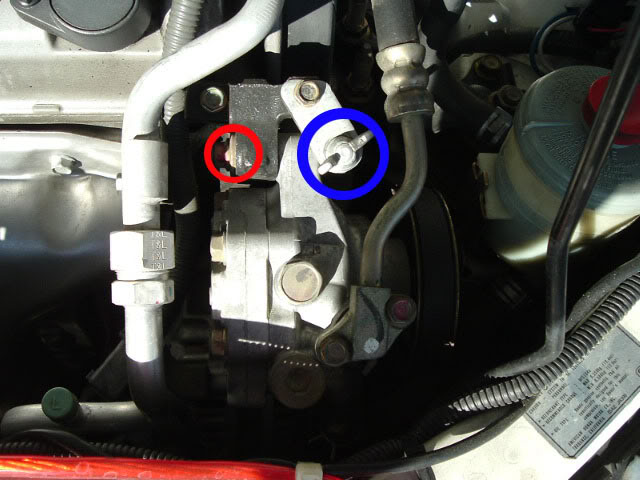

I found a picture for the first bolt to loosen and the adjustment bolt but doesnt show the 2nd bolt to loosen before touching the adjustment bolt.
So I loose the red and the 2nd bolt (supposedly by the pulley) first with a 12mm socket, and then the blue is what tightens the belt tension?

Okay... first, gotta back off the tension for the PS belt and just remove it... that'll give you more room to wrangle the other belt's tension, which is both the more important and more difficult to adjust of the two, just due to being more buried. It's not *super-hard*, just a bit more tedious.
The rule of thumb for all acc'y belts, is 1/4" - 1/2" play in the middle of the longest run of belt while on the pulleys... however that's for just being stranded in the middle of nowhere within walking distance of a NAPA, emergency only. I'd follow the Honda tension specs, which are:
Applying 22 lbs of pressure to the middle of the top run in both cases...
13.3 - 16.5mm deflection for PS belt, used (1/2" to just over 1/2" play, or 0.51" - 0.65");
8.5 - 11.0mm deflection for alt belt, used (little over 1/4" to just under 1/2" play, or 0.33" - 0.43").
Honda gives new belt specs too, which are tighter... but in the manual it also says to install and run a new belt 5 mins and check using the used spec, so unless you can't start the car, it's not that crucial to measure with the new spec AFAIK... if the mod pros chime in with correction, go with their advice.
There are three fasteners to move: loosen the pivot bolt for the PS pump... loosen the jam nut that holds the tension in place (and keeps pull forces from the crank off the small adjusting bolt), and adjust out with the adjuster bolt itself. The only one not pointed out in your pic, is the pivot fastener, lower down between the belt runs. The jam nut and pivot bolt *must* be torqued after adjustment, or a squeaky belt will be the least of your worries...

When it comes to working on your ride... pros before bros! This should be plenty easy to do solo, though.
Thanks, fair enough. WHen you say apply 22lbs of pressure to the middle of the top run of the belt, what tool do I need for this?
And those specs you give for deflection, im guessing you measure with one figure on the middle of the belt (with the longest run) upwards (or downwards?) and use measuring tape to measure how much the belt deflects inwards/outwards (depending if you push up or down on the belt)?

CN, I've edited my last post to answer your questions. Check them out. Yes, deflection spec is deflection in one direction only -- when you put the weight on it. It's not (as with motorcycle chains) freeplay in both directions...
If you want to use a 22 lb weight somehow, please take a pic so I can enjoy viewing some severe boffinage. Seriously though... just ballpark it. If you want to get technical, press with your thumb on an accurate bathroom scale until it reads 22 lbs. I just imagined the force a 22 lb weight would feel like in my hands, then used the same force when I did my adjustment three days ago. Doubling up a piece of tape with the correct measurement marked off in ballpoint pen, was the ruler I used. Little easier than jamming a metal ruler in there past the A/C lines...
One unexpected benefit from a properly-adjusted PS belt, is that the steering feels the same, no matter hot or cold, dry or sopping wet (as it's been here non-stop). My steering feels much more consistent now, not bad for ten mins with a ratchet, 12mm short socket... and my thumb.

Thanks. Little confused by this pic though. It shows both bolts are on the passenger side of the PS pump? I looked and looked and could only spot the first one (which is the top one).
I just finished this, before seeing your edit, but I first loosened the bolt circled in red first (had to take out the small black metal bracket first, couldnt get my ratchet in there). Then I did the lower one which was on the driver side of the PS pump at the bottom by the belt run (white arrow). Once I had both those bolts loose, I turned the nut (blue) counter clockwise, took the belt off. Pulley spun freely, no noise.
Put the belt back on, (which was a major PITA getting my arm down there), turned that locking nut (in blue) clockwise til I got roughly the deflection you listed (but was so hard to do due to the fact i couldnt get my hand quite half way in the middle of the longest run, but close). I had to eyeball it. The nut ended up going 1/4 turn more than it was set at before. DIdnt want to make too tight. Not sure if 1/4 is significant on these cars for the belts but i figured i wouldnt go more cause the belt was tight.
Then first retightened the bolt by the belt run to 33ft lbs (white arrow) or whatever spec you had listed. Then retightened the bolt in the red to spec and put back that black metal piece with the 2 tiny bolts.
Just to test, after i had everything tightened back. I tried turning the adjustment nut counter clockwise to see if it would move and it wouldnt at all (just wanted to make sure). So im guessing that its not the adjustment nut that keeps the adjustment in place but the two 12mm bolts?

Did I tackle the correct 2 bolts in the pic I posted? Just wanna make sure or i have to re-do it.
