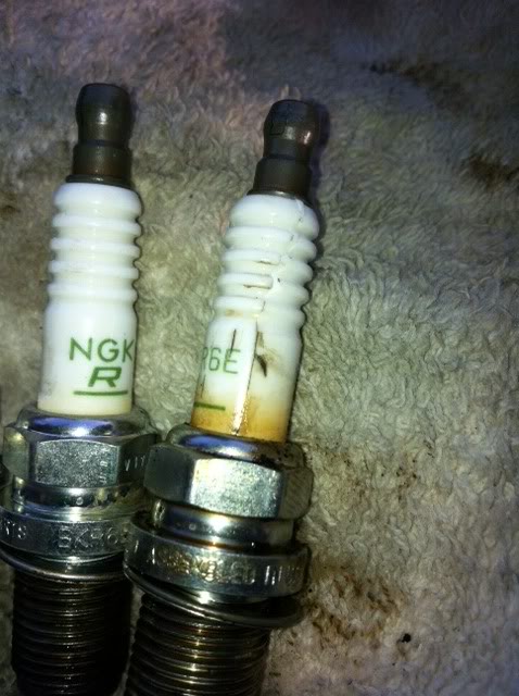

THEN I'd remove the sparkplugs and look for arc trails (carbon tracks) down the outside of the porcelain.
If you find any, that's bad. That means the corresponding coil boot is also probably damaged from arcing (didn't see my usual pic of that right away though).
Replace any that show arc damage. I'd replace the corresponding coil(s) too.
