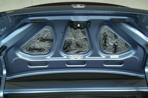

I have never used dynamat, but what I have seen you are suppose to cut a hole around the speaker. The same for trunk spring. As small a hole as possible for the spring. I would think that you fill the cracks between the squares of dynamat so that's it air tight. Your sub box should definatly not have leaks if its a sealed inclosure. I would get a gasket and re-seal the sub in the box. They make an adhesive type that you can stick around the outside of the hole. Silicone would work but wouldn't re-seal as well if you need to remove the sub from the box.

That first picture is blowing my mind. Are those just little squares of dynamat or is that a whole sheet under there? If so how the hell...?
In the second picture it looks like they are covering over the whole spot while just molding it in?
Also, the spot under the rear deck speakers seems pretty difficult to just tack up in one whole piece of dynamat, so it's okay to cut little shapes to fit where I need, or will that just decrease the effectiveness?

Lol, I don't know but the first picture looks really cool. I don't know how they did that, buts that how I want to do mine. They probably used the squares and stuffed them up there. Yea you can cut small shapes to fit, you just to make them as tight as possible. Dynamat makes a tape that you use to cover all the small cracks between the squares. The second pic looks like they taped the whole thing up to make it air tight and give it a finished look. It would probably be best if you could keep the pieces as big as possible.
