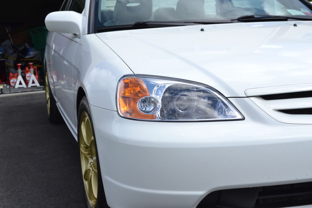

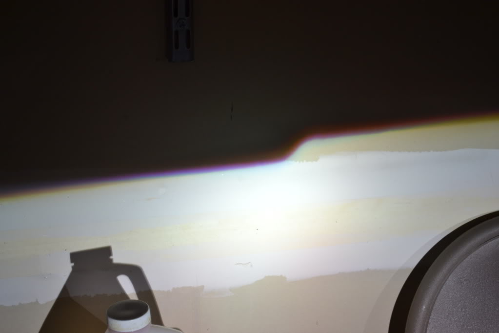

Hell if your gonna spend that much why not just get them minis. They will be much better than hids in those.
Last pic is when i was installing them. got 5k bulbs and the cutoff is amazing when driving.
if your afraid of messing up your lights just buy a second set. I got these TYC replicas of amazon for like $40 a piece and they haven't leaked at all.
