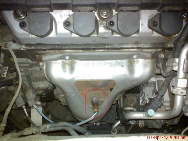

According to NGK website there is no v-power plug for your car.

Re: Help needed - P0420 after maintenance
Thanks ezone.
Attached the image where I saw the smoke, sorry I didn't realize this isn't the O2 sensor, after reading more I realize that its not under the hood but near the cat which can be seen only from underneath the car

1)smoke started coming from the part i shown in the picture(it was like smoke you see when hold cigarette in hand)
2)the dashboard temperature gauge went to max(red)
while taking below picture,I just open the radiator reservoir and it was filled till neck. this is not the first time i opened the reservoir after changing coolant, but it was always leveled till max mark.
i am not too sure if this is normal or a problem.

You can see the wiring for the rear O2 sensor in the pic. The cat is between those 2 sensors. Your cat is NOT under the car.
The whole area gets HOT, so anything spilled or dropped can make smoke.
