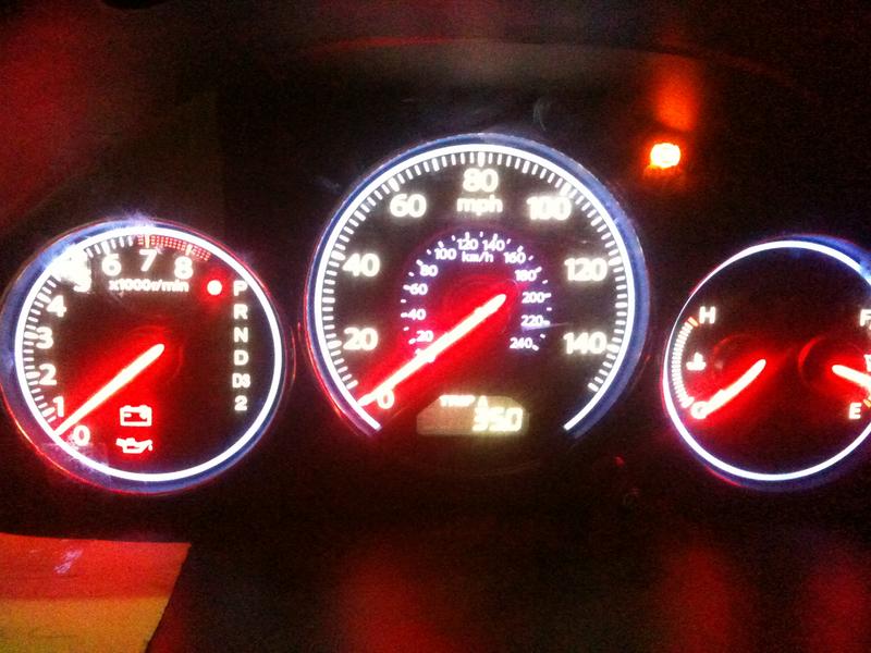

this cluster was a lot of fun to install and went flawlessly

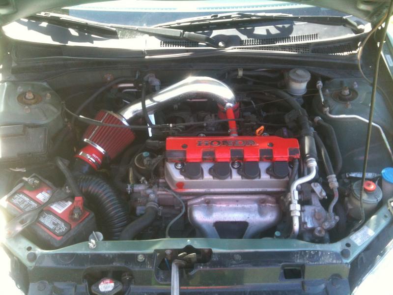

Haha, the dust cover desperately needs to be repainted...
It's a good color scheme, but try masking it off super well next time
And that hose in the intake...? Interesting, I've seen pipe work bend towards air filters but never plugged into them, lol

The radiator fan puts out a lot of heat though, so that's probably not the best spot to pipe it.
Ideally, you should have the tube mounted behind your front grill (with about half of the tube opening exposed so you don't force in too much air) and put a net or chicken wire in the end to keep debris from flying into your intake.
Alternatively, It's also not a bad idea to run the tube downward into the fender wells like a CAI does.

I was thinking about the fender well but the hole into didn't have enough room but I'll move it to the grill definitely thanks a lot!

Oh, and obviously if you were to do that, be extra careful when washing the car not spray water into the air intake, lol
On second thought, the fender well is probably better in this case

what year is you civic and how did you swap that in ??
Old Apr 16, 2012
paulymcd7's Avatar
Joined: Dec 2010
Posts: 281
paulymcd7 is an unknown quantity at this point
Re: 04 value package es1 build
mine is an 04 and i got an 03 ex cluster off ebay shipped for like 40 great buy use this thread
https://www.civicforums.com/forums/1...-video-12.html
everything in this thread worked perfect you may be confused with a blu/red wire but just move that to where it says it goes on the ex connector your abs light will be on im gonna pull mine out and see if i cant just take the bulb out apparently you can ground it but i touched it to the frame and it didnt work and you will have a wht/red wire left over tape it up good that has constant 12v running through it since it has a red stripe it accidentally touched frame when i did it and no fuse blew but just to be safe and the diy video for removing the pins works its not one of those farfetched diy's where it looks easy and it isnt his paperclip technique worked perfect. just follow the diagram exactly one wire at a time and be very careful if you dont disconnect your battery (i didnt) and if you dont, dont let any connectors touch. im good with wiring and electronics but you dont need to be for this diy. also mileage is stored in the cluster so im still working on finding a way to roll back the cluster 62k to match the original miles of 118k stock cluster
