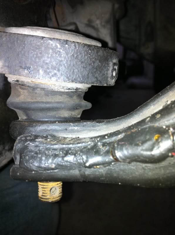

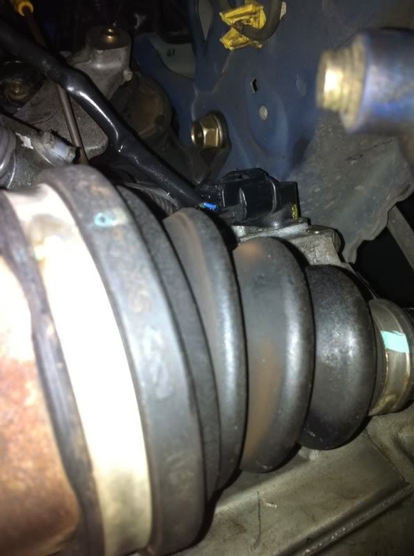

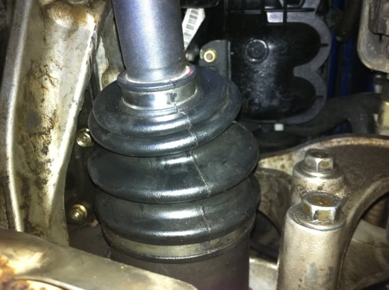

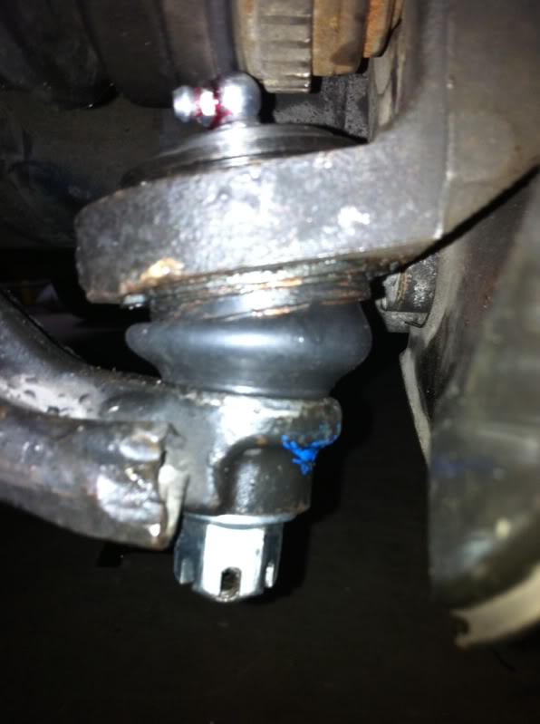

I think the guy is full of crock. After trick and treatin with the kiddo I jacked the car up and did a basic test my boyfriend taught me one, jack up the car and turn the steering wheel to the lock position, moving the tires side to side there is barely any play and what does move the tire moves the steering wheel a wee bit side to side, the steering is nice and tight? If needed I can take a video. I went back to the shop and asked the guy to show me how it was broken, his response; "You wouldnt understand, its a complicated process", my response was a couple choice words
What I did find was differences in the axle and ball joint angles and distances on either side. I took some pictures.
Drivers Side;

Passenger Side

I know the castle nut is off on one side I took it off. But look at that damn grease zerk! I didnt see that yesterday. Another thing is the angle of the knuckle on the control arm, seems off to me. The ball joint looks to be the wrong size and finally the axle seems to be pushed in more than normally into the transmission side.

They used bolts for '01-'02. You need bolts for an '03-'05. Somebody correct me if I'm wrong.
Ball-joints and axle boots look fine.

Here's the lovely store from the alignment shop.
So after replacing the ball joints I took my car in to be aligned. They told me about 45min they would call me and the car should be done. I left my phone number and told them id be back when they told me the car was done. So at first 30min rolls by and I am just spending time shopping, check my phone, nothing. Another 20min rolls by and I'm done shopping, still no call. So now I start my lovely walk back to the shop. I see my car sitting outside and ask if it done. Guy tells me its "all jacked up", when I ask why, he just says "cant be fixed, your power steering is broken, get that fixed". I ask whats broken on it and he tells me "its too complicated to explain and you wouldnt understand anyway, take it to another shop and get the tie rods fixed" he then proceeds to tell me my car was done 10min after I brought it in, when I asked why I wasnt called, he tells me they called me over and over and I didnt answer. I show him my phone and recent calls, he calls me a liar and walks off.... Jerk.
I drive the car home and after changing lanes the first time, the car starts to have this clunking sound from the drivers side. Okay this is new... what the heck!? Get it home and after checking the knuckle, there is all that play thats shown in the video. Other side doesnt have that and I notice the tools I used to remove the bolts last time arent the same "wrote everything down for the DIY", so now im pissed. I get the truck and drive the car onto our quad trailer and strap it down. I have NEVER driven the truck with the 16ft trailer, so lets say that was a insanely new experience.
Next day I drive the car back to the shop and see the same guy from yesterday. Im pissed, angry and parked in a bus lane.( <--- that describes it.) Anyway I call out the guy and ask him to fix my car correctly. He starts off by saying "Listen here lady, you have no idea whats wrong with your steering, thats why you brought it here, so get back in that truck and get that fixed by a professional before you come back here". I tell him I want who is in charge of the shop to come out now, he gives me some smack talk, but after standing there and saying "im waiting" about 50 times, he goes inside and gets his boss.
Now it gets interesting. I show his boss the video and tell him the incorrect bolts were placed in my knuckle. The lovely guy that worked on my car starts saying im a liar and "this is why chicks arent mechanics", I keep my cool and ask him to please check it out for me. His boss looks at the video like 3 times and looks at him, says one sentence "Are these the bolts that went on that 2001 civic Jeff was working on last night?", he tells him no, and his boss goes inside to take a look himeself. Sure enough he walks out with the correct bolts for my car, tells the guy to go inside and apologizes to me for all this hassle. He gets in my car and drives it off the trailer and into the shop. Tells me to call his number when I get home and he will personally give me a ride back to pick up my car.
Didnt charge me at all, and after about 30min I was driven back to the shop and picked up my car.
