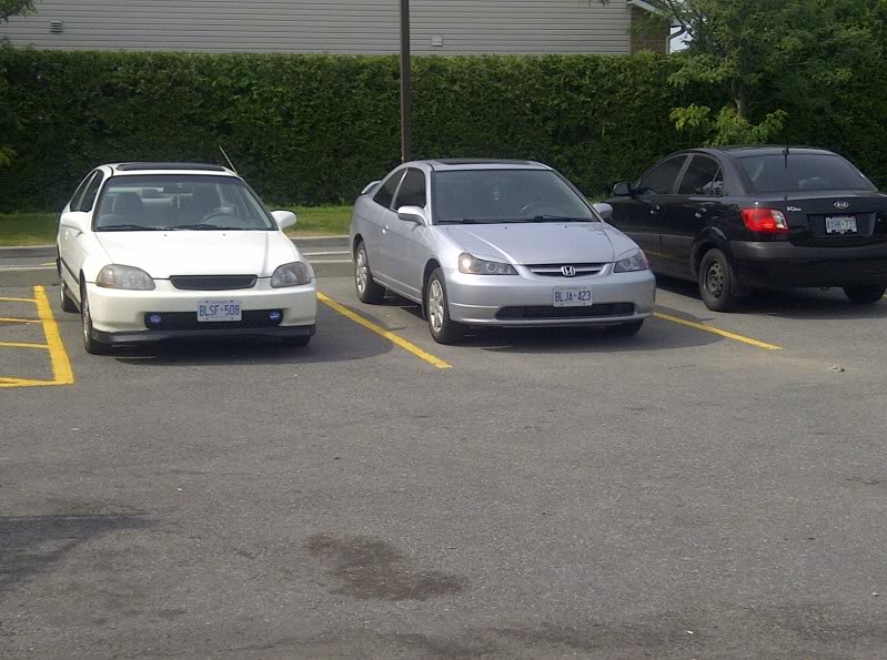

Don't get them... i spent a long time deciding whether to get halo projectors or not. I ended up retrofitting my original headlights and putting a CCFL ring on them... the light output will be much better and i find the ccfls are fuller / brighter than the leds.
heres my car after the retro:

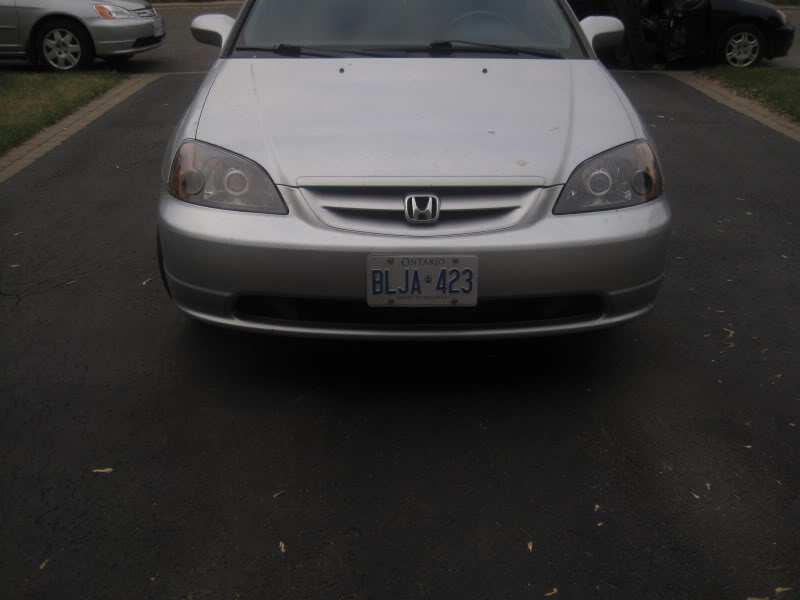

throw on some eyebrows:
Now you're driving like a boss! (imagine there being a white ring around the projectors in my headlights, pretty nice no?)

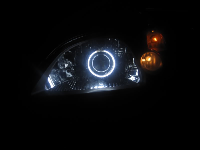

Here's a pic with the halo ... this is a terrible picture but it's the only one i can get with my phone because i can't adjust light settings. I'll try to get a better picture, they look really nice.

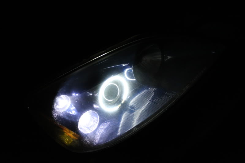

now I feel the need to show mine off...
CCFL angel eyes in TYC projectors.

the park lights are so nice but what about the hid projector being yellow in comparison. you still have the oem 4300k bulbs i think?

HIDs aren't on in that pic, just parking lights + angel eye.. And I never really noticed the color difference until you pointed it out. Then again, kinda like HIDs warming up, I found the CCFL angel eyes need a few seconds to warm up too, to achieve their "full whiteness."
Also, I kinda wanna buy a new set of TYCs just to have spare parts, really just so the front lenses aren't beat to ****... But that'd be another $130 or so...
and I have 50W 5000k in my retro

Reflectors are chrome painted plastic that reflects light outwards, projectors are made of glass and project light outwards basically do the same thing but projectors just do it better
A retrofit is when you put / replace a projector in your headlights.
This picture shows it:
The glass things in my reflector housing are projectors.

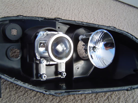

its the one that makes the normal driving beam in traffic. the hi beam is the reflector part (larger chrome circle) for seeing far away and cant be used in traffic because it throws light everywhere. the lo beam is a projector unit inside that has a chrome bowl and shield to block light above the cutoff. its the smaller circle area with a glass lens in front. the rest is hidden inside the headlamp.
the largest circle is hi beam with H1 halogen bulb. smaller circle next to it with lens is the lo beam projector, orange part is turn signal, tiny circle at the top is small park light.
this is what is behind the lo beam area. the actual full projector unit and the bulb goes in the back. light is focused in the front by the lens.
and when its installed in the tyc headlamp with the front cover removed. the stock tyc comes with a halogen projector (terrible one at that) but it looks similar to the hid valeo (audi A4) projector i swapped in. they are very similar in size.

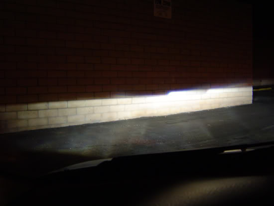

with the lo beam on, you get a nice light beam with defined cutoff to block light from hitting other drivers.

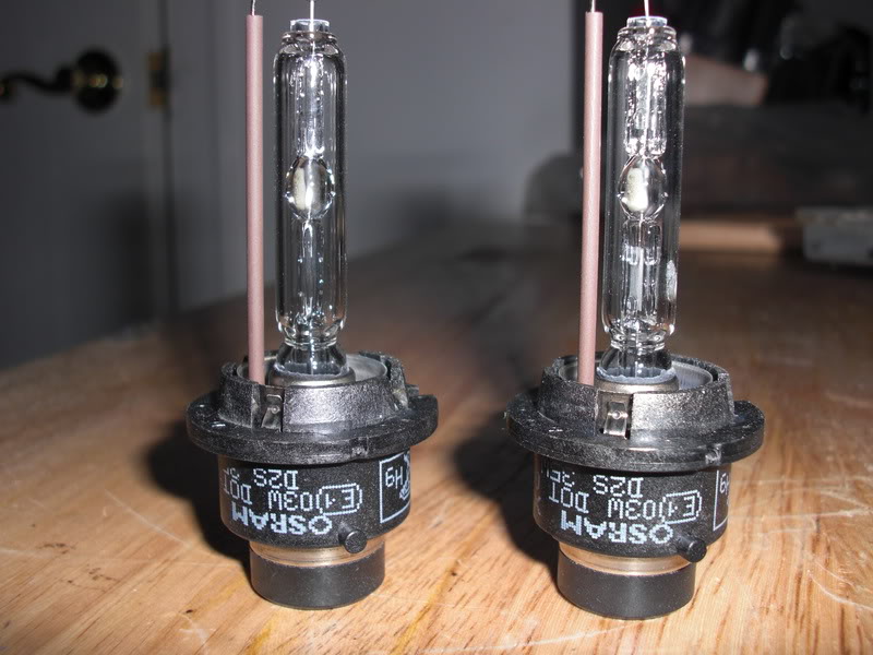

these are the oem osram xenarc d2s hid bulbs used in the projector and most other oem projectors as well.
