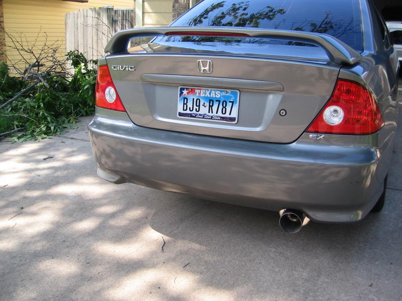

if you buy the spoiler from Ebay, don't drill at the marks inside the trunk, those ebay spoilers are off by 1/2 an inch or so even if the add says they are OEM style; happened to me and i had to drill two extra holes, luckily the spoiler covered the extra holes completely and with some silicon at the edges, no leaks or anything; i have attached a pic of my spoiler, they look good on the coupes, there is another file with installation instrutions, it is pretty easy
