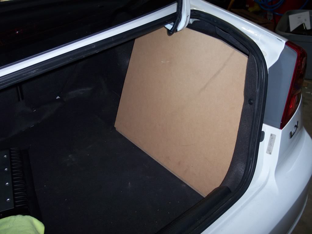

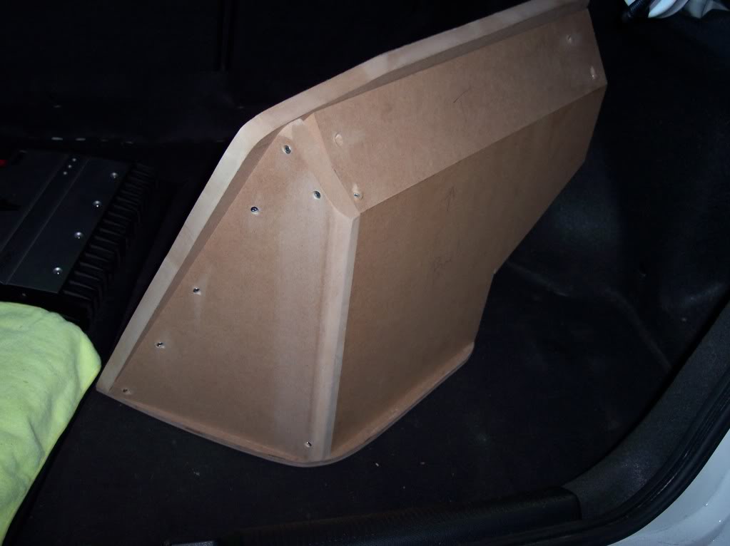

My JL Audio 13TW5 only requires .8 ft³ of space in a sealed box.. and is 2.5" deep.. But I don't even think that'll fit under the seat.. Then again, it's a 13" sub
you have a pic of your 13tw5 installed ?

i have a temp setup.. I'm too lazy and too school-busy to finish it at the moment.. I have a speaker grill over it unlike pictured here.. It's a no-**** JL Audio one, so it fits happy
edit: that box has .807ft³ of internal space. their recommended box size had ~.8ft³ internal airspace without the sub in it, so mine is built to spec. as it sits, the box is 5.5" tall, made of 3/4" MDF
thats cool how do you like the sound? what do you have powering it? i am building the box for mine yea 13tw5 also here is the progress so far Name:  000_0017.jpg
