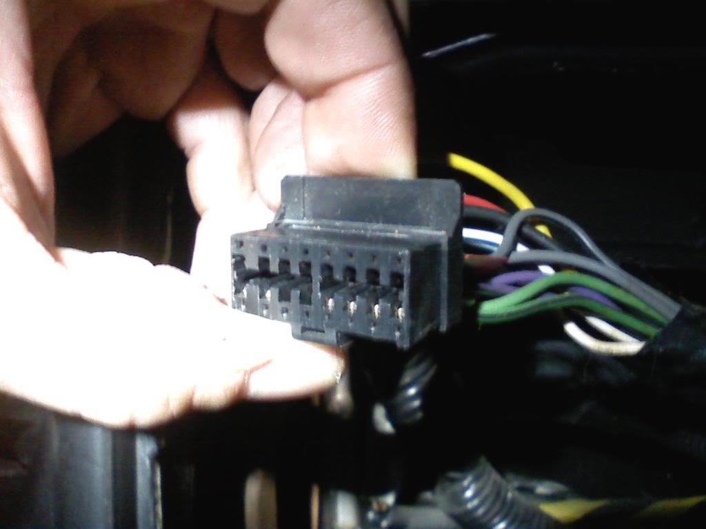

Might take you up on that offer if nobody else will. Have some questions first as I'm a noob when it comes to audio.
1. Does the CD deck have that aux input plug-in like the cassette deck? Reason I'm asking is I'd like to keep the CD as well as have the ipod connection.
2. Does this look like a factory plug? It's plugged into a Kenwood but, there are no signs of splices or cut wires and it has a tag with Japanese writing on it.

1. all 01-05 factory decks including FM stereo, cassette, and cd player have the extra cd changer port. the ipod adapter plugs into the empty port so long as you do not have a double oem setup (like a cassette on top and addon cd player on the bottom). you can only use the ipod adapter if you have a top deck and nothing below it (just pocket or empty tray). i have a factory stereo in the garage somewhere i can try and find to take pics of the back and point out which connectors go where.
2. that is for sure aftermarket connector (you can tell by the color of the wires too, oem uses very strange colors). the oem plug is blue and about twice as long. keep tracing it back and i bet you will find it plugged into the factory blue connector. they prolly used a harness adapter so they would just need to plug it in without splicing. they are rare but they exist.

Upon further investigation it's spliced in. My luck that I have the only car where they spliced it right. I hate redoing soldered splices.
