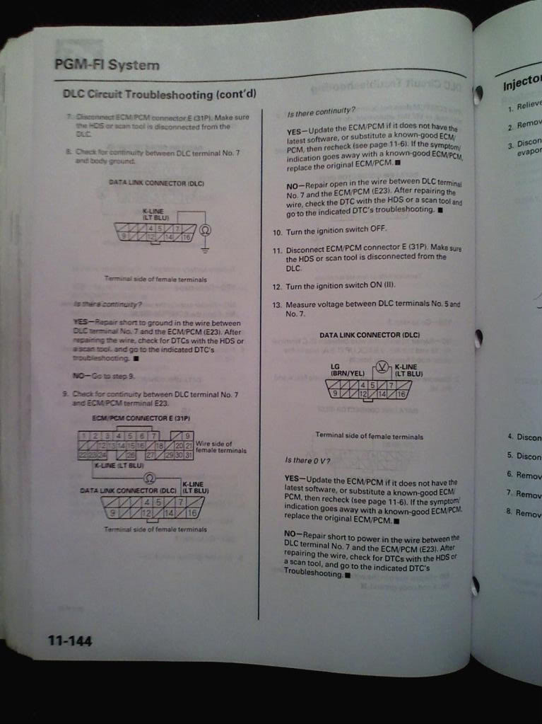

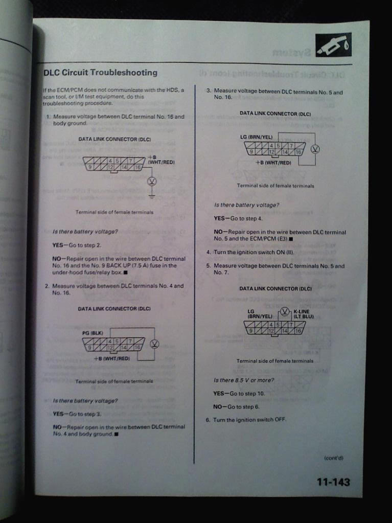

You obviously have an open or short somewhere. May have caused the ECM/PCM to go bad again. Sorry about fuzzy pics, phone cam.
