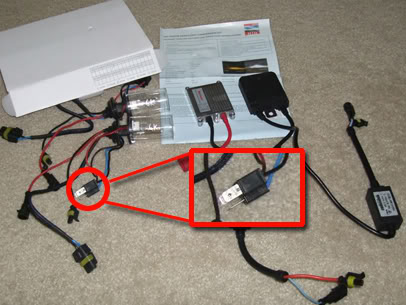

Here's the picture of the HID Ballast and Bulb from DDM tuning. HB2/H4

Yep, that looks like a H7 Adapter
I can't see the bulb directly, but if it's single beam, then it should be correct
However, you want a 3 prong adapter for hi/low like this:
I'm sure you can hook it up anyways with those two wires
If you look at the 3 prong input on the car's harness
if u look at it straight on, it should look like
Ground wire should be the top LEFT
and low beam should be top RIGHT
As long as you plug your black wire into the left, and blue wire to right, it should work, you just wont have high beams

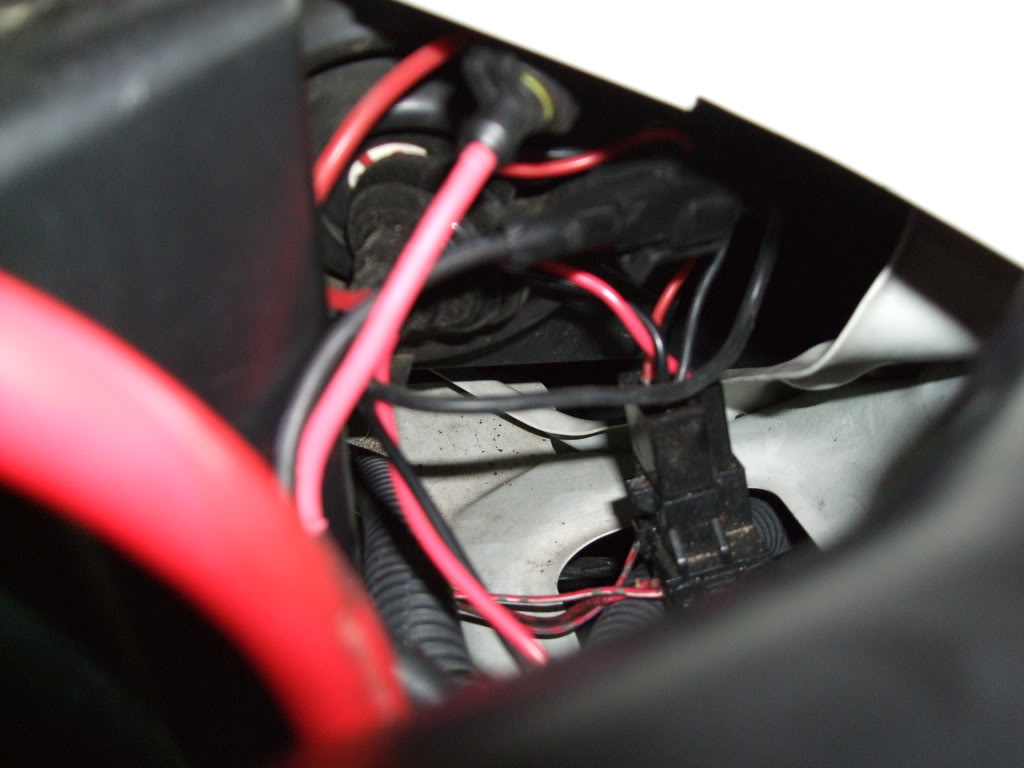

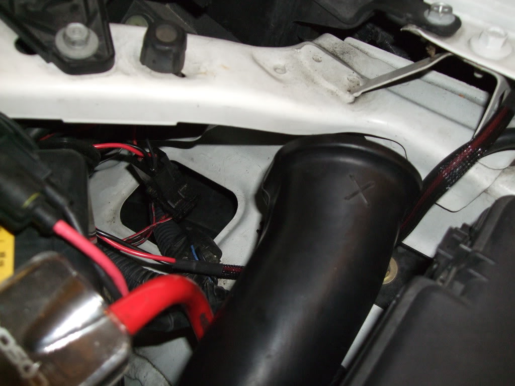

Passenger's Side
Driver's Side
I guess some people will recommend putting them further back by the strut towers for heat purposes or something, but I've had ballasts (both the old thick ones and these new digital ones) there since summer '04 with zero problems.
Just use some 3m or loctite double sided tape to mount them

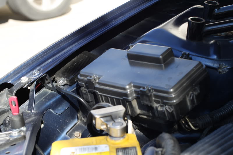

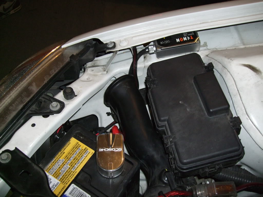

You put them same place I do
Easy, simple, and clean

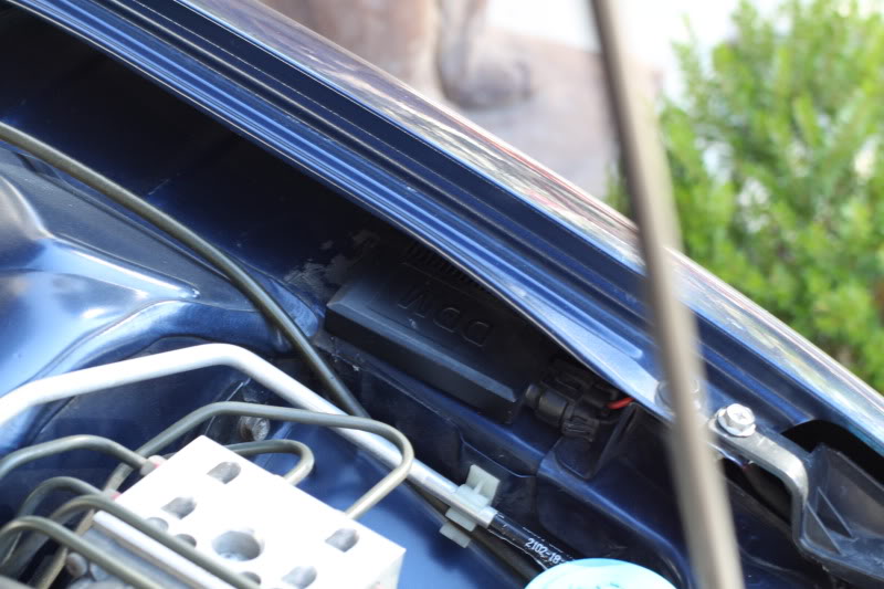

My harness doesnt come out that far either, like half an inch or so, but your wiring should be able to reach, mine does
