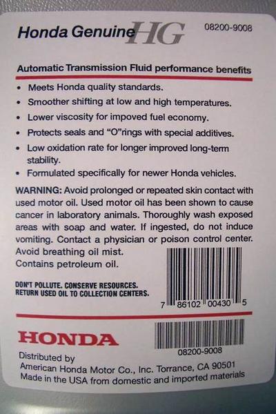

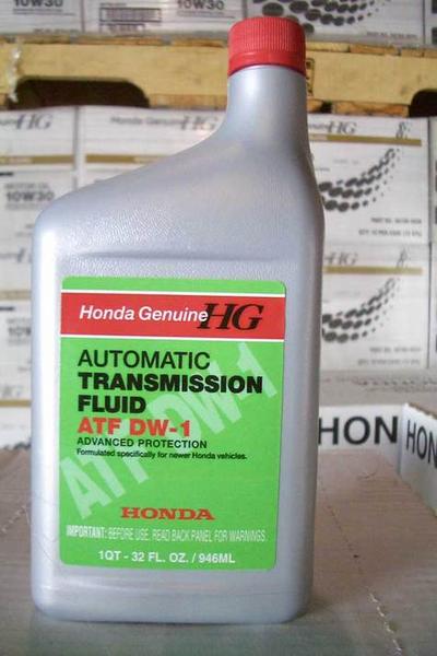

Regarding DW1, I've been reading generally positive things like this, but wanted to see if you used it yet:
http://www.honda-tech.com/showthread.php?p=45012229
http://tl.acurazine.com/forums/showthread.php?t=817907
I attached the MSDS and also the Honda Tech Bulletin for the new DW1, in case you haven't seen either, along with pictures of the bottle.

yeah ive seen that. the only real difference is the viscosity, and thats what worries me using it with older trans. thinner fluid may work better in ideal conditions (a new transmission) but one that is over 5k miles can be in serious trouble. and honda already has a reputation for pushing thinner fluids to raise gas mileage an insignificant amount based on no real data other than "it works better."
im betting the new fluid should work on most of hondas older "bulletproof" trans in the early 90s, but the 01+ i have my doubts. they dont make em like they used to. esp with all the clutch pack issues on the 7thgen autos, thinner fluid will only cause more problems. i think i may just switch to valvoline maxlife trans fluid when the dealer runs out of z1 here. valvoline says its the only fluid compatible with honda trans and ive never heard of a fail story yet.

Is there any information besides rumor that proves DW-1 is synthetic? If Honda didn't increase change intervals, it can't be that much better.
Noticing an improvement in shifting after changing to DW-1 doesn't prove its any better.

"The key benefits for the Honda ATF DW-1 are:
• Low Temperature, Lower Viscosity:
- Better lubrication
- Reduced friction at low temperature
- Improved fuel economy
• High Temperature, Stable Viscosity:
- Maintains film thickness
- Improved protection against breakdown
- Full synthetic, high film strength" - According to a Moderator @ ElementOwnersClub.com
Here's a picture of the Canadian bottle, which says "full synthetic" right at the top of it. No idea why the American version wouldn't, but there you go:
http://i77.photobucket.com/albums/j7...8/Image223.jpg
