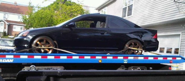

theres a pick of it on the tow truck, first time posting a pick so not sure if it worked.

I figured as much ... hopefully everything is okay internally... generally the engine does not fair well when the timing belt comes off. How many miles do you have on the new belt?

When I bought the car 1 yr ago I was told that it had a new timing belt clutch and waterpump. So i would estimate it has 10k. Which is farely new. Maybe the people just did a bad job. This time around it will be done right. I just hope I didn't bent any valves. Or did any damage to the internals.

BTW sweet car, I hope you get it going soon.

dam that sucks man but at least you know what it is before you started spending mony on random stuff. car looks nice by the way were you at the uconn show ???
