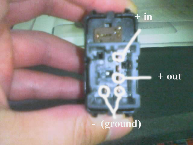

So I bought an aftermarket fog light set and realized the switch is a vertical switch for the driver side console; too big for center console. I went to Honda thinking the wiring harness should technically be the same, but I was wrong. I knew that I cannot return the switch after ordering it, so I'm going to have to make-do with it.
Does anyone know if there are adapters for connecting this or how to solder them together? What wire goes to what tab? There's an extra prong on the Honda switch.

since nobody posted, i took apart the switch to learn more.
i think i deduced what the extra prong is for. correct me if i'm wrong, but i think it's for the led bulbs. anyone know which wire goes to which of the 4 prongs? and how to connect the led bulb also?
anyone good with electronic circuitry/wiring stuff?

hope this helps

Re: aftermarket fog light harness to oem fog light switch
niceeeee. but what's the unlabled prong for? and it shouldn't matter if i mixed up the in + and out + right? since the switch is essentially connecting them together
the unused prong is illumination i belive. i kinda finagled mine. one is to power the lights and the other is to light up the switch. the one out obv goes to the lights. and the 2 grounds are for the switch.
im a little confused. so with the harness i have, which wire goes to which prong? the yellow and black should both be grounds for in and out right? and the 2 red should go to the 2 positive prongs?
did you hook up the illumination?
