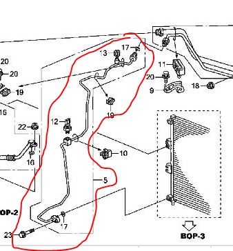

I'd have to pull the bumper to get at the condensor end, shouldn't be a problem, and the other end is very accessible. Line is part 5 in the diagram.

the two wrench comment was for the connection closest to the service valve.....I kinda thought it might have another fitting like that right about where the pressure sensor is in the diagram.....but yea if it ends at the bottom of the condenser you'll have to pull the bumper skin off.
Beware of corrosion on the bolt for that fitting, that can cause more headaches depending on how bad it is.
