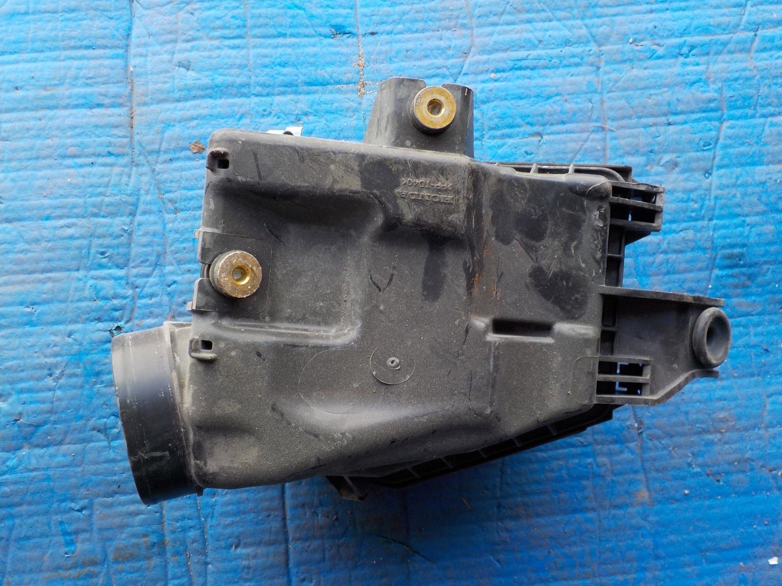

After you get the bolts out....there is a rubber ring that fit over a stud in the rear that make it damn tough to 'just pull out' the box. It takes effort but will come out though.
You just about have to put your eyes on it then get a prybar under it.
See pic:

I got it it with the pry bar !!!!! Thanks! Was a pain!
