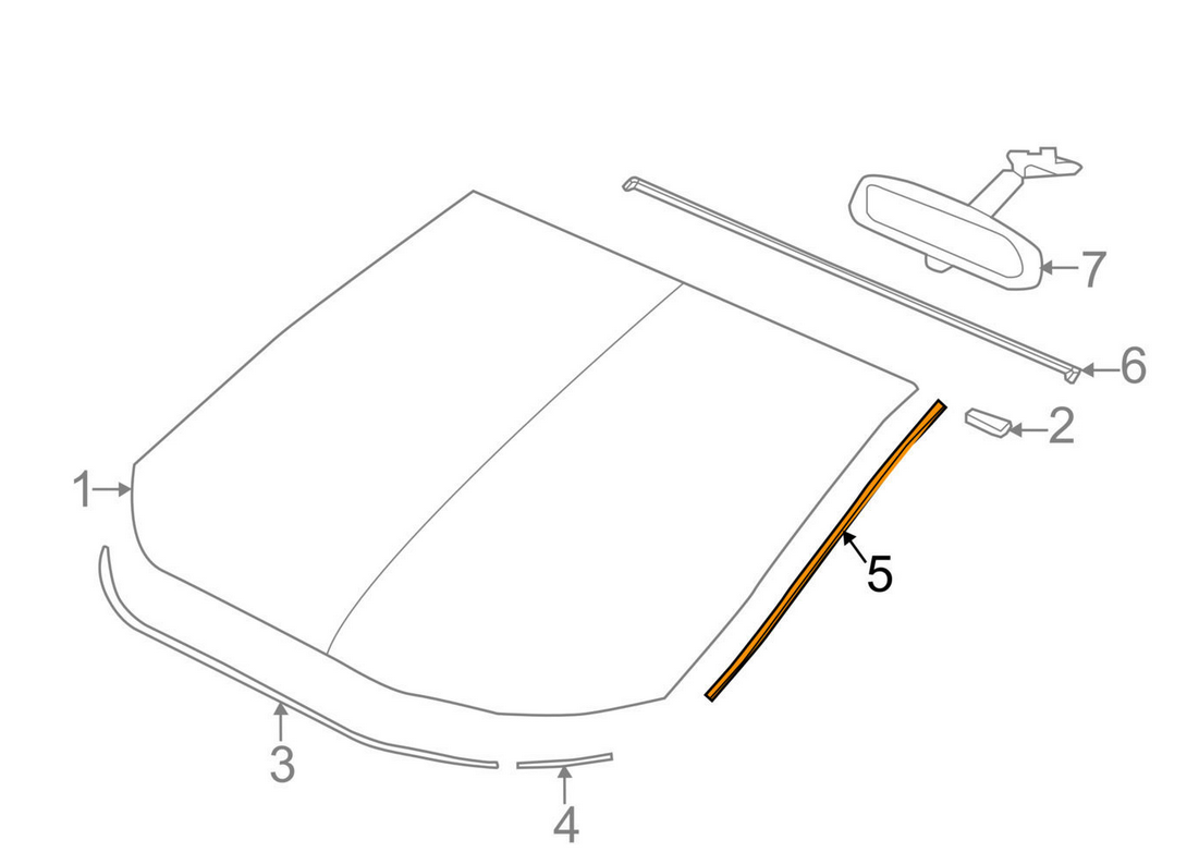

Both rubber pieces (left and right) of my windshield molding have fallen off. See diagram attached (not of the actual car).

You say the white clips are exposed, so you probably need the 'drip rail' molding (Honds name is 'drip side' molding?), they go all the way across the roof to the rear glass, and are different on each side, and different between coupe and sedan.

ezone's diagram is correct, the molding does go all the way over the roof.
