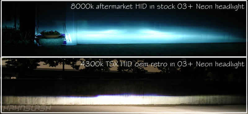

Also, the bit about aftermarket HIDs being illegal. Technically, yes, they are, but that was deemed as such because people kept thinking HIDs are plug and play, and just slapped them into their OEM reflector headlights. This causes massive amounts of glare, and poses dangers to other drivers. I have a TSX retrofit in my headlights, and have not had any issues with law enforcement because my headlights have a proper cutoff.
case in point, refer to the image I found by searching google
Top shows a massive amount of scattered light that would invariably shine into other drivers' eyes. The bottom shows a proper retrofit with a fantastically sharp cutoff.
Back to OP about the iridescence of the civic in question's headlights, very, very likely due to a wax/finish that the owner applied to the headlights, coupled with the lighting conditions.
