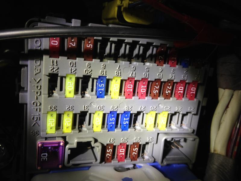

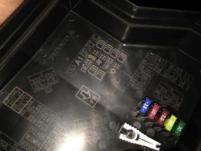

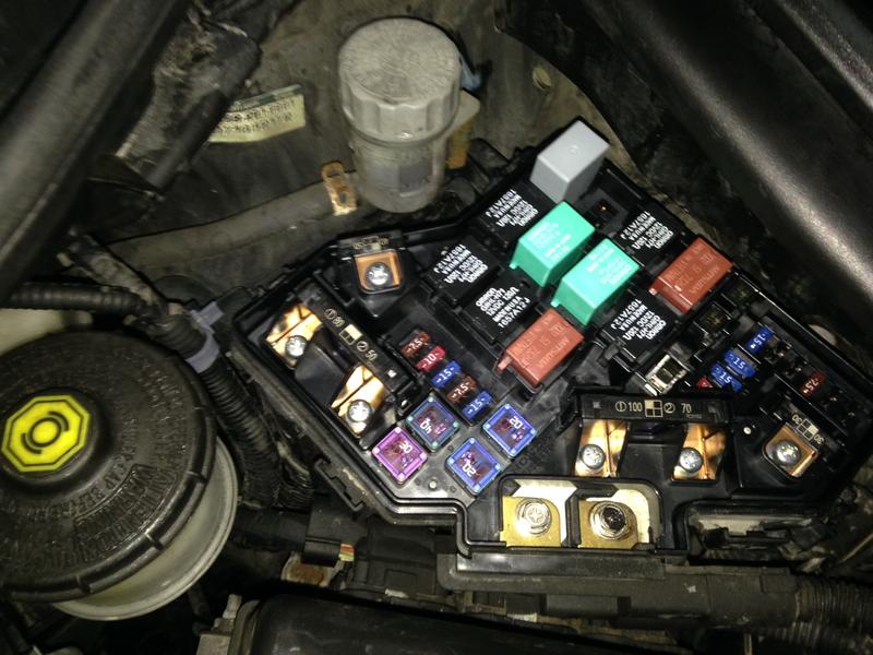

I just bought an Electrical continuity tester and checked all the fuses under the hood and inside the car.
Here's my finding so far along with some pictures of the fuse boxs:
Fuses under the hood: all fuses worked except the Oil level number 15 fuse which I replaced with a new fuse and still wouldn't get any power from it.
Fuses inside the car: Only fuses number 18, 21, 25, 28, 29 worked and I was getting the red power light in my tester. The rest of the fuses didn't work. I'd say roughly 5 fuses that worked and about 15 didn't work.
Is this normal?
I also disconnected the battery and shorted the negative and positive cables for 10 mins and tried to turn on the car and the problem still exist as the car would turn on for 2 seconds and then die.
Any other suggestions? Thanks

Old Dec 23, 2014
Re: The car starts and then shuts off in 2 seconds
Can you explain more about this? Is it a test light? A buzzer?
Only fuses number
Did you have the ignition key on when you checked the fuses? The key needs to be on in order to power up many different circuits.

Old Dec 23, 2014
a test light
Ok
oops I tested them without the key in the ignition!!
I figured that's why you found so few with power.
You're touching the light to each of the exposed pins (2) on each fuse, right?
And....the fuses for the headlights won't show power unless the headights are on.

The car is fixed!!!!
I checked the fuses with the key in ignition and most of the ones that weren't working before started working. The only one that didn't work was number 10 and it looked blown out when I removed it. As soon as I replaced fuse number 10 the cluster display lights came back on and I had a feeling if I start the car it would work and just as I thought the car started and stayed on this time!!
The fuses from 12 to 17 didn't work and I was going to ask why before I read your comment. I checked the fuse map and 12 to 17 are for the headlight and the lights were off when I checked the fuse. I'm pretty sure they work as I just drove the car for half hour at night time.
Everything is working fine except that I have a check engine light on now. I'm thinking that's probably because of disconnecting the battery, removing the fuses and shorting the negative positive battery terminals many times.
I just ordered an auto diagnostic tool on Ebay which hopefully will erase the code.
