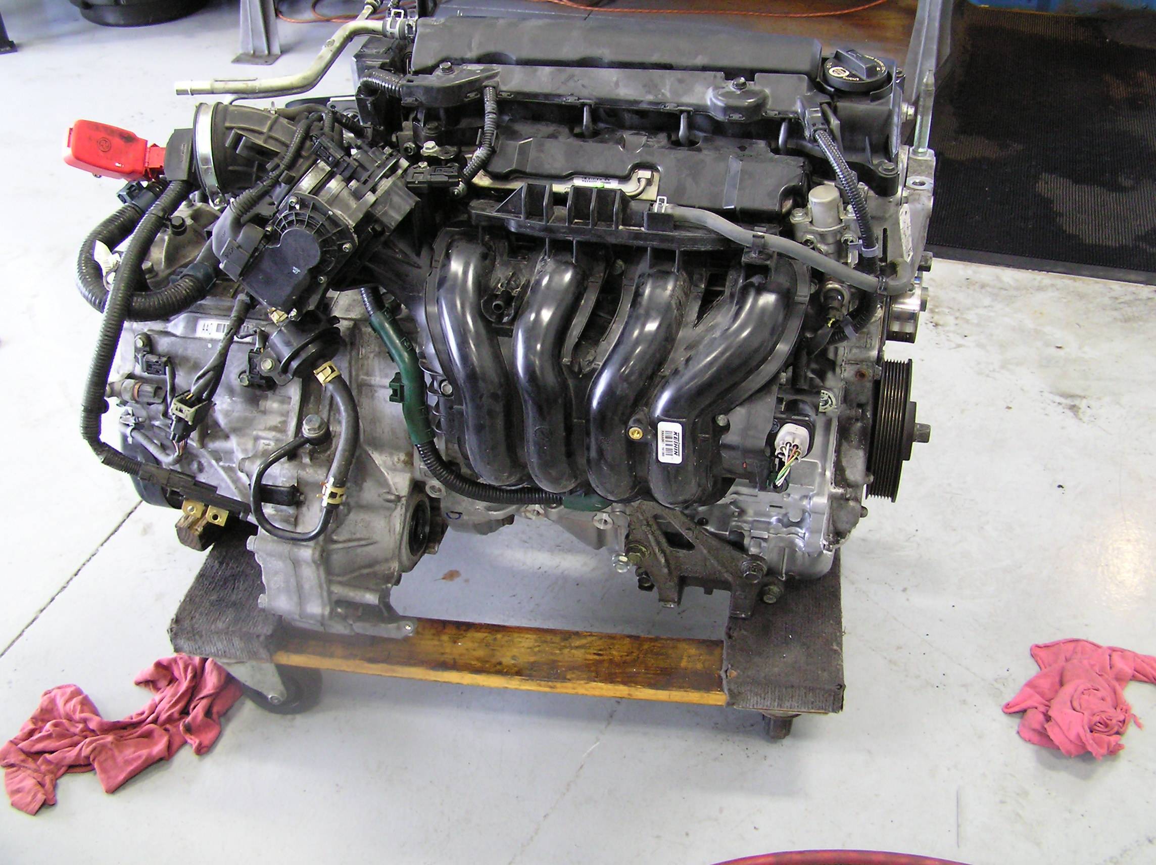

Filter is not necessary unless you really want to change it (we don't). There is an inline filter on the back of the trans, it's a kinda a ***** to get to.
The other filter is inside the trans, it is only serviced during a rebuild.
Pic of the inline filter:
Drainplug washer, I don't replace it until about the 3rd time the fluid gets changed. You can change it if you want, dealer should have the right one on the first try.
